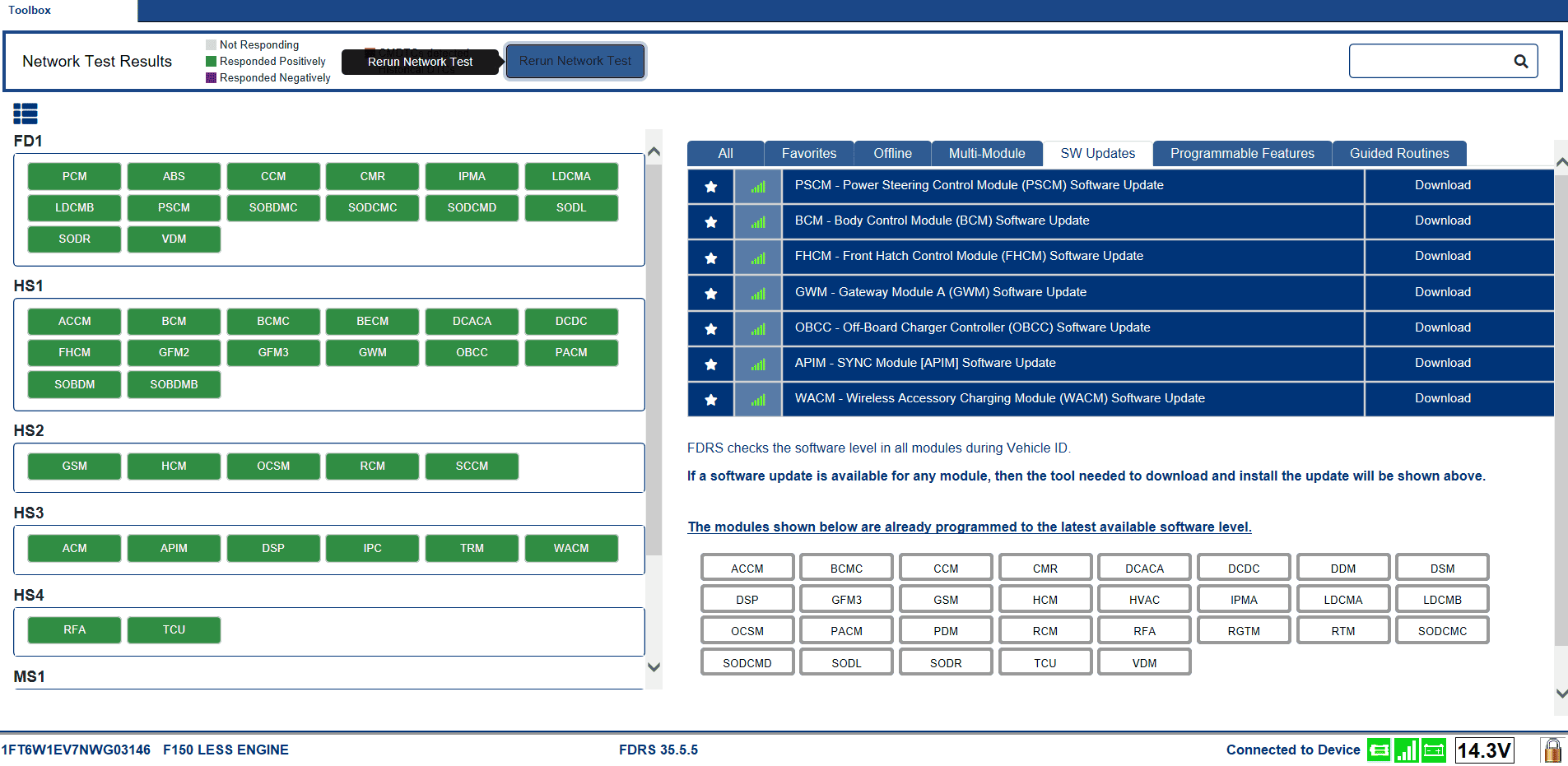

There was an OTA that should have knocked out some of those items in your list. It was PU-22-10-MIL-DTE.
None of those items listed above are part of the 4.x.x series.
The Mach-E community has been dealing with an issue from around the holidays where a PCM update was/is causing a dependency issue wherein until the PCM (and resultant associated powertrain modules) get updated, the newer GWM, APIM, TCU sequence of updates don't show up.
That could be what's happening here.
I've had positive feedback from at least two MME owners with 22s that said that once the tech did the PCM updates they then immediately got the gateway and APIM stuff showing up as available.

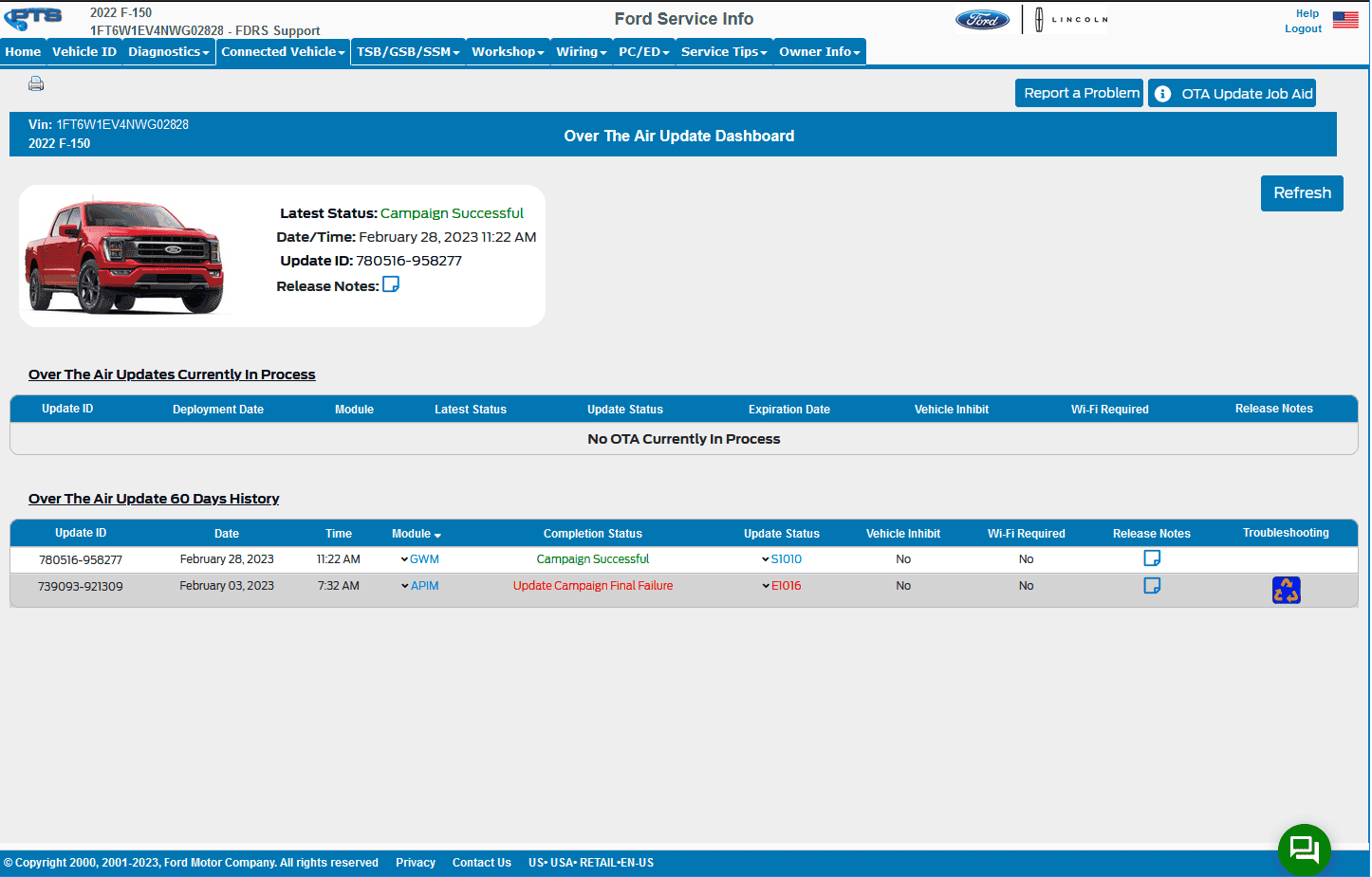

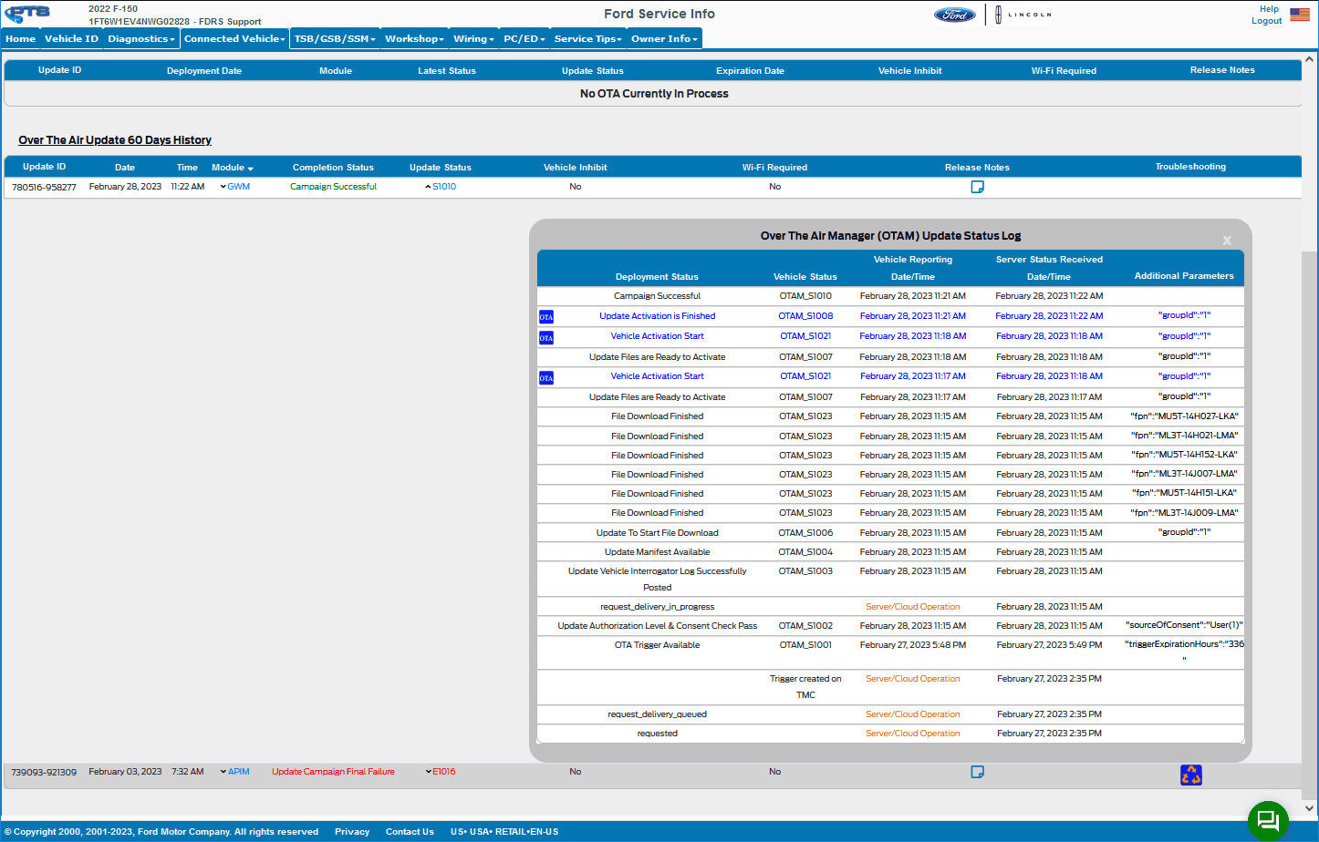

Okay, sorry.
If you call your dealership service advisor and ask them to pull up your VIN in the PTS system (Ford's service advisory and tech support system) and then ask them to check your "OTA Dashboard" for any details they might have on the status of OTAs going back 60 days.
Here's what that looks like on their desktop:
Ford F-150 Lightning Anyone with Error? OTA’s not coming - Ford’s answer OTA_Dashboard
They can select the "Update Status" for each item to see the progress or lack thereof for any of the listed OTAs. You'll notice that the module the OTA affects is listed as well, and if the "Release Notes" are selected it will show the same notes that are displayed on your Sync screen.
Ford F-150 Lightning Anyone with Error? OTA’s not coming - Ford’s answer OTA_Dashboard_Item_Expand
So your service advisor should be able to tell you what they see. And if they don't know why you're not getting OTAs...well then that's a warranty problem that needs to be diagnosed and corrected.

Ford F-150 Lightning Anyone with Error? OTA’s not coming - Ford’s answer Screenshot 2023-04-19 101514
Mike G
Jan 6, 2022
1,797
2,625
N. AL, USA
@Mike G
i updated PCM and it’s dependicies.
I did not update APIM, seeing if it would start sending the sync updates.
i have 42 hours left on license.
any suggestion?
thanks
Well I would certainly have updated the GWM and then the APIM showing there in your list.
