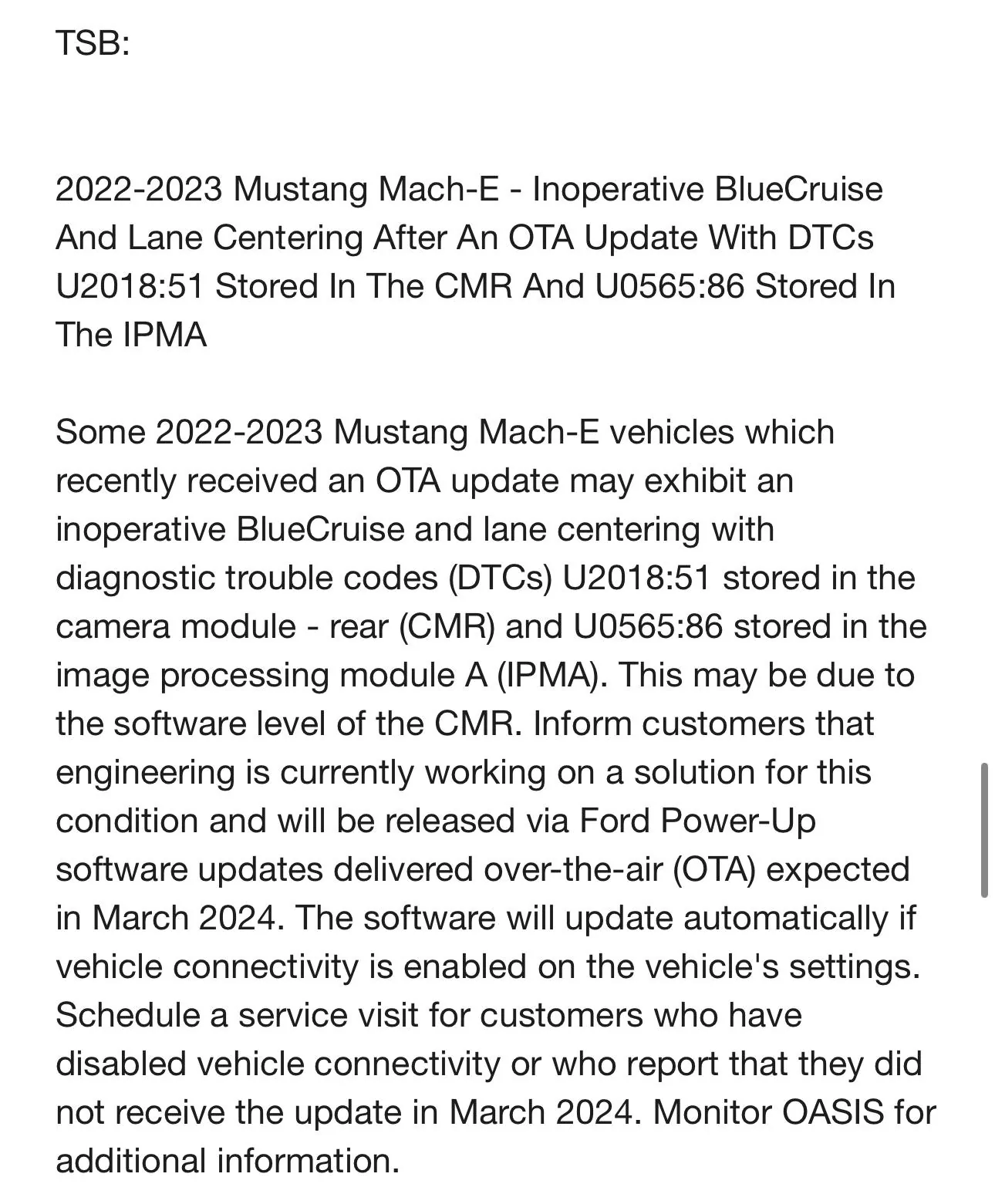

Blue cruise Not working since SW 6.13 update

So looks like the Mach-E’s have a TSB on this issue. We won’t be getting an update until March if we are lucky….. Man WTF @Ford Motor Company and why doesn’t this TSB include Lightnings?
This is my concern as well. All of the communication coming from Ford about this issue only mentions the Mach-E. It would be nice if they at least made an official acknowledgment that they are aware of and working on a fix for the same problem affecting our Lightnings.
