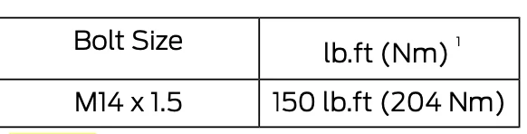

I'm skeptical that undertorqued nuts are causing that noise. I don't really have a good idea what it is though.
Have you tried swapping front tires? Maybe check for loose brake components while the wheels are off.
I took the wheel off. It seems like perhaps the wheel was walking around the hub. I retorqued, again, and the noise has gone away. Everything seems fine with the brake, boots and CV joint.
