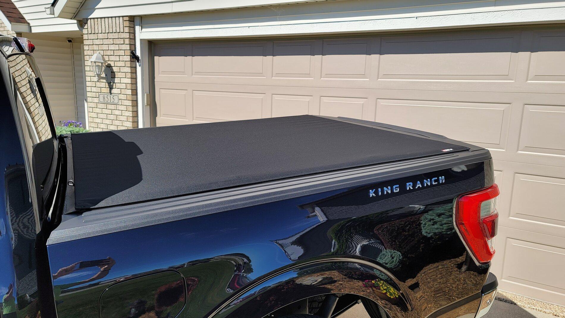

I have done this to my last three trucks.
Don't get a hair dryer or heat gun closer than 6"-8" from the paint for more than a second or two. I recommend the natural method described by many, set your truck in the sun and then use your fingernail to start peeling and then apply constant pressure as you pull along the truck (180 degrees. WD40, Goo Gone, etc. will all take off any residue.
Arrived at Dealer
Ford F-150 Lightning Coaching on removing decals, please... 2021 Ford F150 Delivered 3
10 Days Later
Ford F-150 Lightning Coaching on removing decals, please... 2021 F150 Truxedo X15 Pro Drivers 1 - 21_05 29

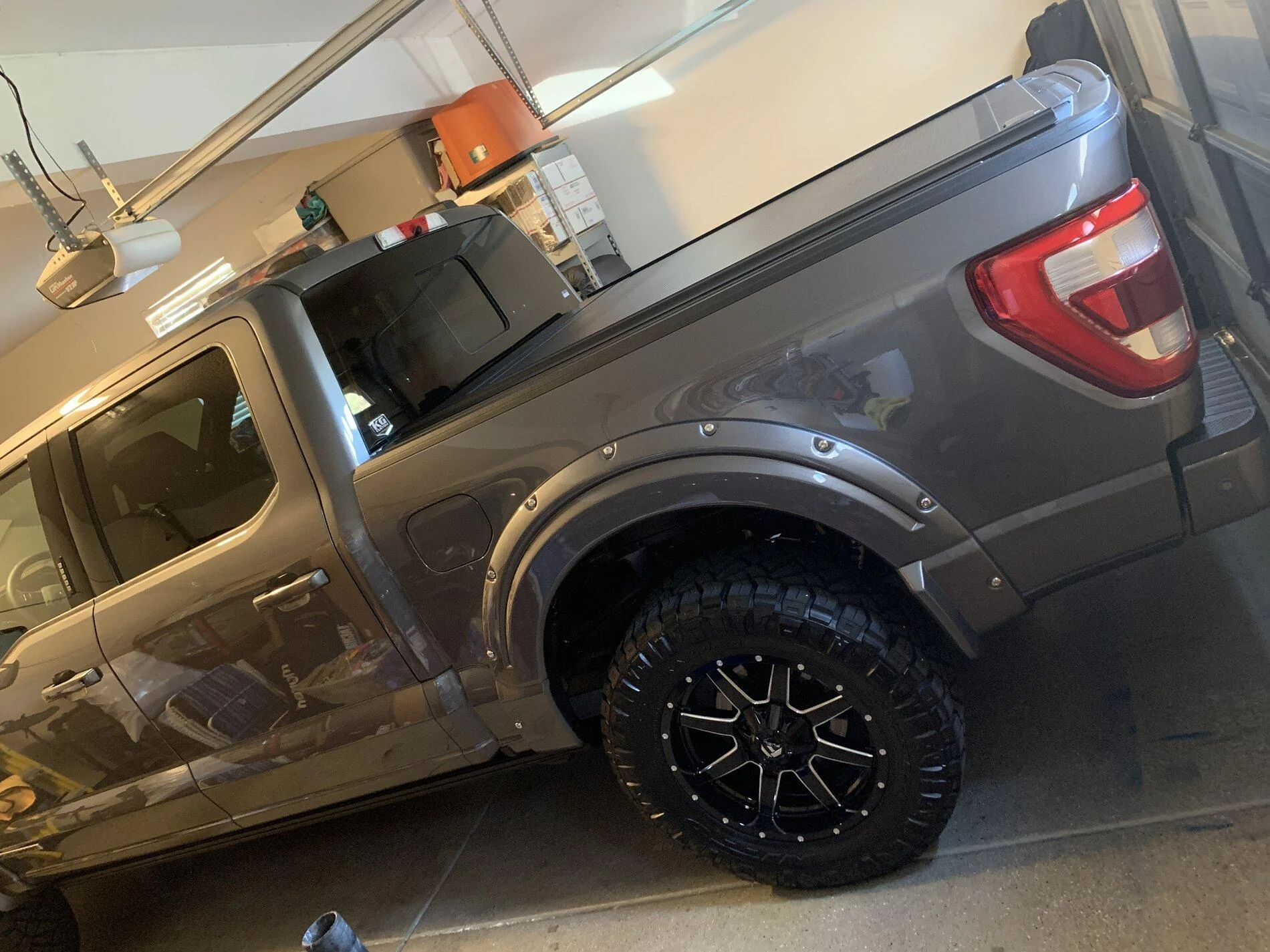

I have the same color Lariat Powerboost with the same sticker. Used my heat gun and peeled it off. Had 3M Adhesive remover ready but literally didn't leave anything behind. Came off simply.
