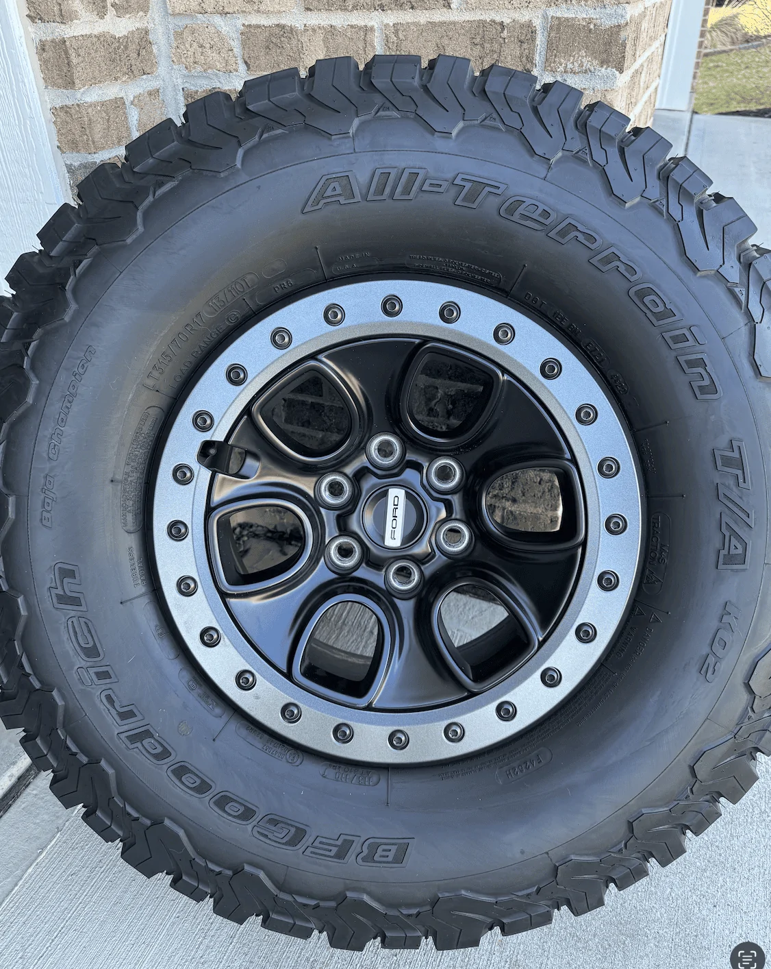

Step 1: Buy "Raptor Take Offs"
I had success with this on Facebook Marketplace. The wheels that were available happened to be 17 inch Raptor wheels with 35 inch tires (BF Goodrich All Terrains LT315/70R17). I paid $1800 (a total steal, I learned, compared to what you'll pay at TireRack for new wheels and tires. I know this because at one point, after giving up on the Raptor Takeoffs I bought the cheapest wheels and 35 inch tires I could find from Tire Rack that were off-road oriented and it was $2400 ?).

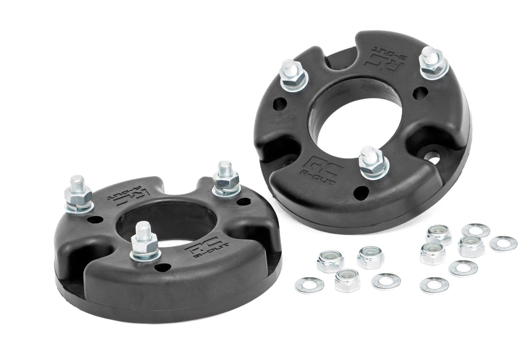

Step 2: You need at least a 2 inch Level kit installed on your Lightning. The 2 inch level kit I chose is less than $100 (link below). It was one of the few parts that declared on the website that it is indeed compatible with the F150 Lightning. Depending on how savvy you are in your garage, you may be able to install this yourself, but I went to a local shop. The shop charged me ~$450 to level the truck and perform an alignment, however they told me the wheels and tires still wouldn't fit over the Lightning brake calipers even after the 2 inch level (first speedbump but stay with me).

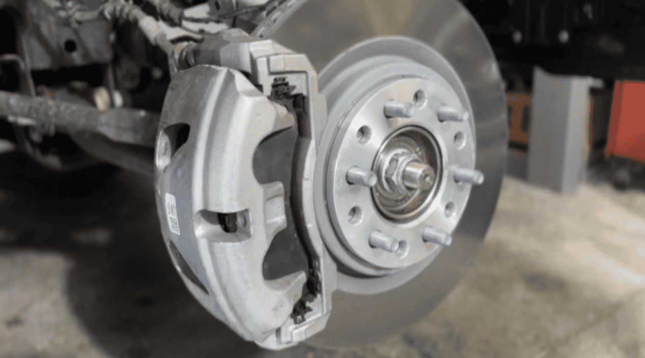

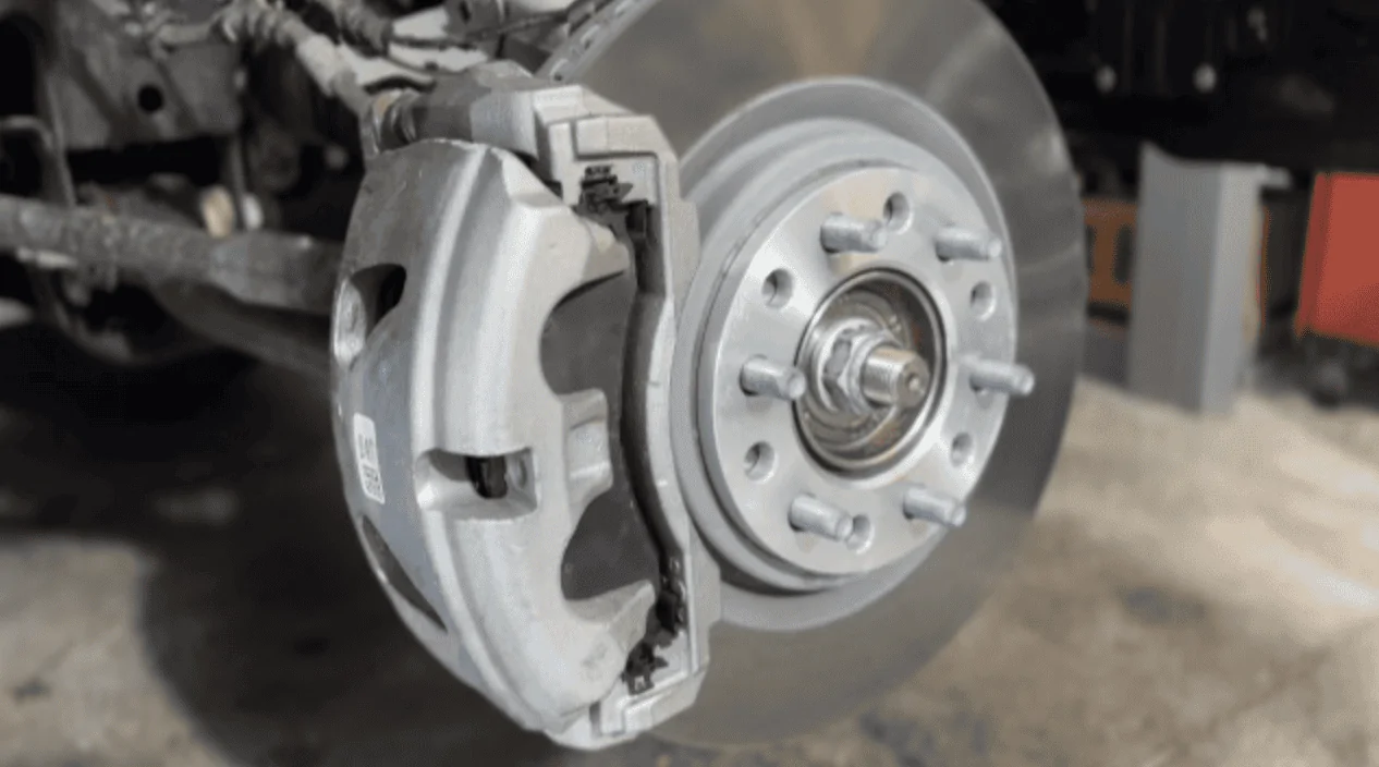

Step 3: You need 12 mm spacers. This may sound like an intimidating dealbreaker, however it turns out it totally isn't. These go between your Raptor wheel and the wheel hub, and this is what resolves the "wheel won't fit over the brake calipers" problem. It's tight, but it works. 12mm is only 0.5 inches, meaning this will only make your truck 1 inch wider (not a comical amount of poke). The spacers, like the Level kit, is affordable. I got mine off of Amazon for less than $100 (link below).

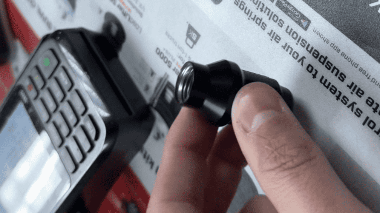

Step 4: You need EXTENDED THREAD LUG NUTS that will fit the Lightning (14x1.5). The reason being after you put the spacer and the wheel on, the amount of remaining thread available is flirting with potentially being unsafe. Some sources say you should thread at least the diameter of the Bolt (F150 lightning bolt diameter is 14mm), and other sources say you need a specific amount of TURNS to be safe (source recommended 9.5 turns, I was only able to execute 7 turns with the stock lug). For peace of mind, I purchased these extended thread lug nuts (and they're black ?)These were about $50.

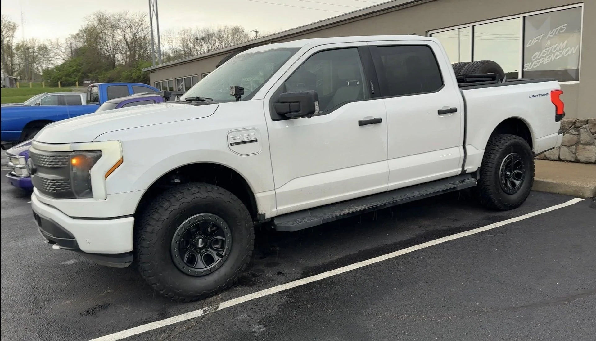

You mentioned the poke, would you mind posting a pic at an angle that shows how much poke is produced?

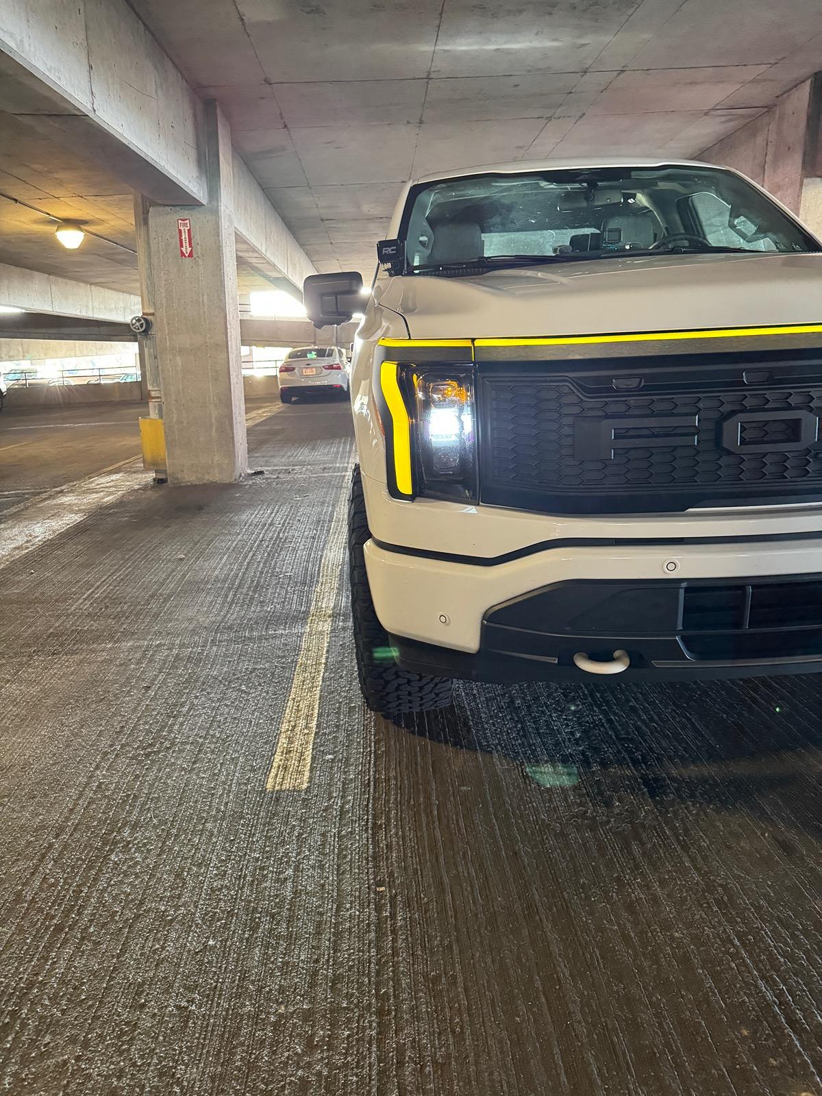

Whoa, what's going on with your Lightbar? How did you do it?

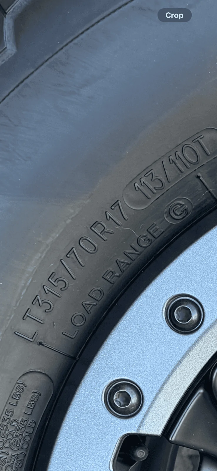

I cant really tell from the pictures, but I'm guessing you left the KO2 315/70's on the wheels that you mounted or did you go with a new tire/size?

I took the exact raptor tires that ford mounts from the factory. Which does appear to be a 315/70 !
Part of all the upgrades! Never liked the full white one so a local vinyl wrap shop did it for me. I wanted amber wrap to emulate Raptor and then we used black wrap to give it a sleeker silhouette. It’s not perfect and I can tell that after a while I’ll go back and have them do something different (still with amber tho) but I like it as an eye grabber for now ?
