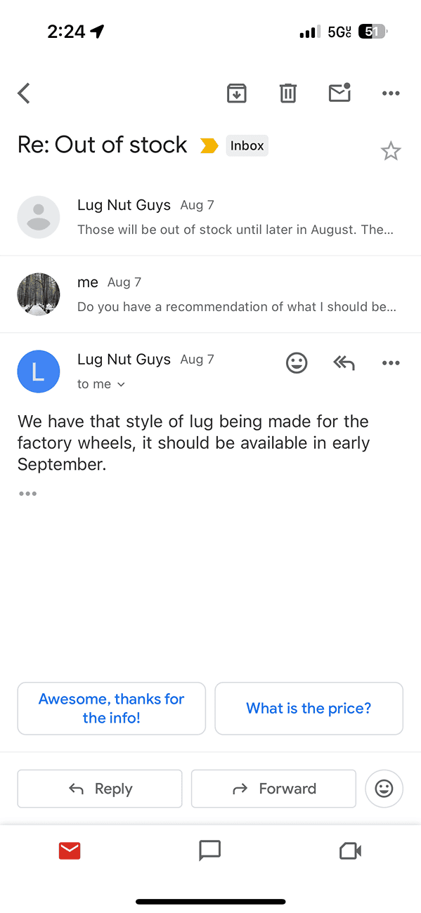

Step 4: You need EXTENDED THREAD LUG NUTS that will fit the Lightning (14x1.5). The reason being after you put the spacer and the wheel on, the amount of remaining thread available is flirting with potentially being unsafe. Some sources say you should thread at least the diameter of the Bolt (F150 lightning bolt diameter is 14mm), and other sources say you need a specific amount of TURNS to be safe (source recommended 9.5 turns, I was only able to execute 7 turns with the stock lug). For peace of mind, I purchased these extended thread lug nuts (and they're black ?)These were about $50.
https://lugnutguys.com/collections/lug-nuts-et/products/et-style-bulge-acorn-lug-nut-14x1-5-black

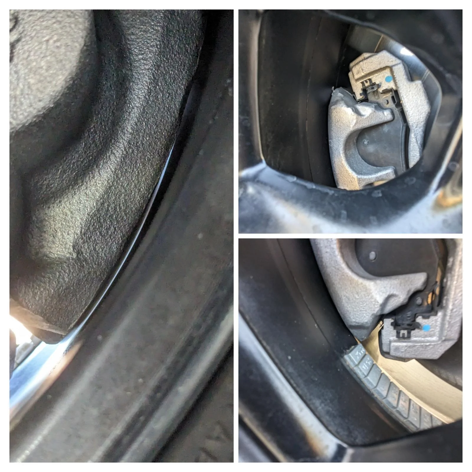

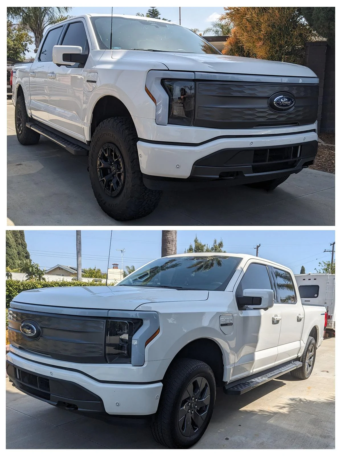

I grabbed a set of Raptor R wheels with the 37s on them. I had to mock it up because I was just too dang excited.
Rears bolt up no issues (unless I overlooked something).
Fronts have full interference with the caliper. But they appear to clear the fender at full lock by a blonde one.
Ordering spacers and wheel nuts, will report back.
Lift is the Eibach pro kit at 3" front, stock height rear.
Are you saying the 37s can clear the crash bar and wheel liners up front?!? What are the dimensions of those wheels. I am guessing that +44 offset must really help out. My 35s rub a little bit with +12 offset 17 inch wheels
