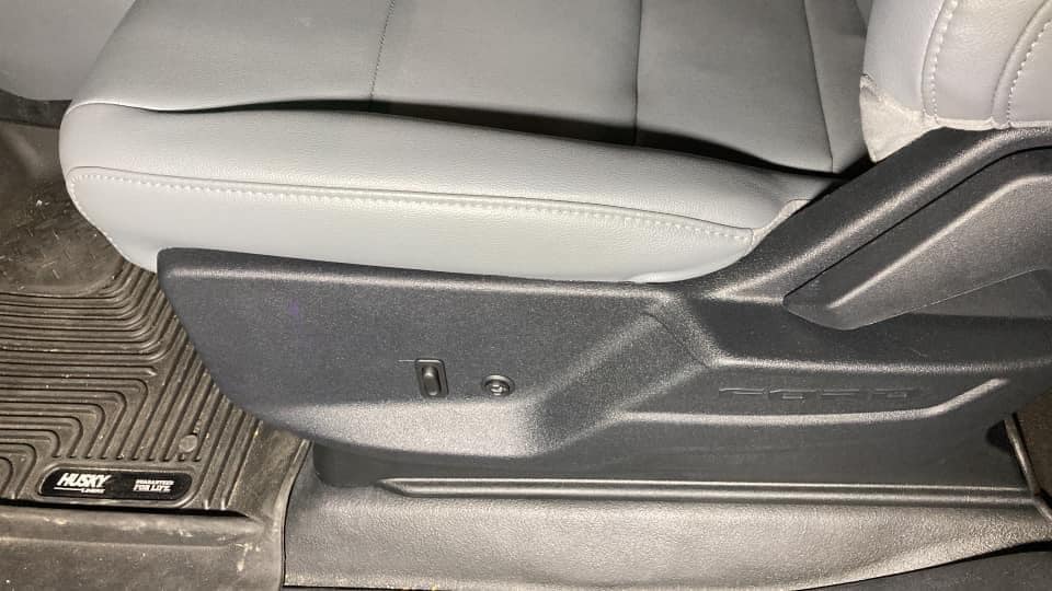

I installed the Rostra seat heaters and lumbar support into the Pro.
https://www.summitracing.com/parts/rpc-250-1900
https://www.amazon.com/dp/B00D4BNC8E
Used open fuse slot #37 for ignition-on power, and ran the wires under the flooring.
The trickiest part for me was disconnecting the seat cover clips without damaging them or ripping them from the foam. Once released, a priceless tip was to slit (on each end) about 1.5" of the felt that connects the support rod to the seat cover, so that the rod can still be secured into the clips and at the same time fit under the heating element edges (which cannot be cut).
The lumbar support went in behind the foam, zip tied against the springs. It was initially positioned 1-2" too high because the seat foam has a lip at the bottom that held it up. After talking to a Rostra rep, I ended up lowering it by trimming off some of the hard plastic backer sheet. I also had to smooth the cut edge and cover a couple spring ends so they won't slice the bladder that now overhangs a bit.

Did you ever try to add the heated steering wheel? I've run the wires and done the install, but can't get the heat to come on
Not yet... been a lot busier lately than I expected.
