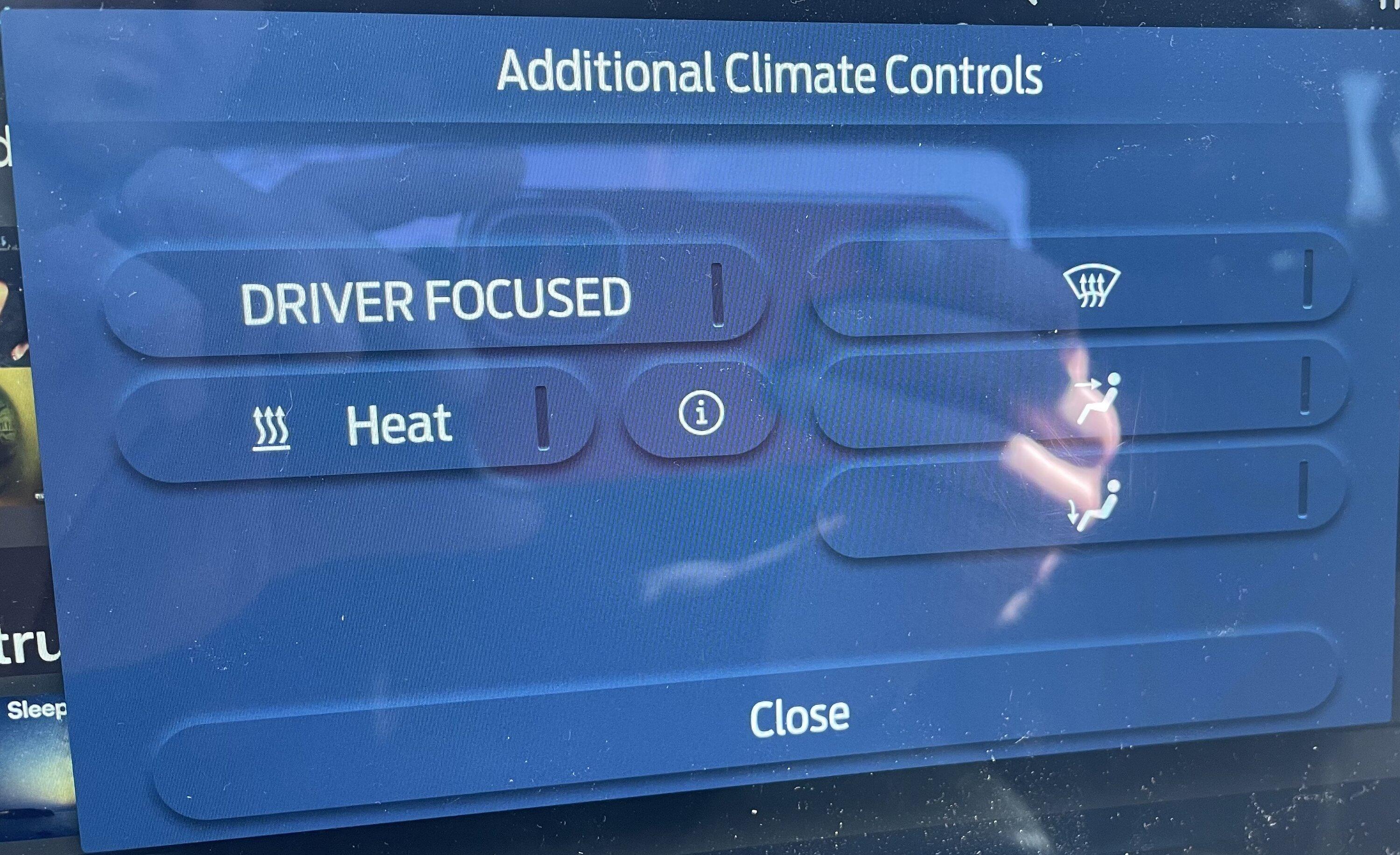

Just wanted to clarify here too, you can have HSW on a pro with control via the 12" display without needing a new HVAC module but bear in mind it impacts the appearance of your menu/UI
source: I have HC seats, and HSW running off of stock pro HVAC controlled via synch UI
You can have it without changing the UI also, mine just comes on automatically (so I can't manually turn it on or off, but it hasn't been an issue so far).

interesting, mine i have set so it can come on with remote start/precondition based on outside temp. but i still have full control to turn it on or off via the synch screen.
and yes you are forced into the UI change but you get used to it. I have seen some reports of a guy getting a ICE module to work but haven't confirmed the part no he used, but im honestly fine enough with onscreen and no extra cost i already fought with the older HVAC module with the little lcd displays unsuccessfully
