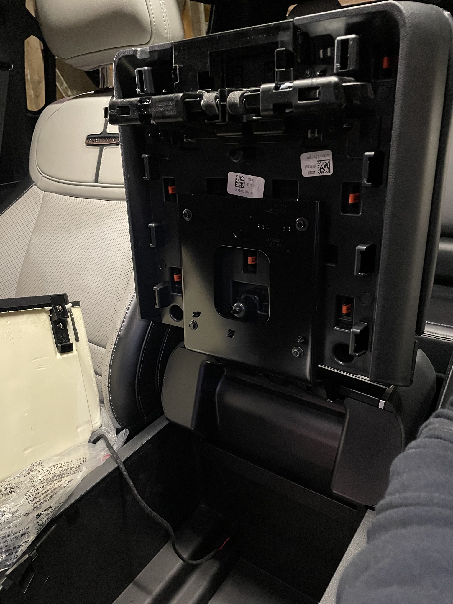

First thing was removing the top 7mm screw in the console cupholder, then popping the rear facia off.

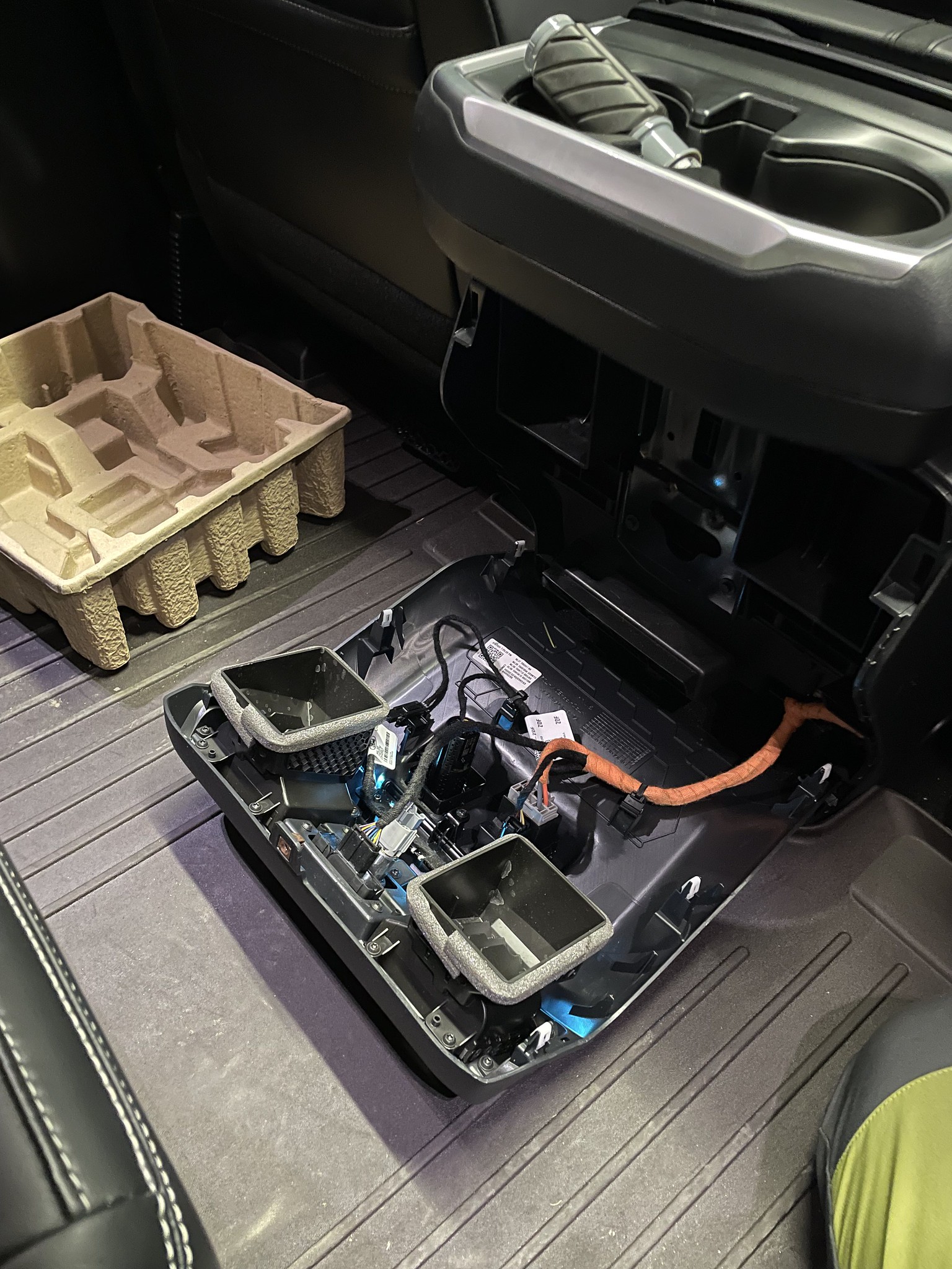

The next step was removing the 12v power connector. This is why I HATE wrenching on new cars. I spent more than 45 minutes trying to get this POS off, and busted it in the process. Looked up a YouTube video where the guy just pops it off with his fingers like it was nothing! Had me steaming. Every time I wrench on some new car, 2/3 of the time is spent fiddeling with these POS connectors. FFS! /Rant

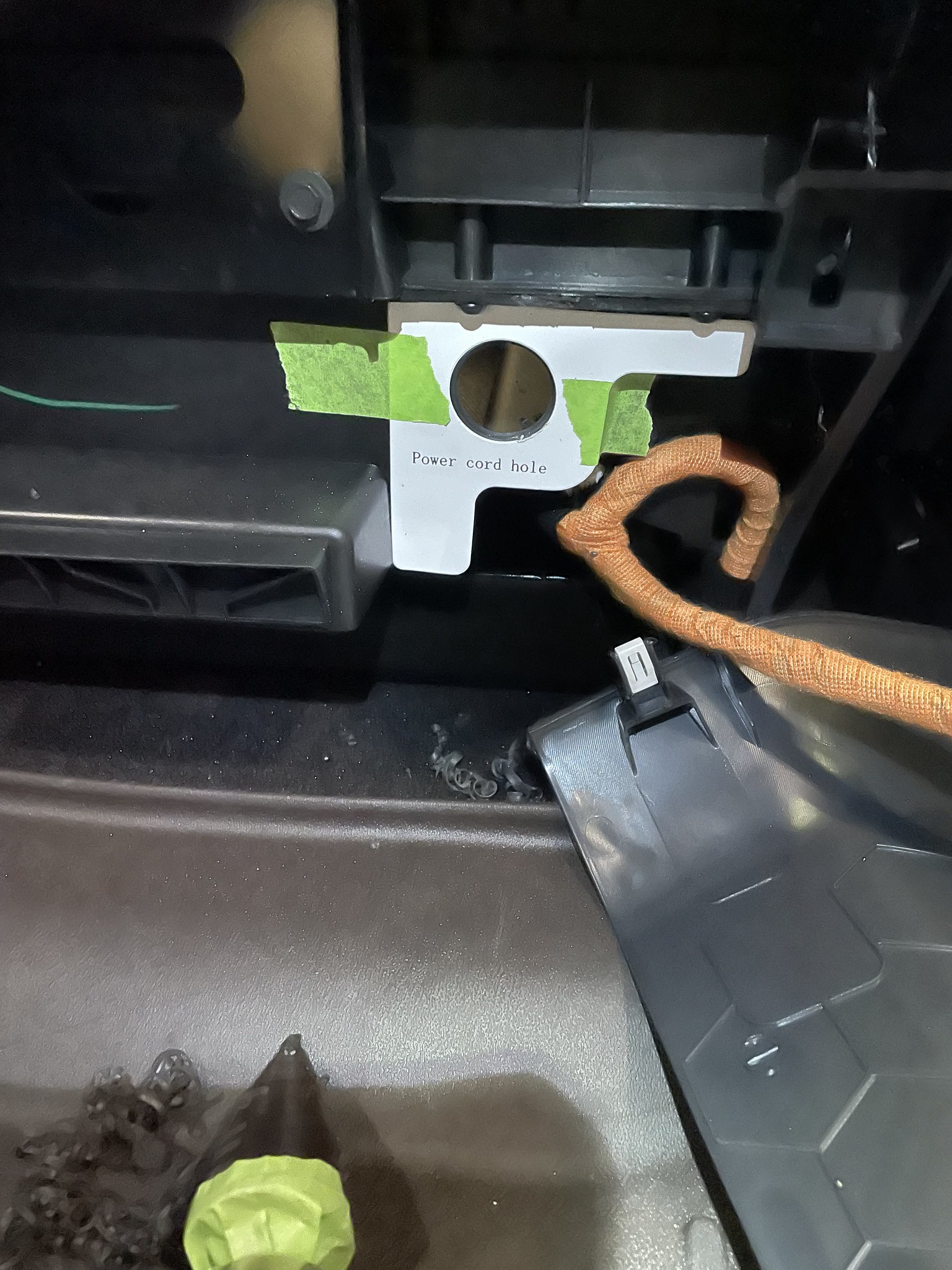

I drilled the hole for the power cord with a step bit instead of a hole saw drill bit.
Ford F-150 Lightning Dometic CCF-T install 55199699474_a95e25174b_k

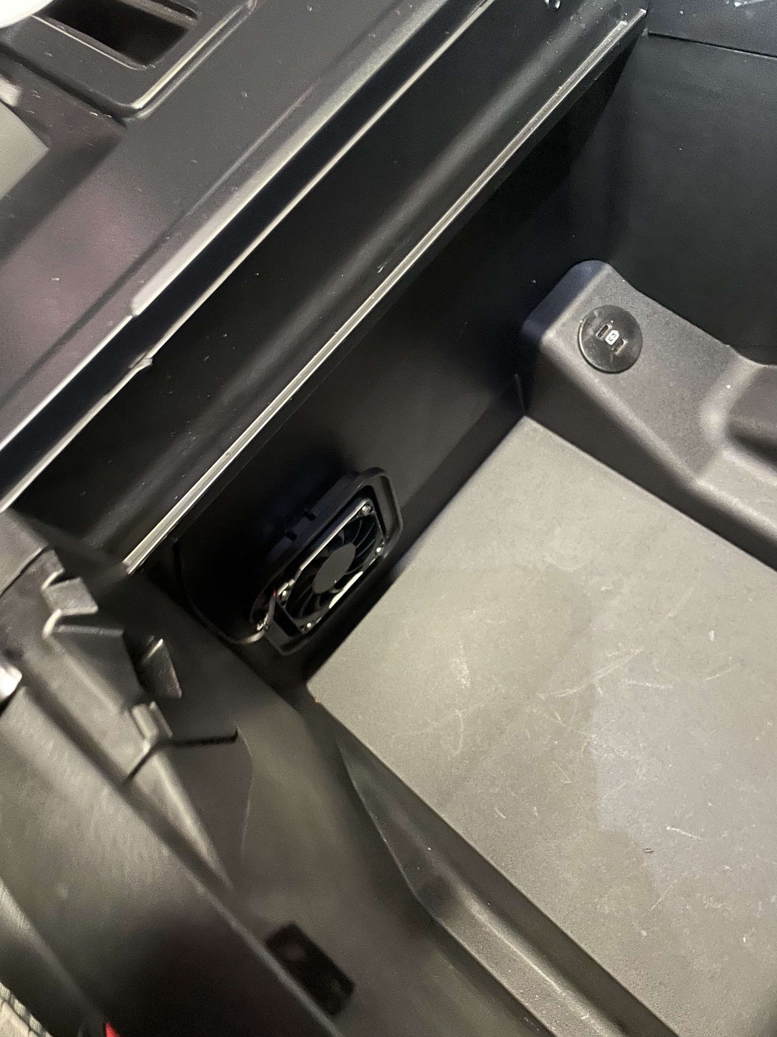

The hole for the fan I did use a hole saw drill bit.
Ford F-150 Lightning Dometic CCF-T install 55199699499_e88a973d91_k
And then installed the fan.
Ford F-150 Lightning Dometic CCF-T install 55199699484_b0ab075f0e_k

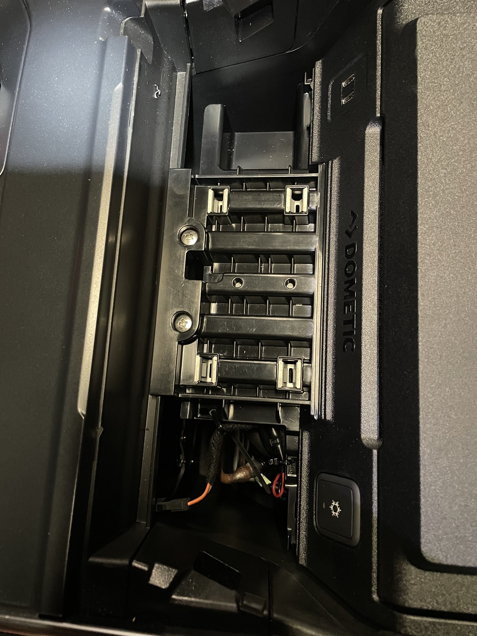

The bottom of the console lid had to come off to make room for the fridge to be installed.
Ford F-150 Lightning Dometic CCF-T install 55199713914_8f7196a30b_k

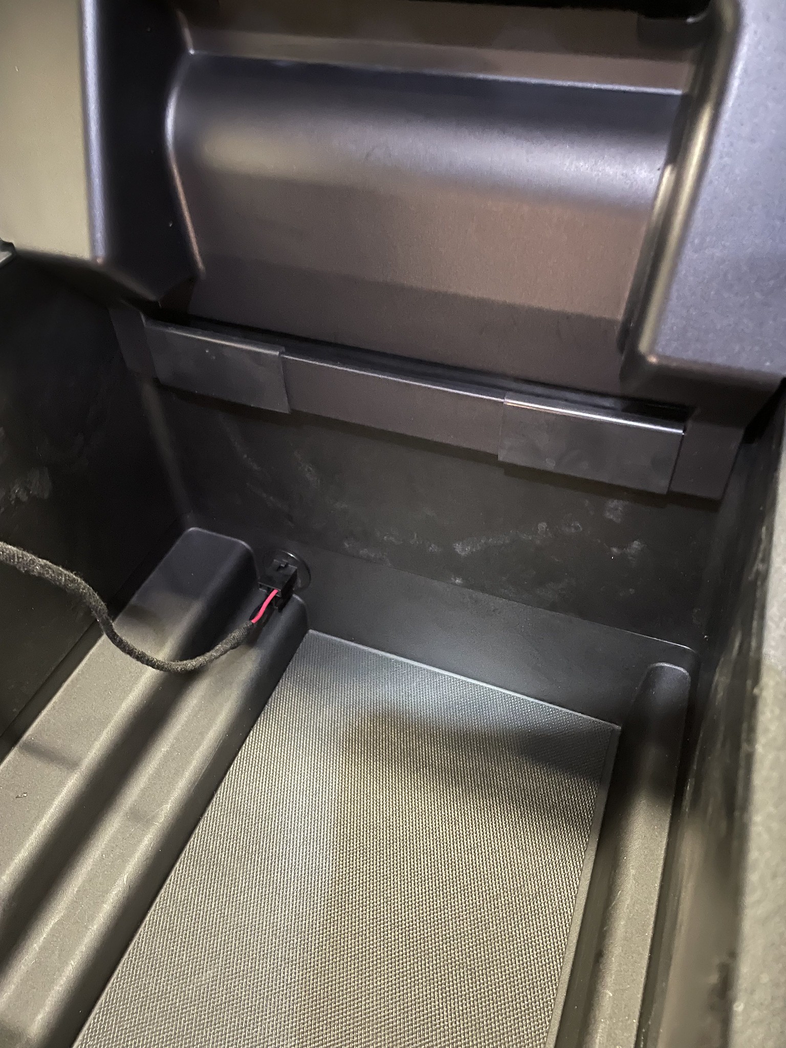

Then it the fridge was dropped in and snug down with the clamp screws.
Ford F-150 Lightning Dometic CCF-T install 55198624707_b9759018e0_k

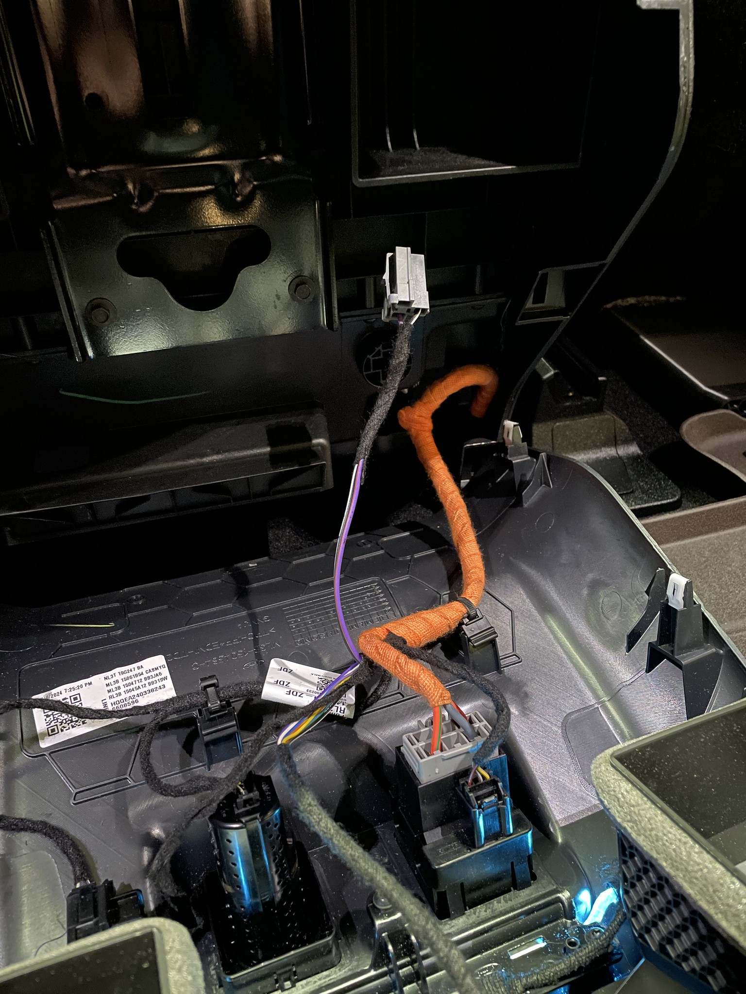

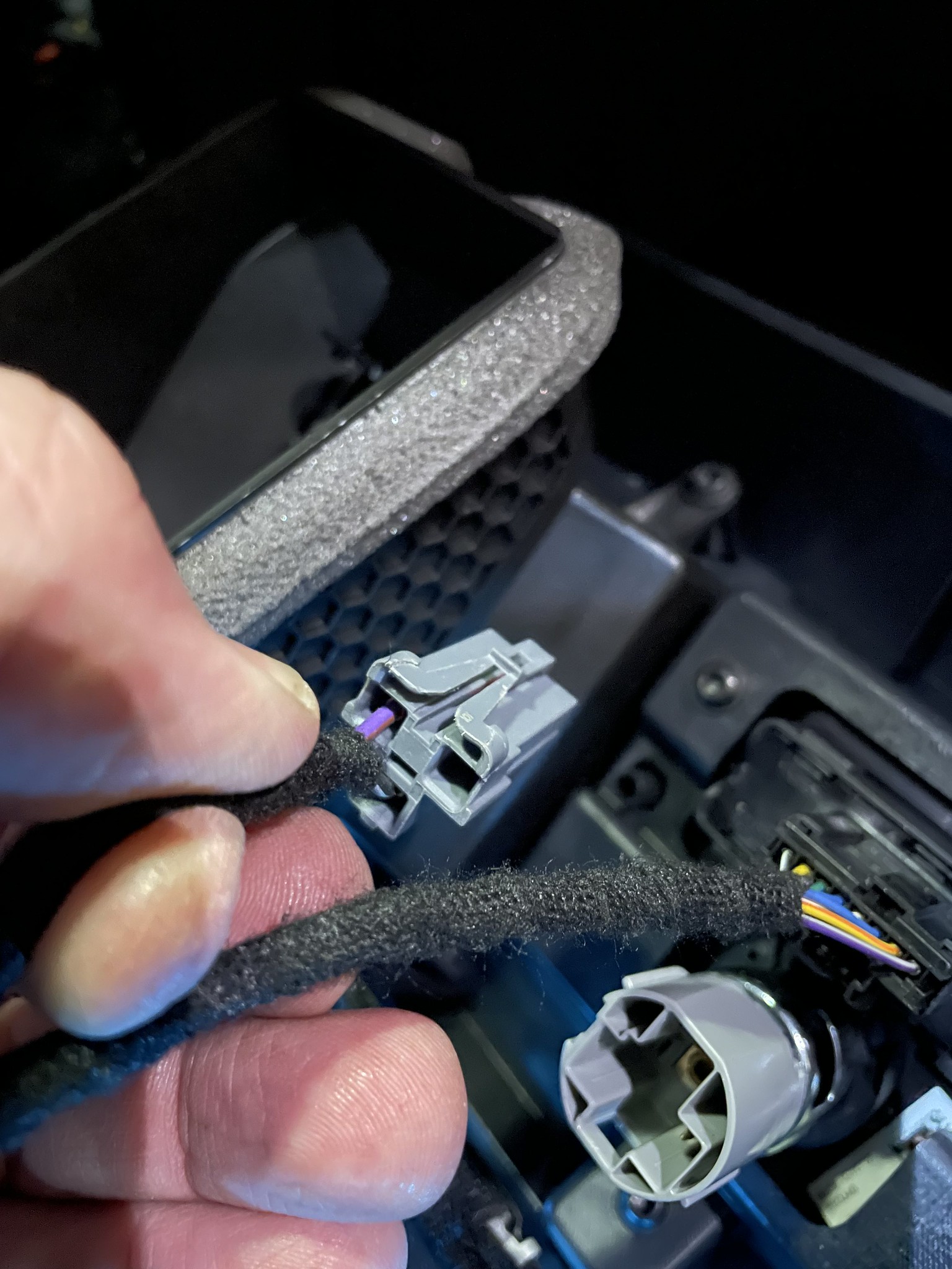

The rear wires was not done messing with me. There was no way the 12v power was gonna reach the fridge contact. So I had to cut open the tape to make it reach.
Ford F-150 Lightning Dometic CCF-T install 55199615443_3b1ba98c51_k

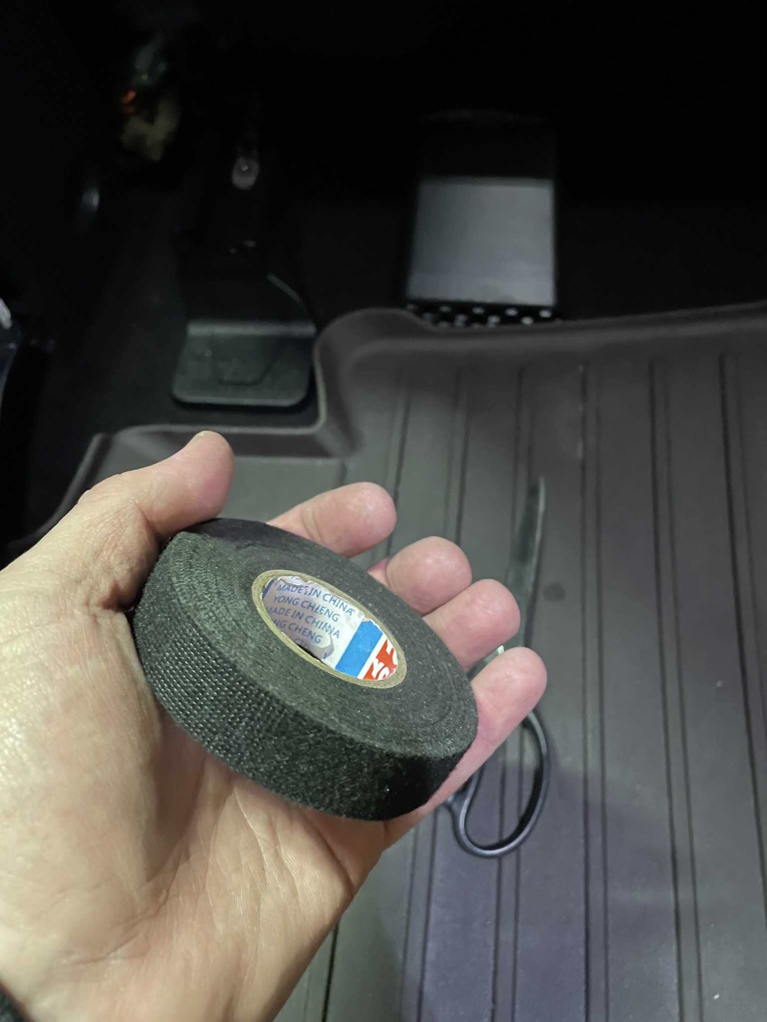

Luckily I had a roll of that tape type.
Ford F-150 Lightning Dometic CCF-T install 55199450666_7c497778b8_k
Got it all tape up and plugged in.
Ford F-150 Lightning Dometic CCF-T install 55199713929_ba2f9bceb2_k

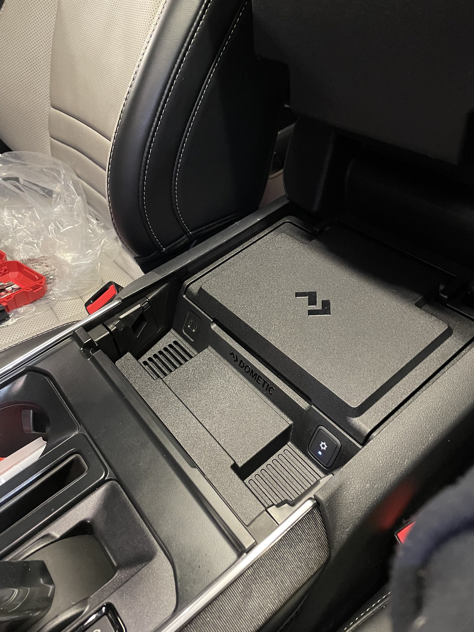

All done!

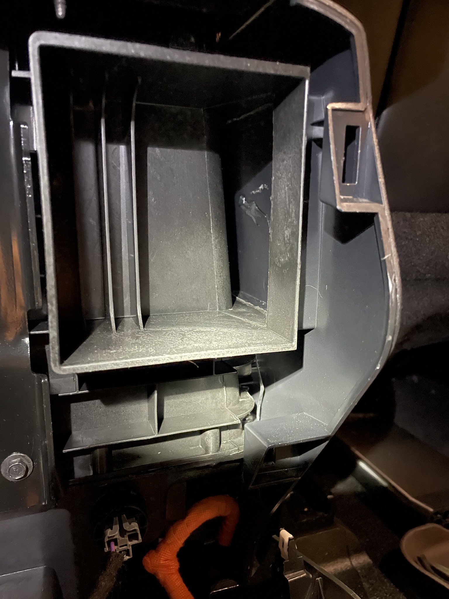

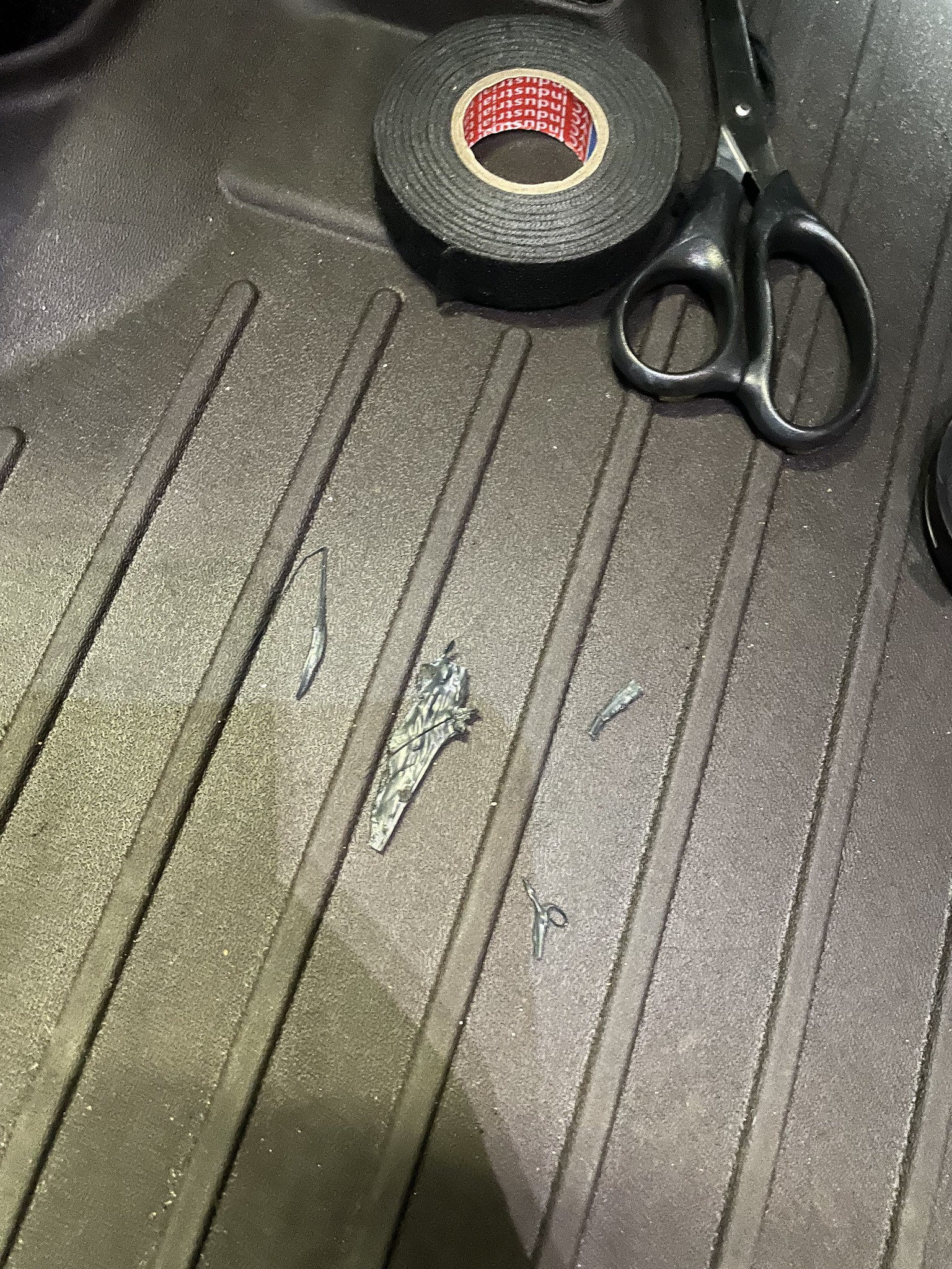

Also, I found these plastic pieces inside the air ducts for the rear console vents. Got them out. Something to look for if you're ever back there.
Ford F-150 Lightning Dometic CCF-T install 55199855945_49eac24ff2_k
This is where the plastic pieces were. There was some in the other vent too, but I didn't get all of it out.

I got to use the fridge on an all-day trip yesterday, and it was golden! A cool coke any time I wanted it, and it was really cold. Really happy with the upgrade.
