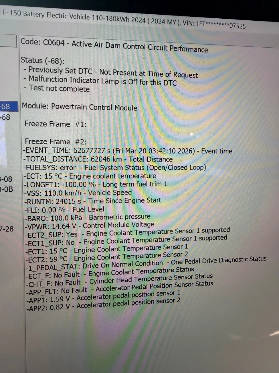

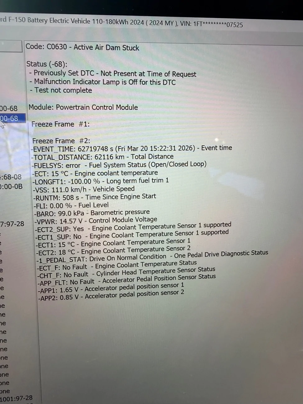

So today I decided to take a quick look and see if I had any active DTC codes on my 2024 Flash (nerding out in Forscan). I noticed 2 concerning codes (C0604&C0630) that triggered as recently as yesterday. Looks like I have an active air damn stuck and active air damn control circuit performance issue. I took a look at the active air damn and I can see it's in the open position sitting in my driveway, but nothing seems to be blocking it. Does anyone know of a fix? or is this a dealership visit? Thanks in advance -Rob
