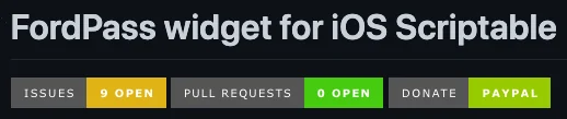

@tonesto7 ... I just want to say "THANK YOU!" for all your hard work on this.
To the rest of us who are reaping the rewards of his work... might I point out that there is a "Donate" button on the Github page for the project:
Ford F-150 Lightning FordPass - Scriptable Widget (iOS, iPad, MacOS) 1639631477888
We could at least send him enough to take his wife out for a second anniversary dinner!

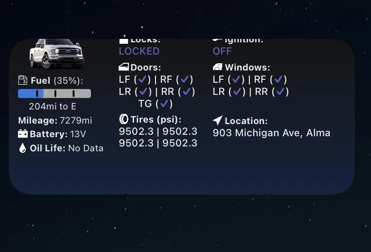

Few small things! Tested this on the IPad Pro 12.9” for fun, but in the Medium(?) sized widget, part of the text gets cut off, however the largest widget will show all info without anything being sliced off. Also, my TPMS sensors are not in this set of wheels and is disabled from alerting me on my screen and FordPass via forscan and the truck currently reads dashes (-) on all 4 corners however the widget is reporting a value still.

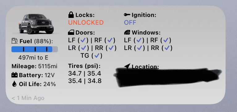

It's a glitch in the widget itself. I have the same iPad and it eventually lines up correctly.
Ford F-150 Lightning FordPass - Scriptable Widget (iOS, iPad, MacOS) 1639688883865
That's from my iPad Pro 12.9"
No need to use the large widget.
As far as the tire pressure I can only go on what fordpass API shows
