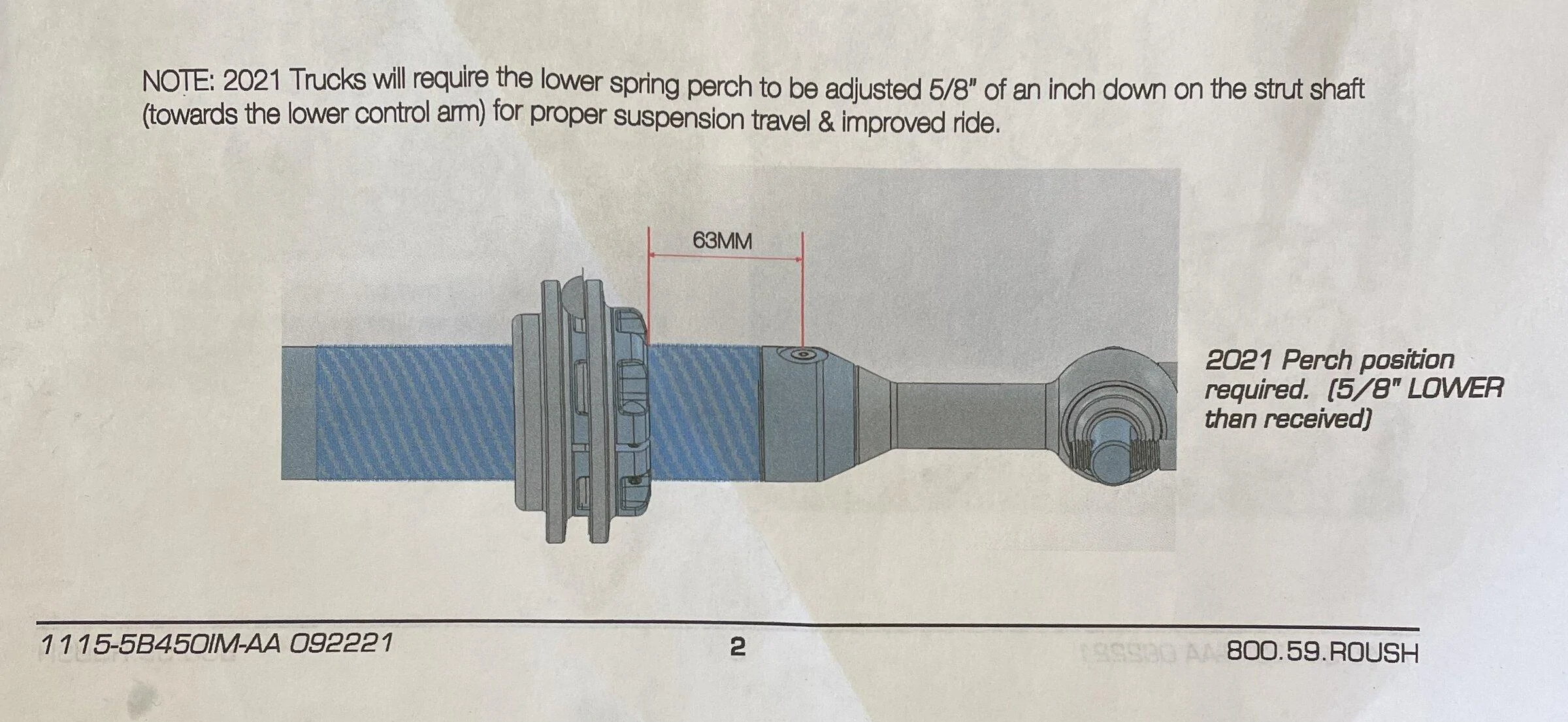

Can anyone help me understand what needs to be done differently on a 2021 to install fox coilovers? I've been told be several sources that they will not fit without modification, but I've seen several folks with them installed. So what needs to happen? I've seen that the lower perch needs to be adjusted. Is there anything else required as to why Fox will not come out and say it'll work on a 2021.

It’s complicated. If you ask FOX they say to wait for Gen14 shocks. Roush says use Gen13 shocks; but, lower the spring perches by 5/8”.
Ford changed the front motion ratio on the Gen14. So, I’m waiting.

From all I’ve read what you are saying is spot on. The Roush kit actually shows 2021. Is lowering the perch all that’s required for the other Fox systems? I don’t know. I don’t mind waiting. Hope we get news on something soon. I’d rather not get an ICON system.

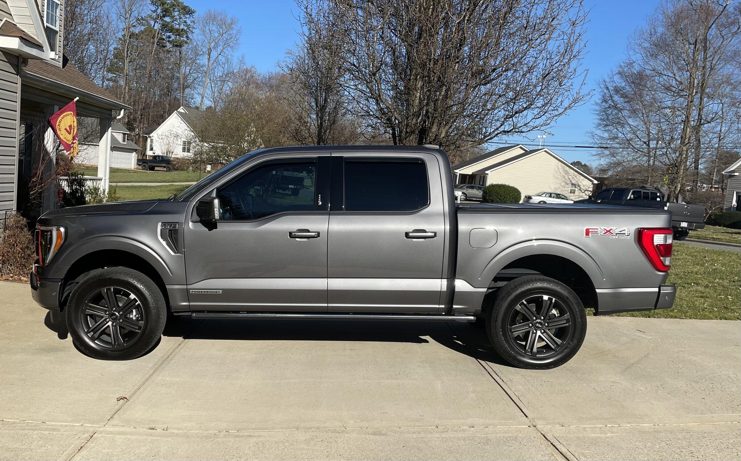

I installed the Fox 2.0 on my 2021 Powerboost yesterday. I did adjust the perch per Roush instructions and gained 2 1/8” of lift in the front. Ride quality is awesome; got rid of all the body roll.
