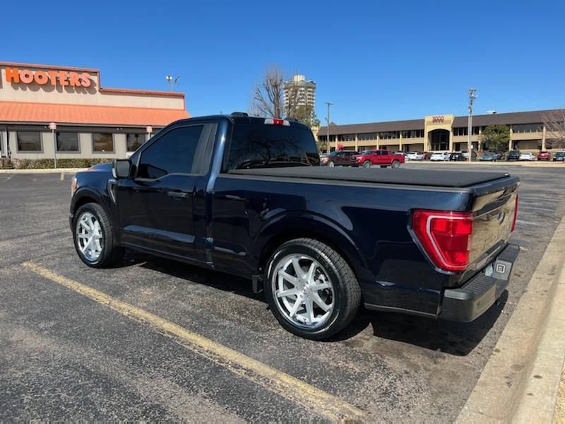

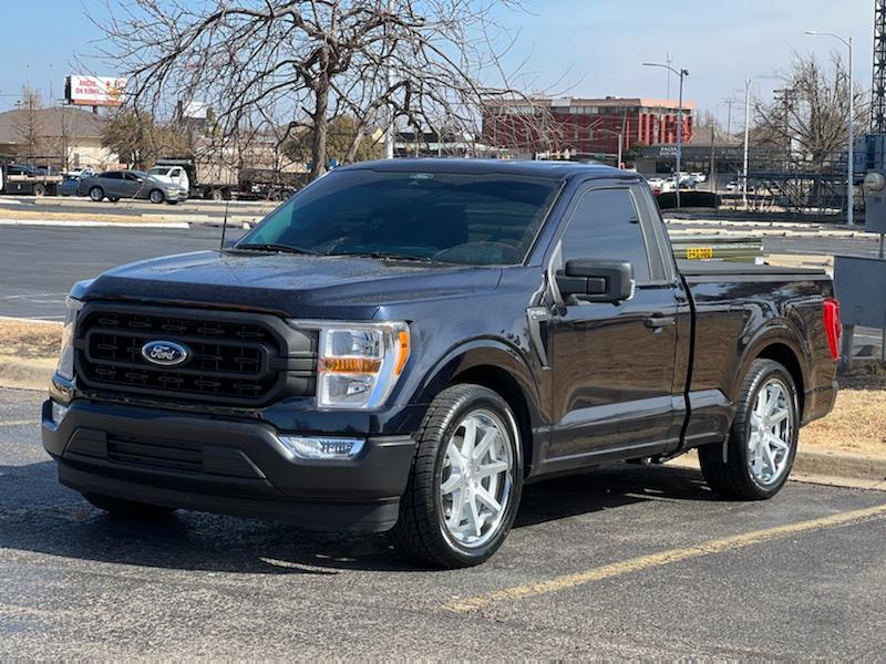

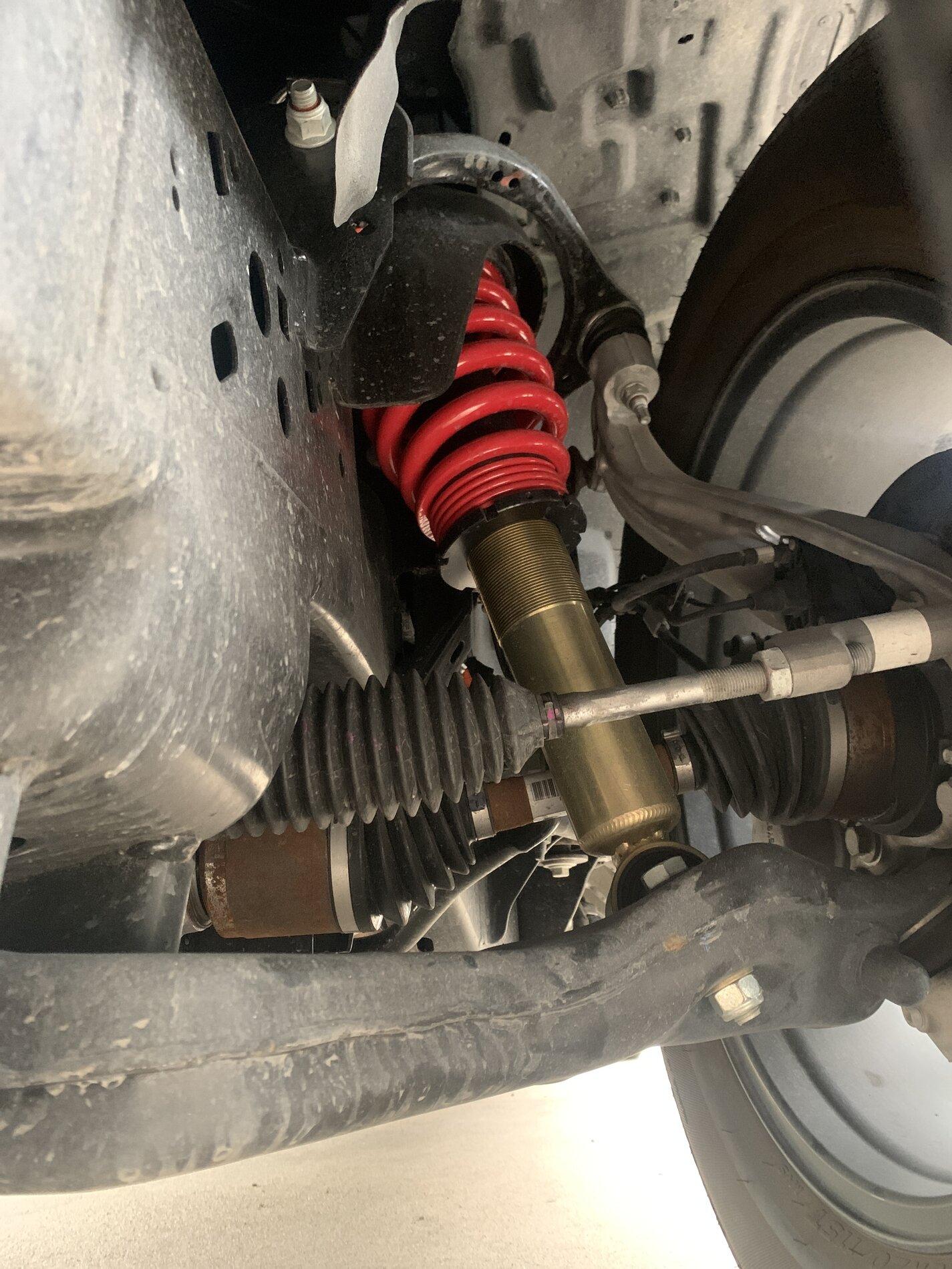

Looks good Tom...
Did the ride quality change much. Ours has the max tow package an seems a bit compromised on larger bumps. Almost like hitting the bump stops but we have not loaded it yet. Trying to figure out if it is the spring package or shock package
I only had the truck a couple of weeks before this. But I think the ride actually got a little better. I know I have not hit the bump stops.

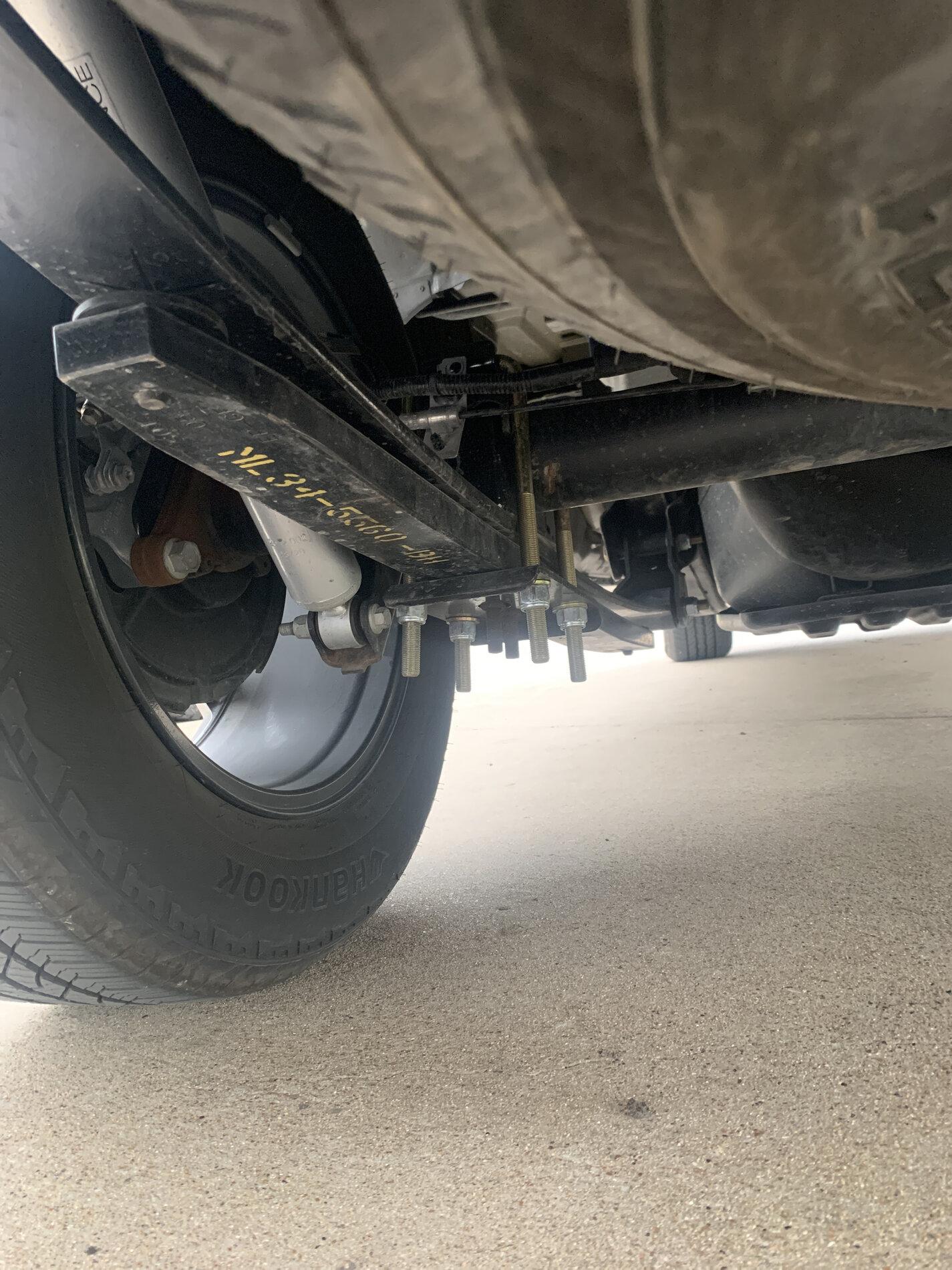

Remove the rear blocks. I did that on my 2016 and it looks perfect. Not lowered, but level from removing the rear blocks...prob ~1.5-2"
Is this a DIY? I've done suspension work on other vehicles but never even looked at a Ford before....
Tracerace
Tom Sullivan
Mar 19, 2021
2021 f150 4x4
Yes, did it in about 4 hrs. It’s a bolt on kit. The directions are good. The only cutting was the two front leaf spring bolts but the kit comes with new ones. One hits the muffler and one hits the gas tank. Easier to cut. Also 100 lbs seems a bit much on the rear ubolts. Haven’t installed the sway bar yet. If you have done suspension work before, I don’t think you will have a problem.

Do 2020 drop kits fit on a 2021? Can a 2020 kit be used on a 2021? If so what modifications would be done in order to fit ?
RedundanT
Dec 17, 2021
90
GB SA3 4EN
2021 RCSB 5.0
Making lego parts for new vehicles
Front upper strut mounts appear to be "slightly" different, enough to induce wear. Rear springs were changed to mono leaf. So yes and no. Find a supplier that has a specific '21 kit.

Looks really good, ride ok?

Rear blocks removed and drop shackle.

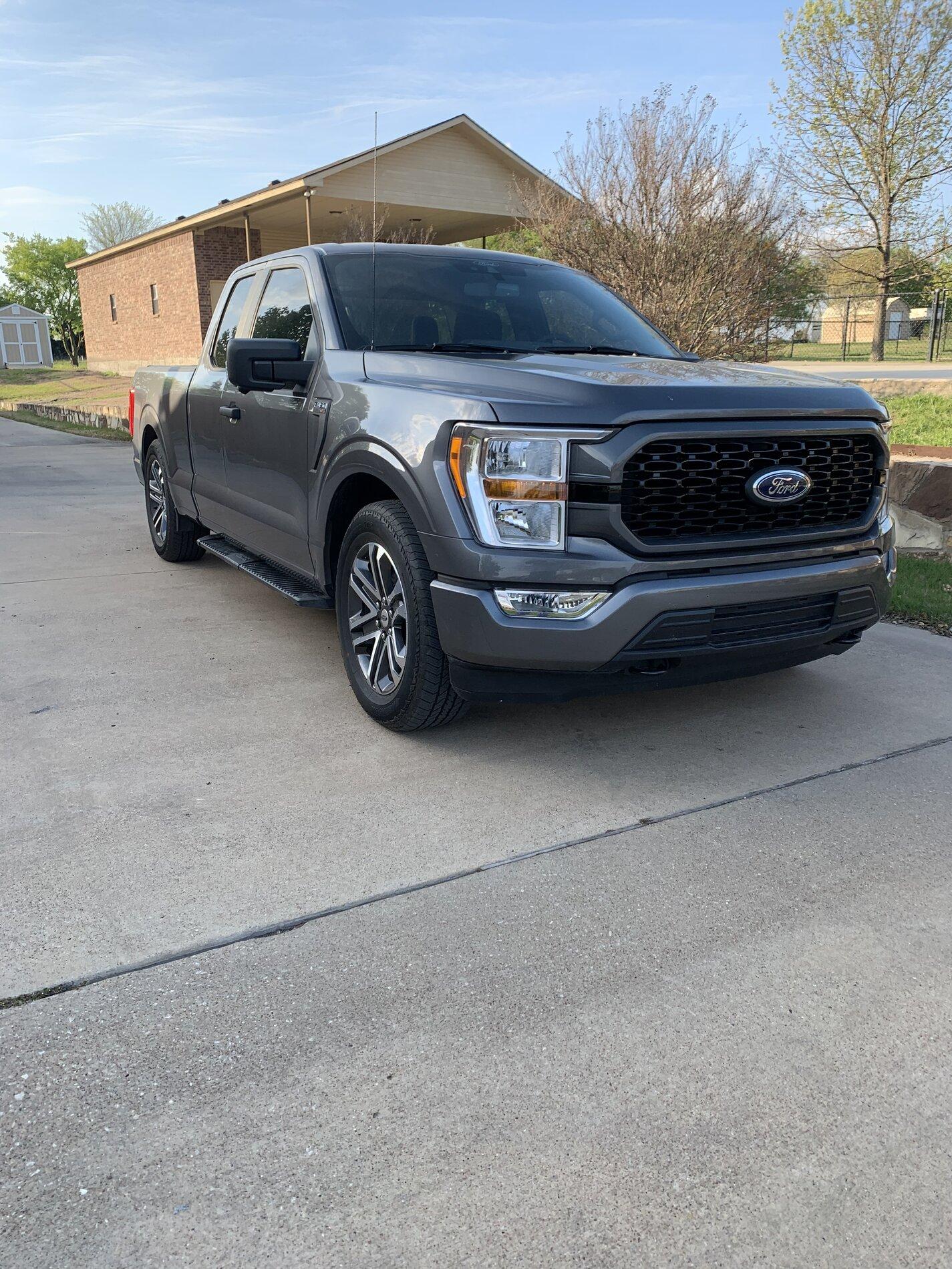

Buddy of mine just installed the 2/4 Maxtrac on his 2021 RC, he said it aligned awesome, drives perfectly, and he works at a Ford dealership. Like $800 for the whole kit.
will try to get pics.
Graygoose2021
Nov 18, 2021
403
95
Central US!
2021 F150
Sales
Honestly not sure. I will ask him.
Kit fits 2wd and 4wd.
