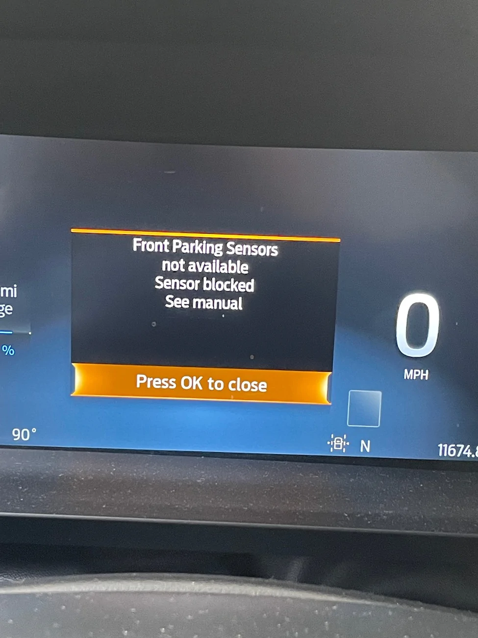

For some unknown reason to me my front sensors are not available because of blocked. See Manual. I've looked all over the manual and all it says is I may have dirt, mud, etc on the sensors. I've cleaned, cleaned, and have reset sensors in Driver Asdist mode. Anyone have this issue? I have an appt with Ford Service next week. See photo:

I have had the same issue since day one being intermittent.my truck is now 18 months old. This normally occurred during the later hours when there were more shadows around. My truck has been in the shop for over six weeks for this defect. They eventually changed the front parking sensor bezels to a different type and repainted them. I am still in contact with engineering and send bug reports when the issue happens. They are still monitoring if you would like to DM me I have engineering email Assistance if you'd like. Let's see what your dealer has to say.

Sounds like a bad sensor. No big deal. Not much to do but check wiring and connectors and replace the bad part.
This would point to cameras and not the sensors.

I'll let you know what my dealer says. If issues continue I'll ask for the engineering info!

wasnt there an Update that fixed this? I had same issue a few months ago and brought truck in for an update and it has pretty much disappeared. Bringing truck in tomorrow for the rear truck bed camera replacement.
