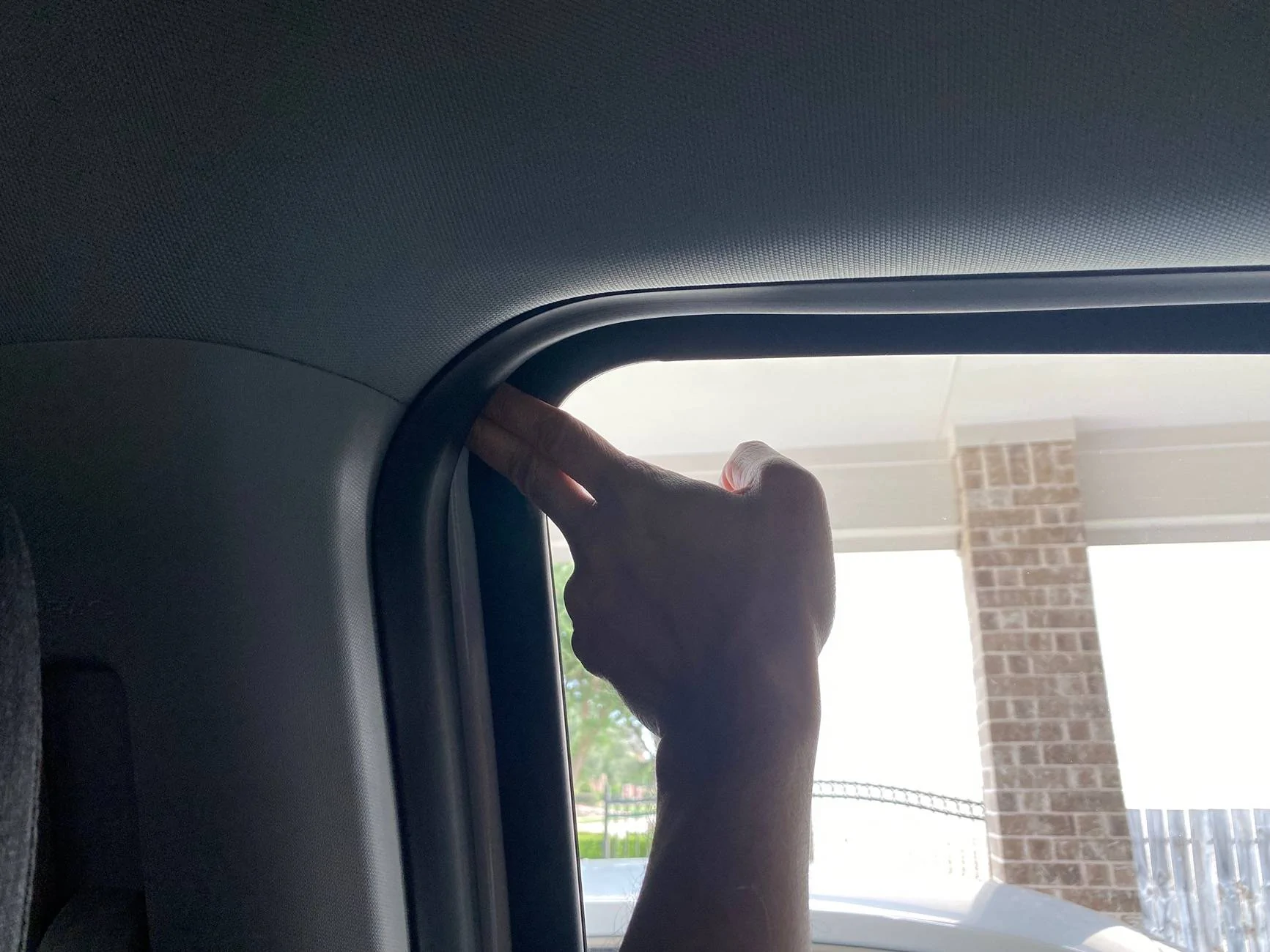

The gap between the driver door and the rubber seal is wider at the top corner, close to the B-Pillar (near the seat belt area), on my new Flash. It makes a rubbing noise when going over bumps, even at slow speed. The fitment on other doors is pretty snug. I’ve attached a picture of the area in question. Is it an easy door adjustment, or does it warrant a visit to the service center?

Ok, so feel free to research this on your own, and please don’t just trust some rando on the message board, especially because this will sound like bullshit… but…
The way to fix this if the bottom of the door is fine but the top sticks out is to open the door, open the window, brace the middle of the door and CAREFULLY pull the top corner in. It’s aluminum, so this is going to bend a lot easier than my old 77 Chevy that my sister wrecked, but this is how we did it in our redneck garage. Be careful and good luck. Warning, I proudly wear the “I void warranties” t-shirt.
