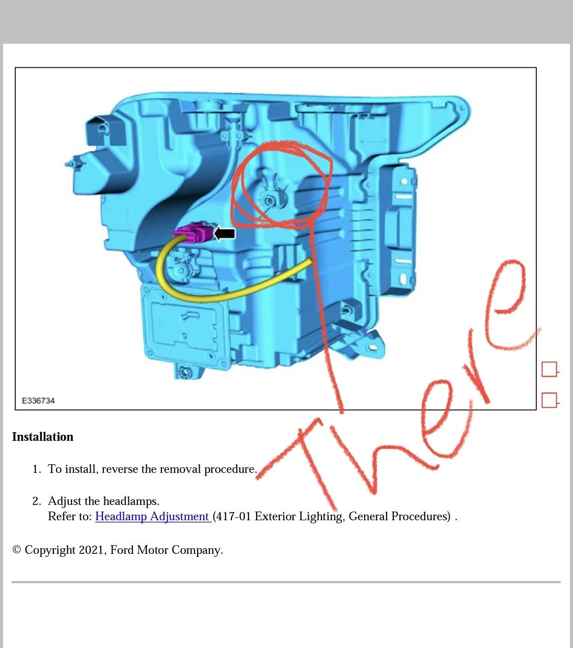

Does anyone know how to adjust the auto leveling headlights? Mine are functioning correctly after the level but the light level now must be blinding everyone because I’m getting flashed like crazy at night lol. I checked under the hood and didn’t see any adjustment screws….
Leveled headlights make sense with the extreme factory rake but with a level they need to be adjusted down. Hoping someone can help out there. I haven’t found anything in the manual or on the internets.

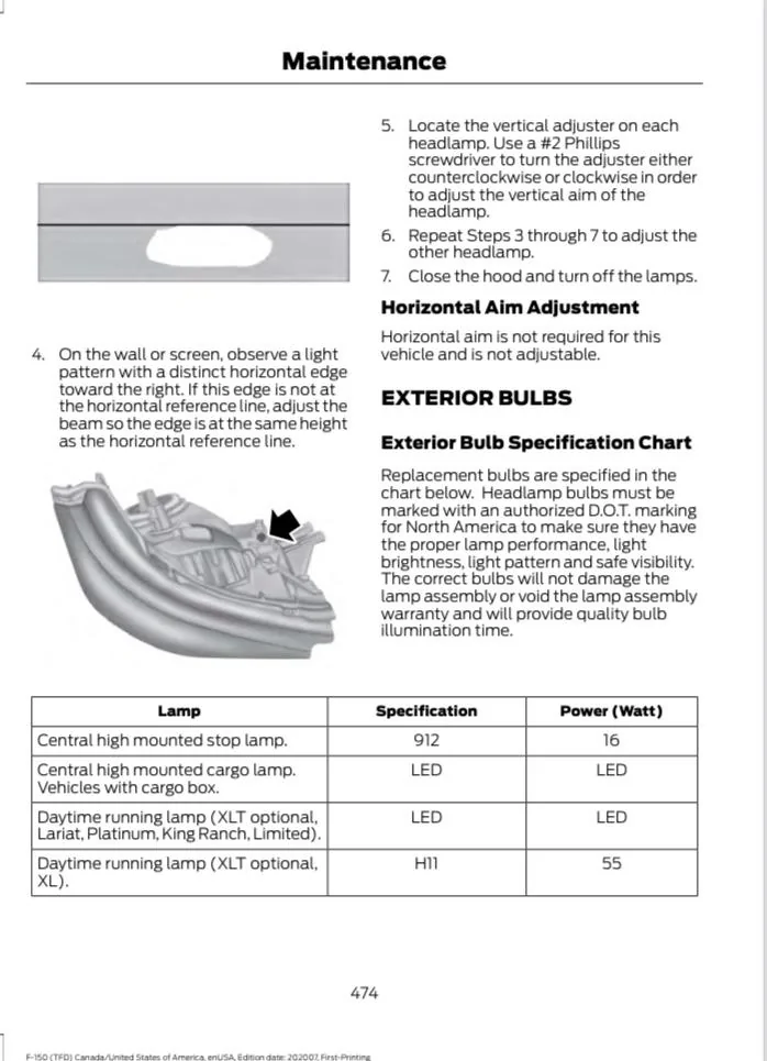

I did mine myself it took 2 minutes per side, very easy. I have an xlt 302a with the quad led reflectors so not sure about the rest but for mine it’s just a plastic Phillips head screw on top of the headlight that you rotate clockwise to bring the beam down. Mine took about 6 full turns to bottom out so I left it at 5 full clockwise turns to get them where I wanted them. I added a 2.5 inch level and 35s so I had to come down a lot. I’m sure 3-4 full turns down will be okay for the majority of people.

There is a philips screw for each side even for the auto adjusting lights.

I can confirm that there are no adjustment screws on the platinum self leveling headlights. I did look in the manual and there is nothing…
My shop didn’t adjust them because they didn’t have the screws like everyone is talking about. They called a dealer today and learned the auto leveling lights have the ability for a “slight” adjustment but it’s more complex than just turning some screws below the hood…I’m bringing it in Wednesday.

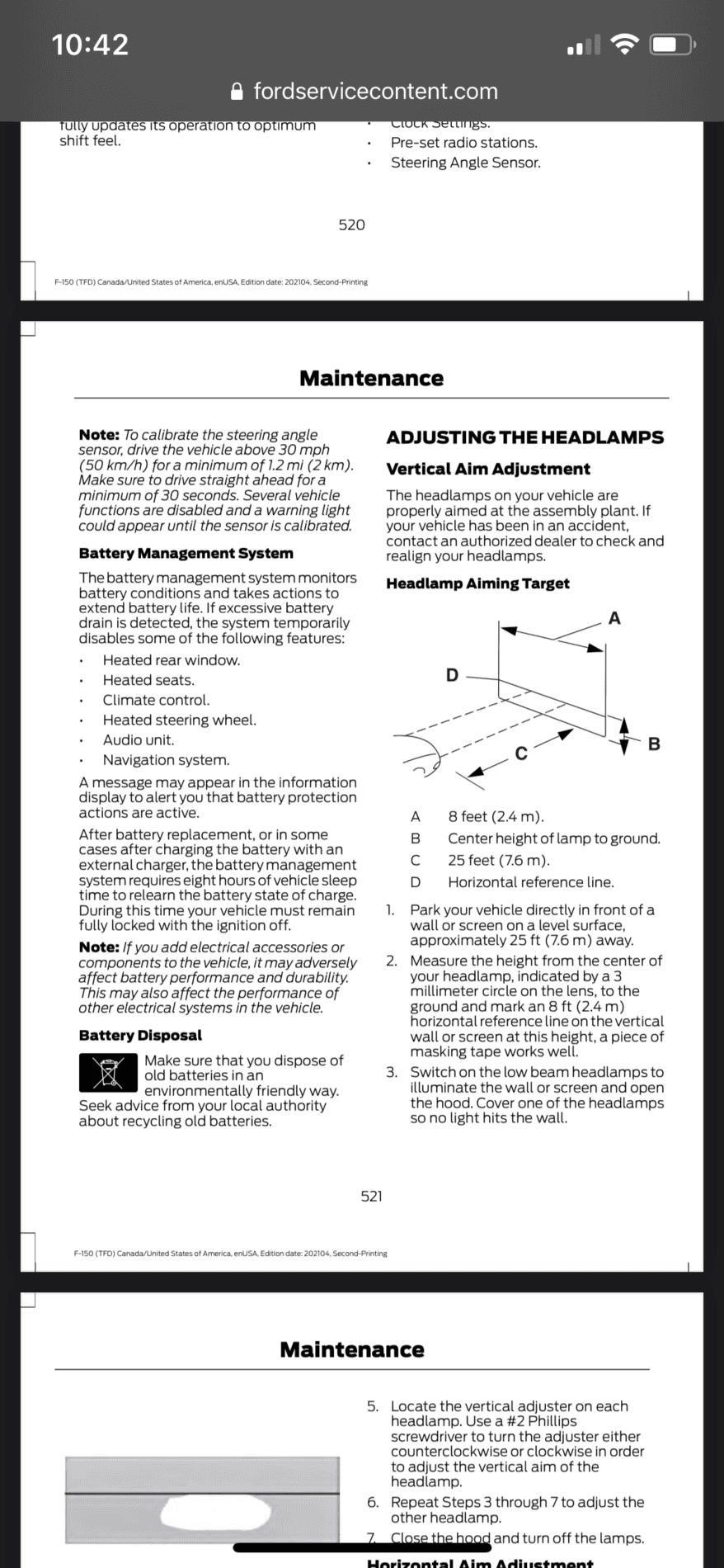

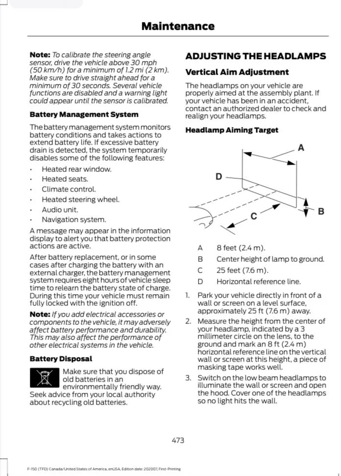

Every car on the planet has the instructions in the manual. I just wish people had the foresight to think about it BEFORE they go blinding people.
“Hey I lifted the front of my car 3 inches, now I think my headlights are too high”, lol.
Feel free to post the manual instructions…
The self levelling projector lamps definitely have adjustment screws. I know this because I adjusted mine after having a 4” lift installed. It takes 2 minutes to fix.

Ok thanks everyone…I apparently don’t know how to find it in the online manual smh. My bad.
