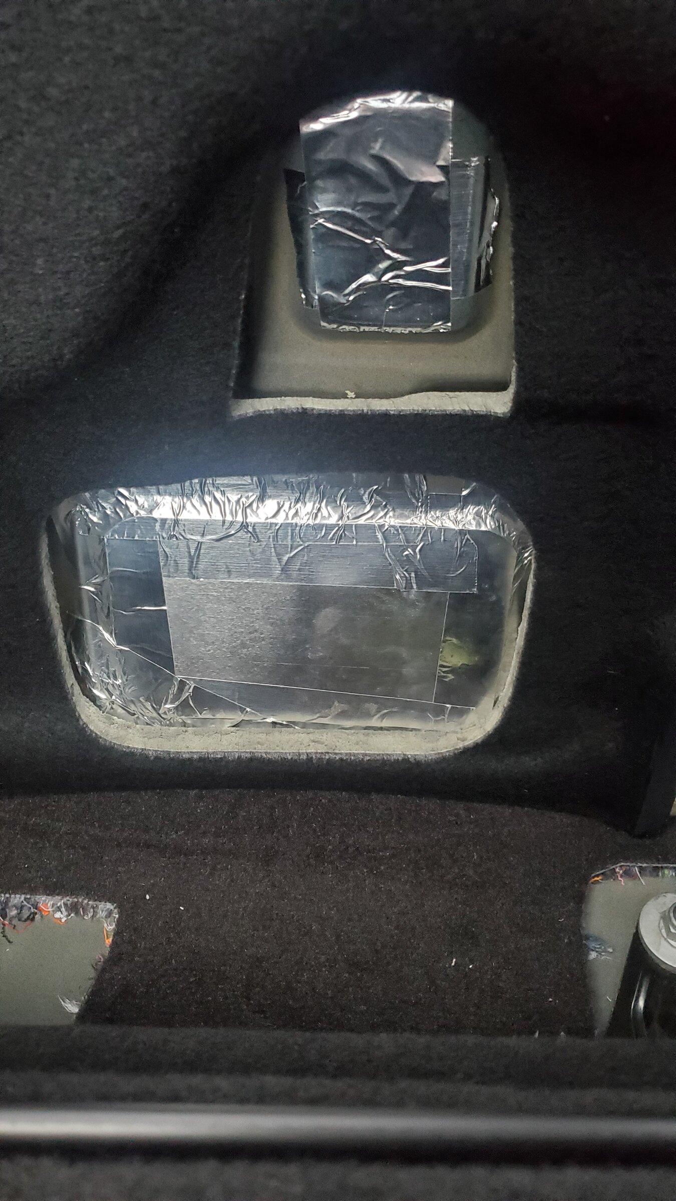

Very true, just finished it this weekend. There are two holes in the cab you will have to seal once the b and o sub is removed. I used alum flashing, weather striping and alum tape. 200km today and no issues. Ill see if i can get a photo of the sub installed. Only stumbling block i had was i didnt have both left and right inputs wired into the b and o feed to activate the remote on. Much better sound than the factory sub, but won't rattle the plates off the truck.Following- I have a hideaway I wanted to run also. Assuming it’s better than the stock sub with B&O non unleashed.
if I’m following correctly it’s removing the stock sub, taking those leads and using one of those adapters from SGS to run the hideaway. Would love to see a finished product. Thanks
