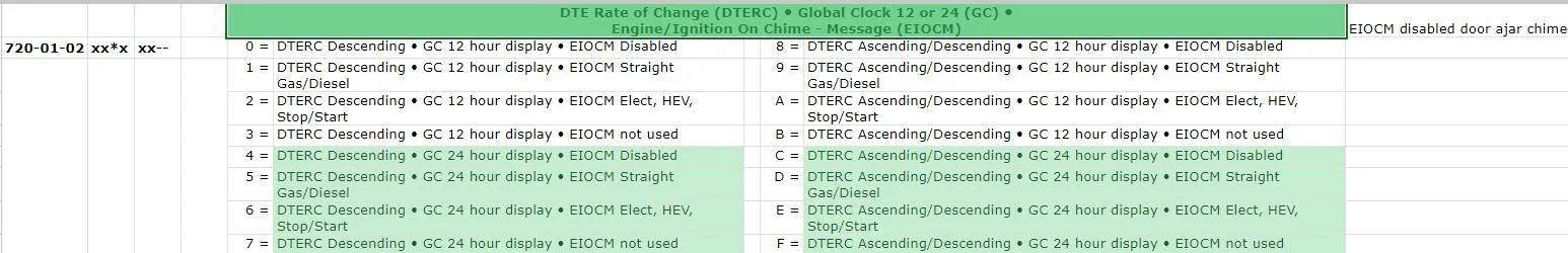

Not in my truck there isn't, but was not sure if the Lightning is different. This appears in the FORScan spreadsheet under the IPC section, though. Worth a try. This is what you're showing there now. Should be accurate as PTS shows the IPC reported itself to the mothership 9 days ago.
Well shit! You saved the day again. I changed that bit and now the clock is defaulting to 24hr and the toggle is still there to change it back if needed. I never would have thought it would be in the ipc. I just assumed it was in the apim. Thanks bro really appreciate it. ?

Tbh, I just control F on Livinitup's spreadsheet and search for key words to see if there's anything there. I searched for "hour" and that's the only thing I found related to your concern. I'm also surprised to see it was on the IPC and not the APIM. Did you use a 6 or an E?

I think a 6 if memory serves. I just matched up everything that I originally had with the clock showing 24. Soon as I did that and did the restart the clock showed 24hr.
