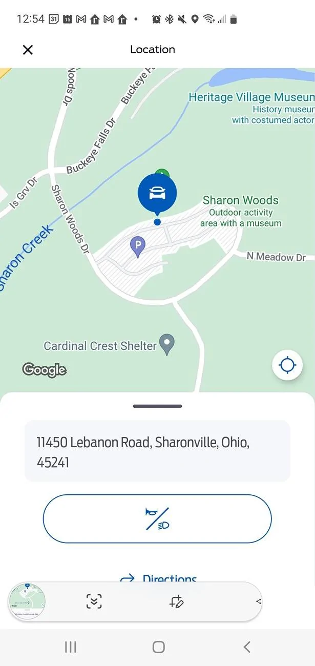

I have several problems with the Ford Pass App and was wondering if anyone else was having any of these issues or knew how to resolve them. Shortly before I noticed the first issue, I took my truck into the dealer for 4 separate recall “programming updates”. The other issues were present both before and after the recent trip to the dealer. I have an Android phone, and tried deleting the app and then reinstalling it, but that did not fix any of these issues.
  • I have used the “Location” feature successfully a few times to check on the location of my truck when I have left it at the dealer for service or when I have loaned my truck to someone else. For the last 2.5 weeks (since 10/10/24) my truck’s location has been “stuck” at a location that I was briefly at on 10/10/24. I have not been back to this location since 10/10, but the App shows my truck is still there, 17 days later (see the screen shot of this stuck location). I don’t see a way to reset this location feature.

Ford F-150 Lightning Fordpass issues with Location, charging information, Target Charge and other issues FordPass screen shot of location

Are all your consents for data sharing on the Sync screen still active, you might want to toggle them off then back on to shake up the system, make sure any sub-menu approvals are also switched on.

In addition to the excellent advice in post 2, if you want to be certain your charge settings take, make them directly in the truck. That eliminates the path FordPass —> Ford servers —> truck. Too many things can and do go wrong there.

May want to reboot the Sync screen.
With the truck on, hold the Volume down and advance button (arrow pointing right) at the same time on the steering wheel until sync reboots.
If that doesn't help then removing the ground wire from 12V battery for about a minute should reboot all the truck modules. Others here have reported this will cure many quirks on the truck.
