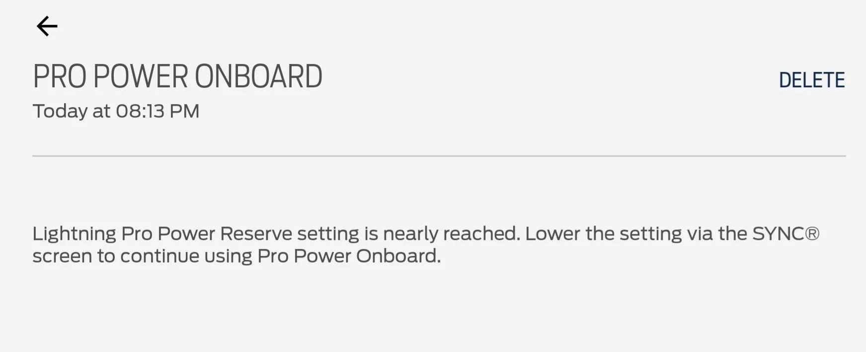

Has anyone else received the below message? I noticed it when I got inside my house after I had been driving, nothing popped up on my screen in the truck. Is this anything to be concerned about?​

I have once. I believe the pro power was activated somehow (I didn’t do anything) and after a while this message pops up. I didn’t notice any significant charge drain so didn’t think too much of it. If it happens again I may try to have it addressed at the dealership.

There is a setting for state of charge where Pro Power will be disabled, to preserve battery. Whether you are using Pro Power or not, you will always get this message when your drop below this state of charge. You can lower the setting to avoid the messages (just be aware of your charge level when using Pro Power) or just ignore the messages.

My setting is at the default, which is 160 miles. Every time I turn the truck on, every phone in my house gets alert messages since we share FordPass, as winter range in a SR is less than 160 miles.
If I were to lower Pro Power to 80 miles, would this have any downside? For example, is there additional battery drain or phantom drain, even when outlets aren't being utilized? I normally keep settings at the default, because I assume the manufacturer knows best, but I'm not so sure here.

No, I do not believe there is any downside to lowering the setting. Doesn't make much sense as you found out on the SR to have it set that high.
