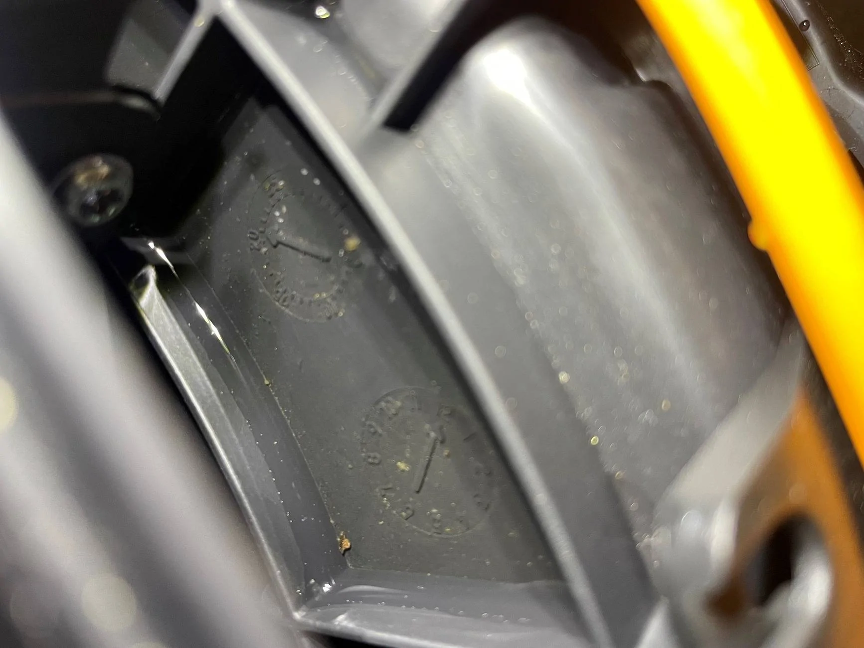

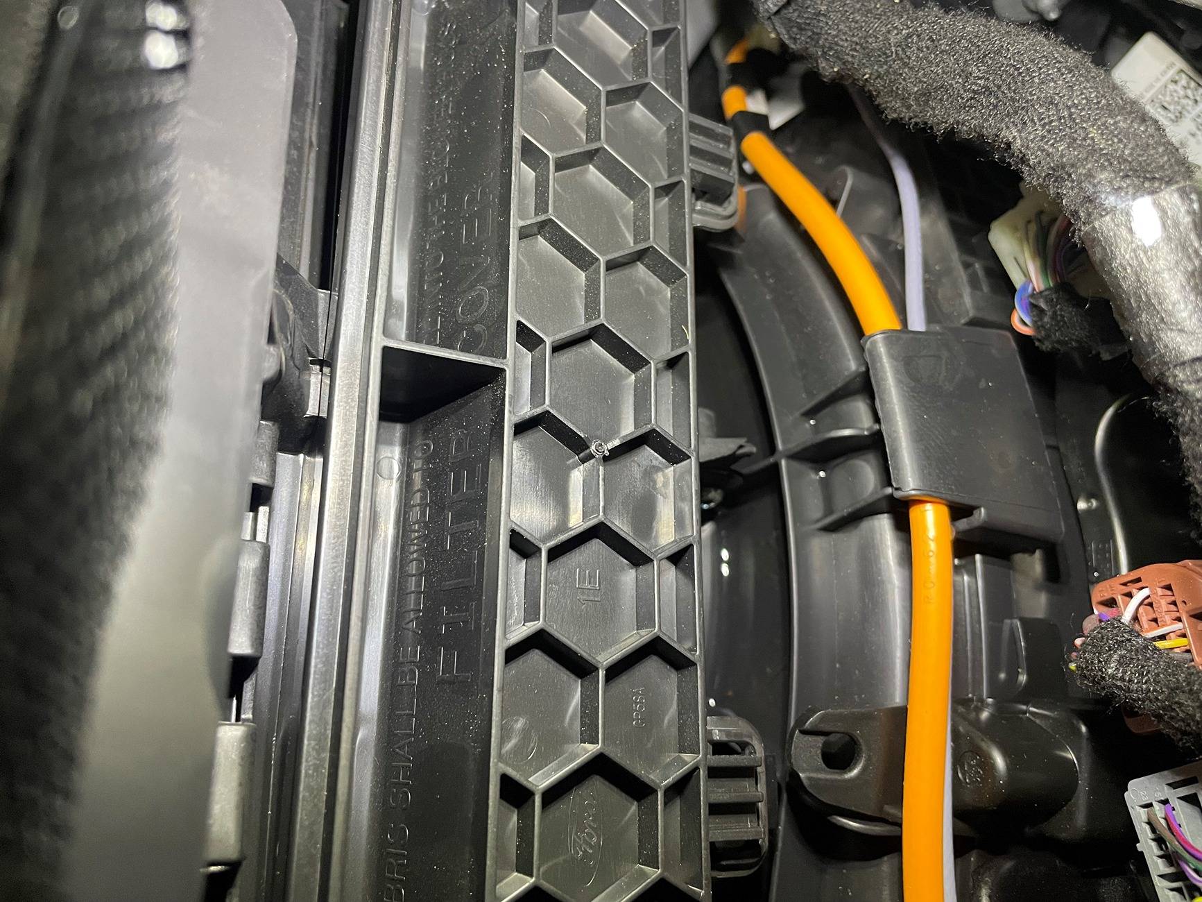

I’ve heard a “sizzling-type” noise before, after a rain storm. Like water in a frying pan, not an electrical sizzling (*maybe I was wrong on that). The noise was apparently water getting into the AC fan/system. It would go away if I shut the system off altogether. This time the truck smelled bad, like rotten food. I dug into it and found the cabin air filter was wet (yesterday 9/3/24). I let the system run so it would dry out. This morning I took the filter out because of the smell and looked around and saw standing water on cavities around the filter housing. I checked the floor but I think it’s already dry to the touch. I would bet it was probably wet too. I have an appointment tomorrow morning
