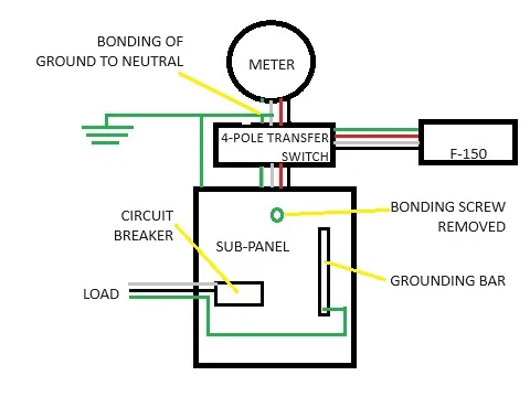

There are many threads addressing the retrofit of generator support for existing construction. Doing this legally and functionally is not a trivial task. However I believe that new construction should be simple. Attached is my schematic and I invite corrections.
Ford F-150 Lightning New construction for generator backup generator
Note that the ground and neutral are bonded at the first point past the meter as codes specify.
Bonding precedes the transfer switch so that they are not bonded when the F-150 is used as a generator.
As bonding has already been performed the only panel is a sub-panel, with the green bonding screw removed and a grounding bar added.
What have I missed?

You only need a 3 pole transfer switch. The EGC (Equipment Grounding Conductor) should not be switched.
You need a service disconnect ahead of the transfer switch unless it‘s listed as “Suitable for use as service equipment.” Not all of them are.
What year code cycle are you on?
Edit - Ohio has adopted the 2023 NEC so an “Emergency Disconnect” is also required. See 230.85.
You are correct, and thanks for catching that. I had missed it.
I am also building a workshop which is not for human habitation. It appears that the emergency disconnect is not required for that?
And if the transfer switch has an intermediate Off position does that constitute an emergency disconnect?

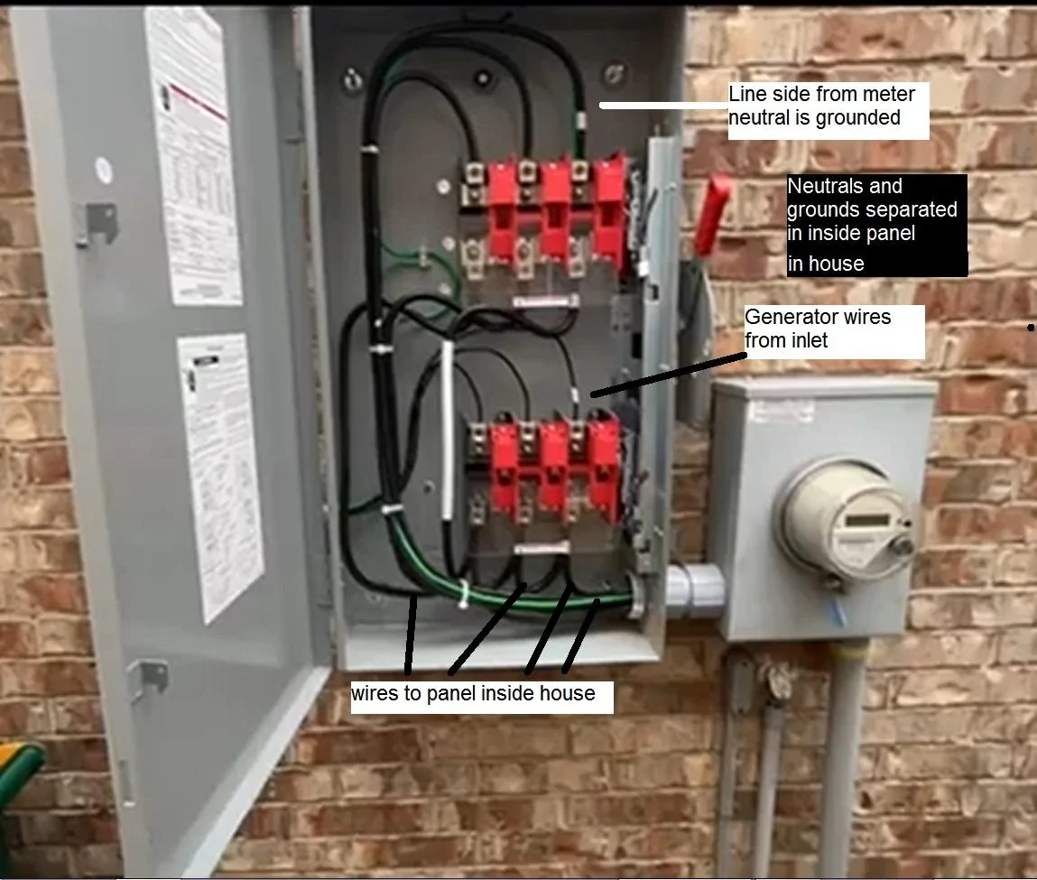

Just a point of clarification...
You are not expecting the Lightning 30A 240V to power the whole house are you?
Or will the whole house not exceed the 7.2Kw capability of the Lightning?
Maybe you will switch off some load breakers in the panel when using the Lightning to not overload it?
That would be my only concern with what you are suggesting.
But I really don't think retrofitting is all that much more complicated.
A $400 manual transfer switch, a generator inlet and connecting wire, and a generator cord to the Lightning is all you need. You simply re-route the hots and neutrals of the circuits you will be transferring from the main panel to the transfer switch using the wiring that comes with it. You add a 60A breaker to the main panel to power the transfer switch.
But that's just me.
By the way there was a YouTube video of that type of install, here's a screen shot:
Ford F-150 Lightning New construction for generator backup 3-pole transfer switch-wired
But that's just me.
The video is at:
Thanks for the link to the youtube. That video was actually part of the inspiration for the circuit I posted. The 30 amp version of the switch shown only costs $450, but the 200 amp version actually shown costs $3,600. Of course the 30 amp version would be OK if an existing panel is left in place and just a few emergency circuits are moved to the new sub panel. However I want the flexibility to run any circuit in the home on the generator as long as I switch off others (in this corner of Ohio power outages are the norm). For example if I want to run one of my milling machines in the shop I will need to kill the AC, microwave, and hot water for a while. I am doing that now to power construction while still off-grid and the AC, microwave, and hot water do not yet exist (milling machines are obviously the priority!), I have not found 200 Amp UL listed switches for attractive pricing. I have found imported switches built to the CE specifications rather than UL, and they were previously identified by others in this forum. I have 40 years of international machine tool experience and have found the CE specs to be very robust and arguably superior to UL (the same could be stated for J.IS.), but I doubt that I could convince an inspector in ultra-rural America of that (they simply have not been exposed to CE and J.I.S equipment so how would they know). So are there reasonably priced UL switches for 200 amps?
The way I read it, the emergency disconnect is only required for the dwelling.
It could qualify if it meets all of the stipulations set forth in 230.85. For example it must be installed “…on or within sight of the dwelling unit.”

Thanks, I did not catch that, but I think it is OK as the meter will include a disconnect.
4,438
5,967
In that case, just be sure that the connection to the grounding electrode is in the meter/main and you run 4 wires from the meter/main to the transfer switch.
