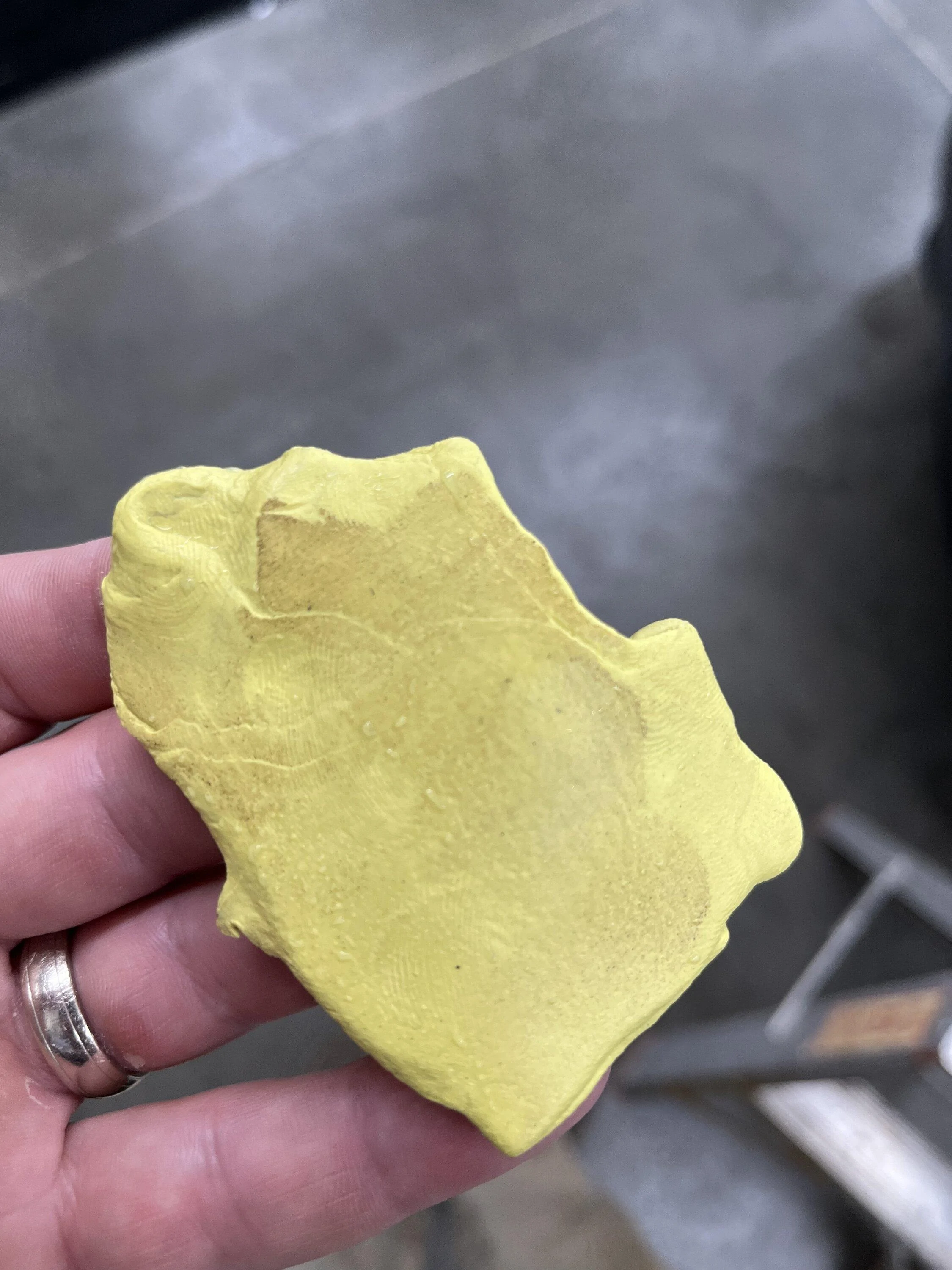

Clay bar is step one - it is done with some good detailing spray/lubricant. You want to keep it wet while you work. Do this regardless. You can feel the difference immediately about how much better the paint will feel.

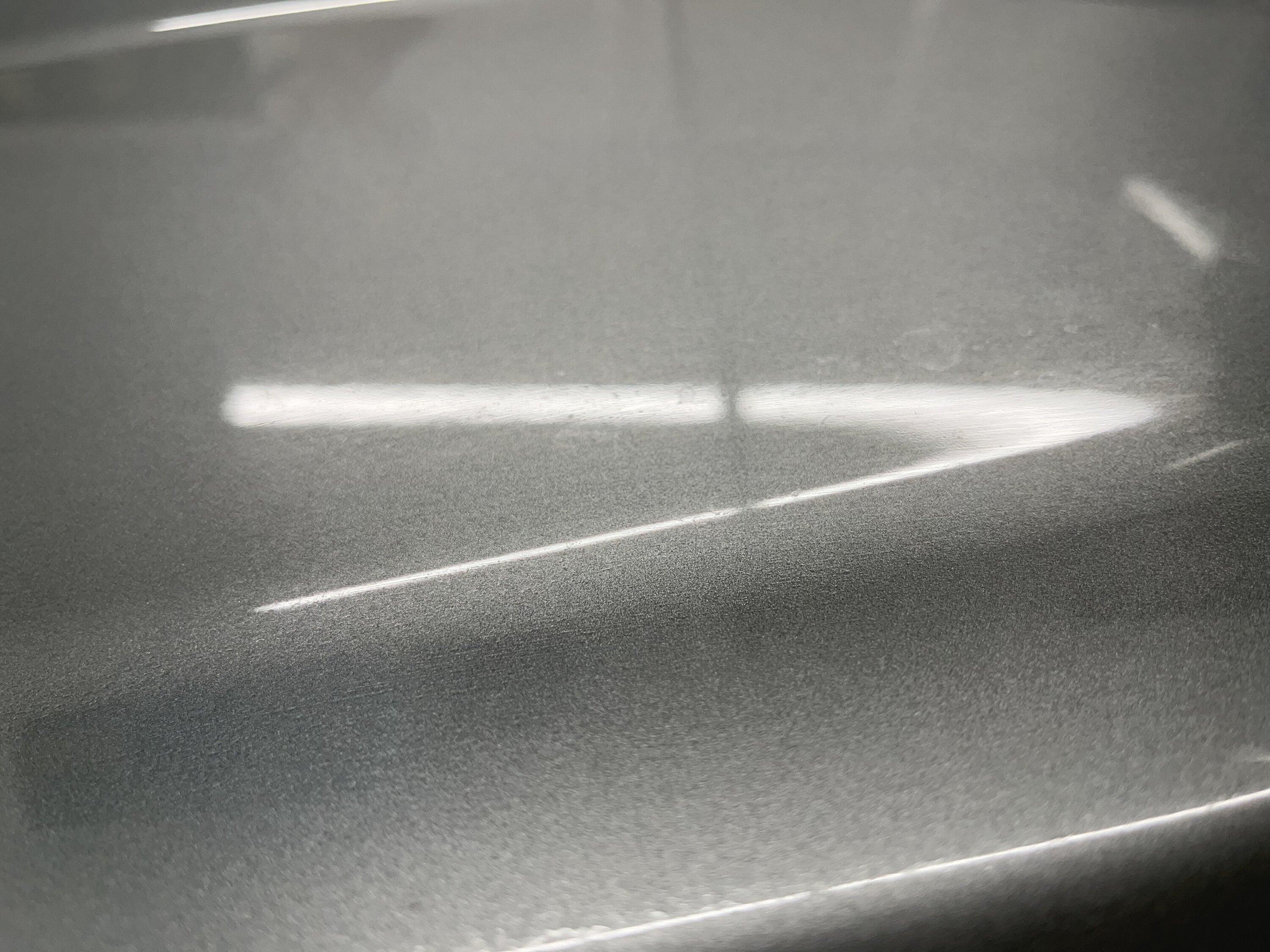

Second is the polish. You only need this if you have any scratches or swirls in the paint. You do not want your dealer to wash your truck and prep it for delivery. Reach out to them and ask them not to touch it. Most of them will run it through a car wash with brushes - you are already doomed at this point, if you want flawless paint. Just ask them not to prep it. It will be more work on you, but you can hand wash it to get started and
If they have run it through a car wash with brushes, you'll likely want a power DA - Dual Action buffer with a very light cut pad and some light cut polish. You might be able to do this by hand and with a MF cloth, but it will be ambitious.
