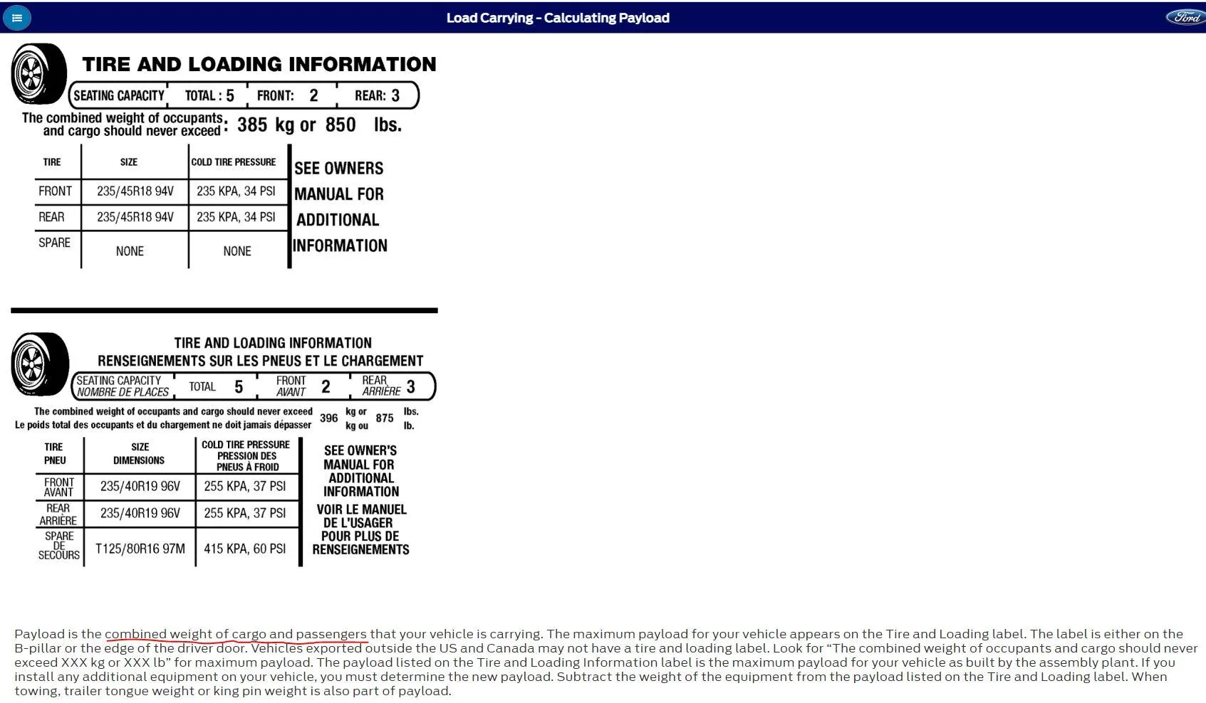

Actually Payload DOES include all passengers AND cargo. this is a snip from the F150 Owners manual.
It does not include them in the payload sticker on your door. What they are saying is to subtract all people and cargo from the sticker on your door.
The OP is WAY overweight, no 34' RV should be pulled by a 1/2 ton. One factor is the weight as the hitch weight will no doubt be over 1K and the other is the fact that there is a 34' billboard behind the truck going down the road.
What? Yeah obviously determining your impact on payload includes passengers and cargo, which is what the manual is saying. I was clearly responding to the OP saying that 300lbs for a driver and passenger is included in the payload number on the door, i.e., if your sticker says 1436, actual payload is 1736 but they assume a driver and passenger. That is not true. Payload sticker is maximum available payload with nobody and nothing in the truck assumed.
Tow rating assumes 150lb passenger IIRC, because when towing you always assume a driver is there. But payload is determined by capability of the wheels/tires/axle/suspension, so even with nobody in the truck and it sitting in a driveway, you can still be over payload. For an example of this, try dropping 5000lbs into the bed while it is parked and nobody inside. The spectacular failure that follows will show a sever over payload condition. You can hook the moon up to an F-150 and as long as nobody tries to drive it you aren't technically over tow rating yet. :p
Yep, thank you for clarifying it.

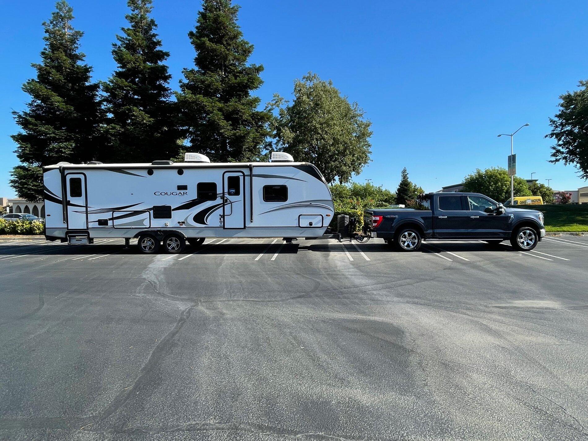

I totally agree with Don that the right hitch and setup is required and will greatly improve the stability of the rig. I pull a Cougar 29BHS (34' ball to bumper) at 7900# loaded and just over 1000# tongue weight including the Husky Centerline WDH (116#). My KR, 4x4, EB, Max Tow has a payload of 1536# and it pulls like a dream.
I would add that the Payload sticker DOES include a full tank of gas.
