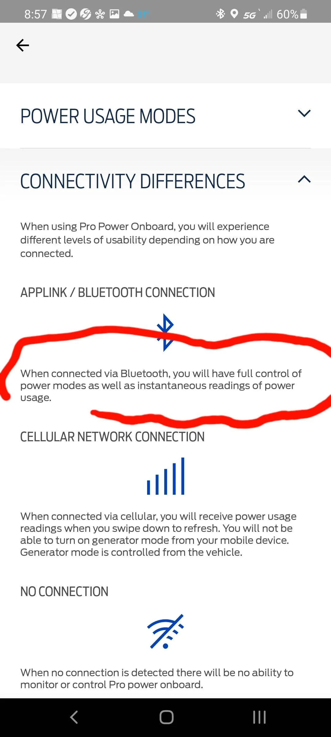

Is there enough interest among the RV enthusiast to ask Ford to update the software that would allow us to start the truck, then generator utilizing the Ford Pass app.? On Cold winter mornings it would be a pain to have to go out and start Truck then Generator for that first cup of coffee.?
To be honest, this ability already exists in the FordPass App. Until recently that is, I will explain......
I live in an RV full time and I have used my Powerboost multiple times during shore power outages and boondocking. I must have accidentally discovered that you could remote-start the truck and then enable generator mode from FordPass because I did just that from the first time I tried. Later when I tried again and it didn't offer the choice to turn the generator mode on I had to figure out what had changed.
I quickly noted in FordPass that I was required to have a Bluetooth connection to the truck for FordPass to "extend" the functionality of the App.
Here is how FordPass describes the difference between a Bluetooth connection VS a cellular connection :
Ford F-150 Lightning Powerboost 7.2kW Towing Travel Trailer - First hookup and test results Screenshot_20211127-085713_FordPass
So I realized that I first do a normal remote-start with FordPass or the Keyfob. Then since the truck is close to the RV, I just verify that I have a Bluetooth connection to the truck and the additional extended functions of ProPower appear in the FordPass App!

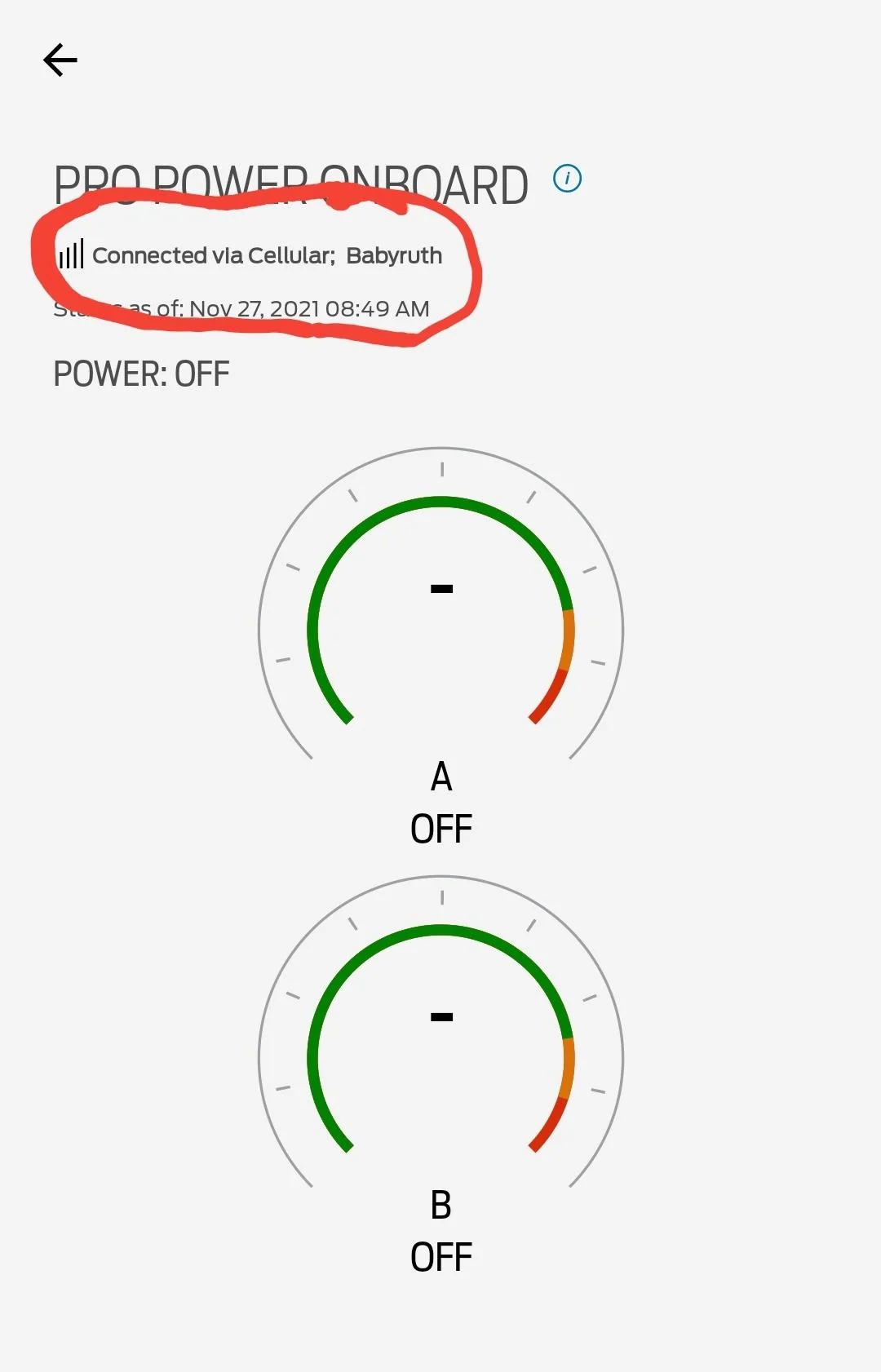

Recently with either an OTA update, or a FordPass update, Ford broke the Bluetooth recognition of FordPass, so it only recognizes the connection as cellular regardless of a Bluetooth connection. Below is a screenshot of FordPass showing my connection as cellular even though I absolutely have a Bluetooth connection to the truck :
Ford F-150 Lightning Powerboost 7.2kW Towing Travel Trailer - First hookup and test results Screenshot_20211127-085640_FordPass
I have taken the trouble to track down the proper folks at Ford Customer service that are responsible for the FordPass development code. (it was an effort) They have detailed information of precisely what I have documented above and they seemed genuinely appreciative to have firsthand reporting and stated it will be addressed.
