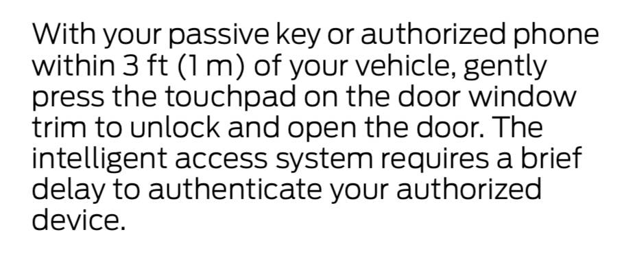

Working as designed. The phone or fob must be within 3 feet of the door. This is to prevent some stranger from accessing your vehicle in the parking lot while you are in a nearby store (for example).
Ford F-150 Lightning PAAK door unlock - drivers side IMG_1154
This is from the Mach-E manual, but the Lightning is the same.
