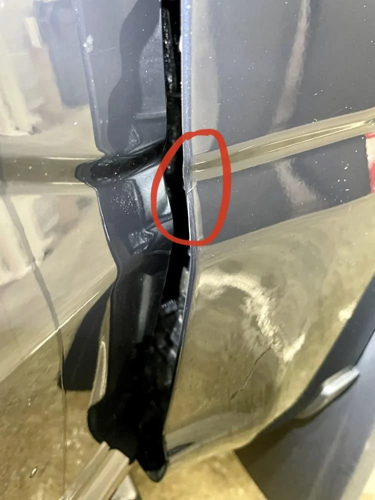

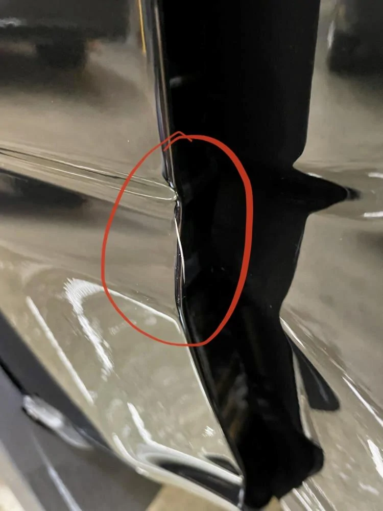

I had taken my truck to get some paint protection film (PPF) and have it ceramic coated, but the shop told me they would not touch my fenders because it appeared that the paint was chipping/peeling in the same spot on both sides of the truck fenders (see pictures).
I made an appointment with the Ford dealer and sure enough they agree that the paint is peeling and they consider this a manufacturing defect and I will now have to take my truck to a body ship to fix it. Kind of sucks that this truck now has a recalled light bar and defective paint. At least the shop didn't install the PPF on the fenders yet and told me to bring it back once the paint issue is fixed.
Just wanted to let the community know just in case you notice some paint issues on your trucks.

I had the fenders repainted. It was covered by the warranty. I waited well over a month then had the fenders wrapped in PPF and ceramic coated like the rest of the truck. No issues with the paint since then and was surprised that I could not tell from just looking they were painted separately.

Well from the time they acknowledged the issue to the time it actually got painted was several months. In fact, I had to get Ford customer care involved to get the dealer to set up the appointment with the body shop. I was quite annoyed how long it took so hopefully your dealer and body shop can get it done faster than me. They did offer to let me borrow a car since it took like 4 or 5 days to get my truck back but I declined since I have another car.

They did a great job repainting. I can’t tell the difference at all. But I also had it wrapped in PPF and ceramic coated so I think that helped. It’s unfortunate that this happened to you as well and it bummed me out at the time but it’s all good now. Best of luck
