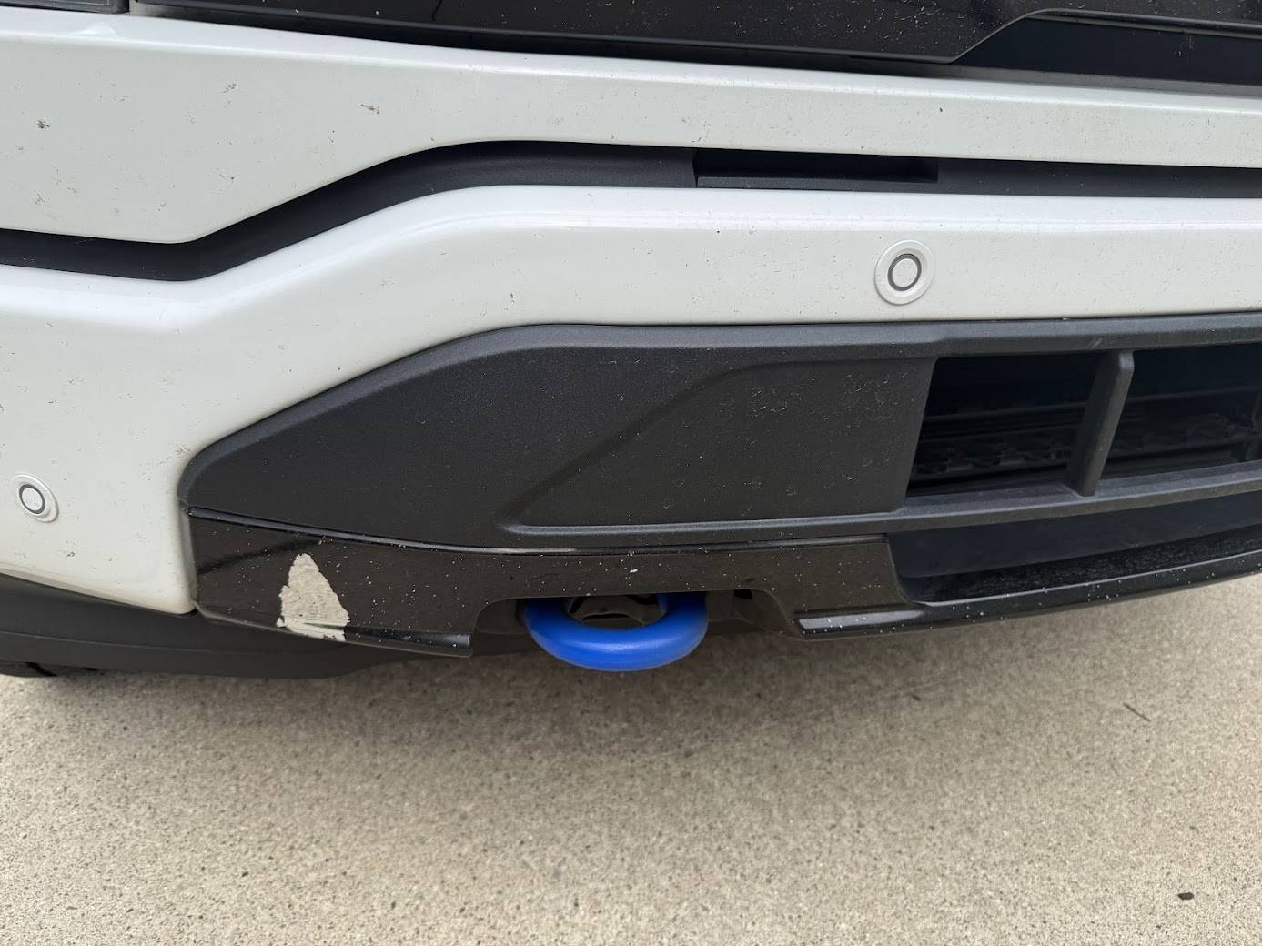

So frustrated and wondering if anyone else has experienced paint peeling on the front of their trucks? Deal says its not covered under warranty. what the heck! its hideous looking and my vinyl shop won't wrap it unless i have it sandblasted off. seems to get worse every week.
Ford F-150 Lightning Peeling Paint on front lower valance IMG_7572
Ford F-150 Lightning Peeling Paint on front lower valance IMG_7573

I have an XLT that did just that. Sanded it down and used bedliner paint and you cant even tell. My dealer was going to paint it but I didnt want to lose the truck for a week......

No I just sanded it down wiped it with paint thinner to clean it off and taped off the edges. This was a year ago and I just took a picture and noticed a few spots I need to go over again. It was the lower valance and it blended perfectly ( I think)
Ford F-150 Lightning Peeling Paint on front lower valance 1753284358919-9j

nice! that came out good.
