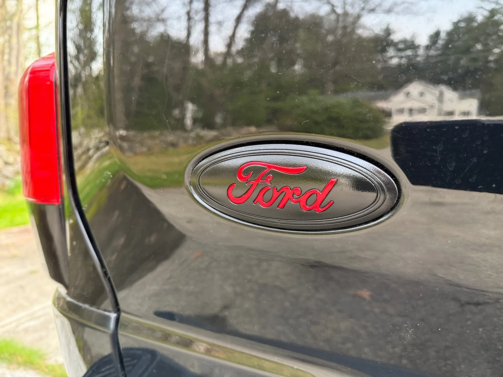

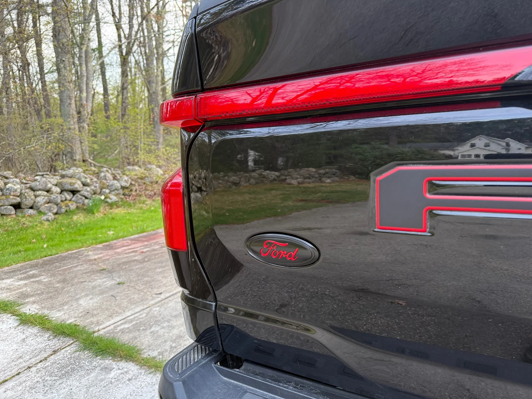

This is not a walk in the park. I broke several parts of the emblem.
Ford F-150 Lightning Painting Tailgate Badge - Lariat Trim IMG_2308

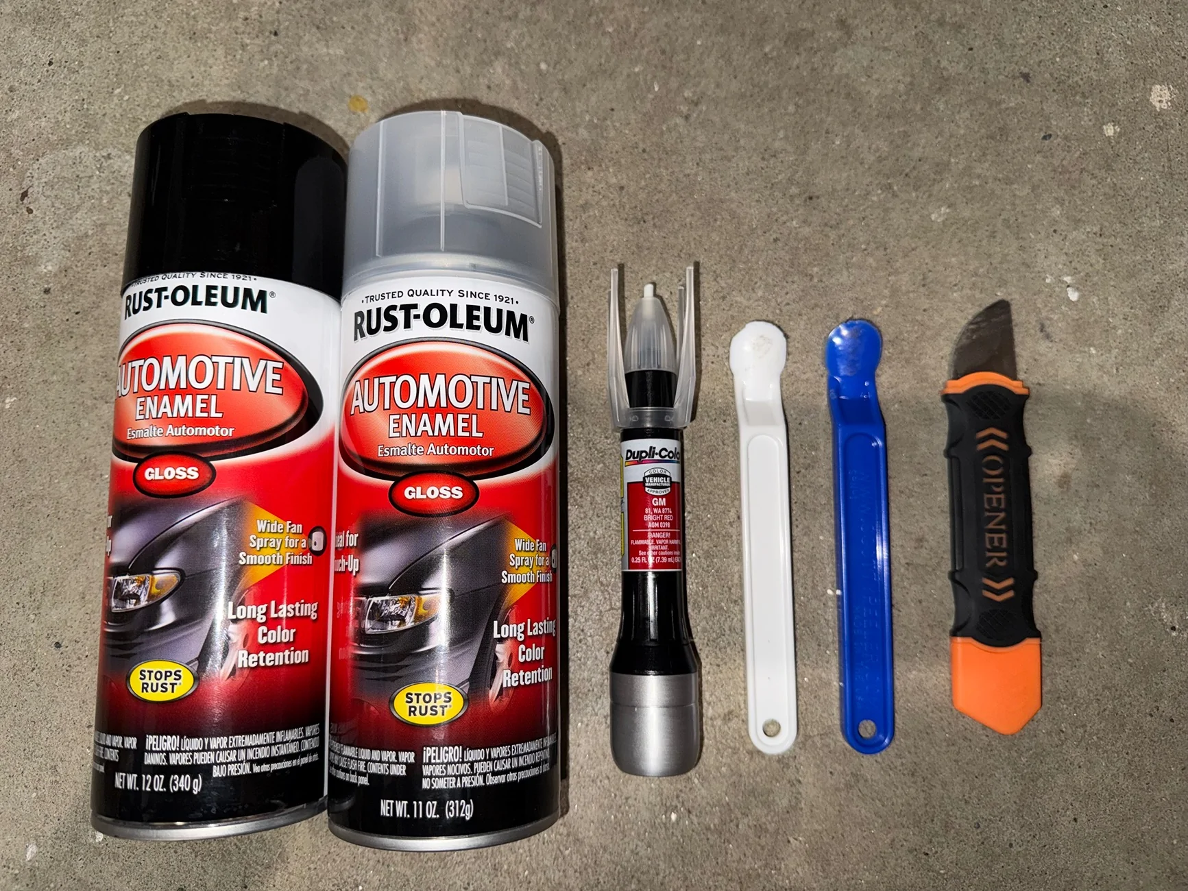

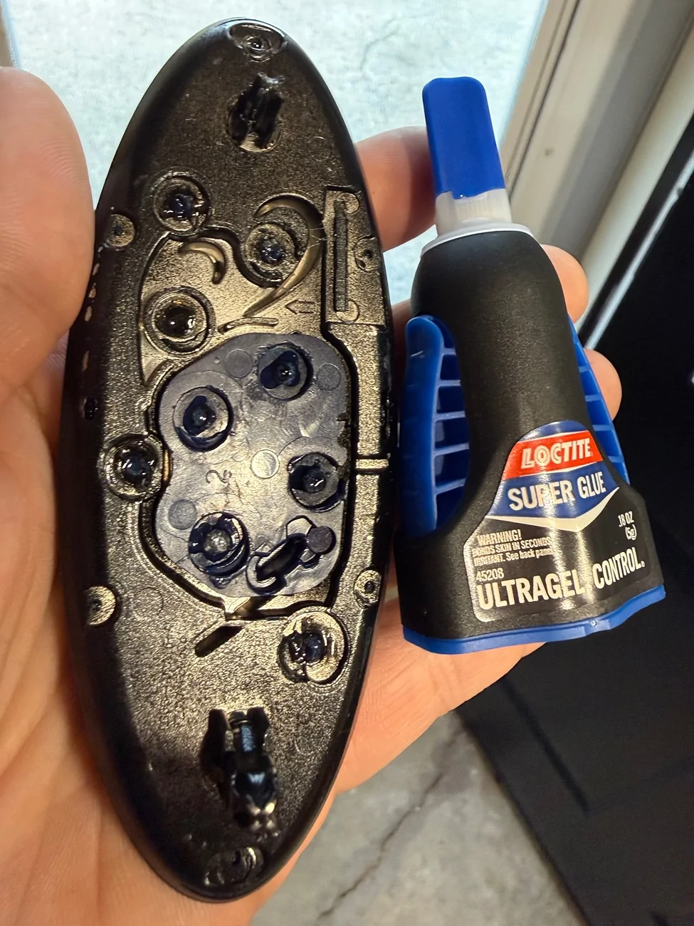

grab these plus super glue and two sided 3M adhesive
Ford F-150 Lightning Painting Tailgate Badge - Lariat Trim IMG_2130
Ford F-150 Lightning Painting Tailgate Badge - Lariat Trim IMG_2135

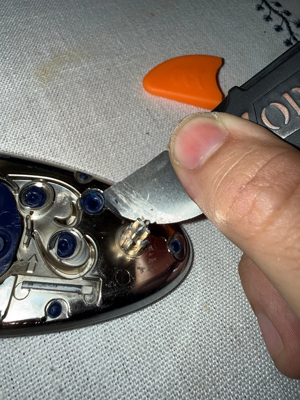

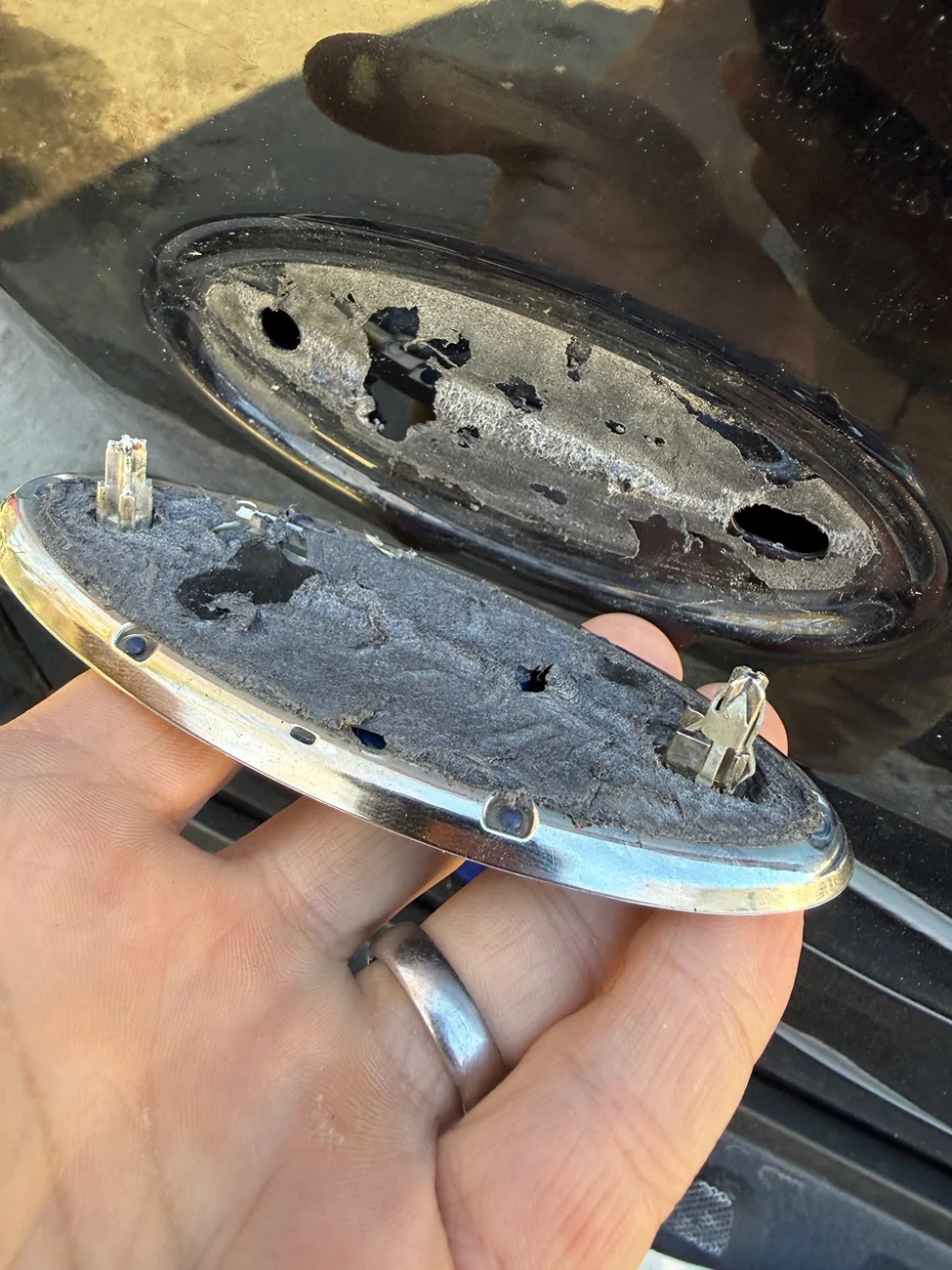

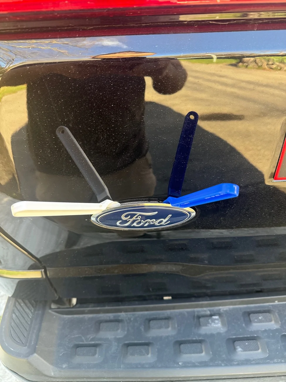

There is NO emblem access from the inside of the tailgate. Don’t waste your time, I opened up the plastic backing and found no way to reach it. Slowly work your way around clockwise with the Scotty Peelers at opposite sides, you will most likely snap one of the two or both of the stabilizing pins that clip the badge into the tailgate, this should not impact your ability to attach it with 3M in any way. Remove the adhesive.
Ford F-150 Lightning Painting Tailgate Badge - Lariat Trim IMG_2160
Pop these off: WEAR GLASSES or you will be taking a plastic shard out of your eyeball with a q tip like me

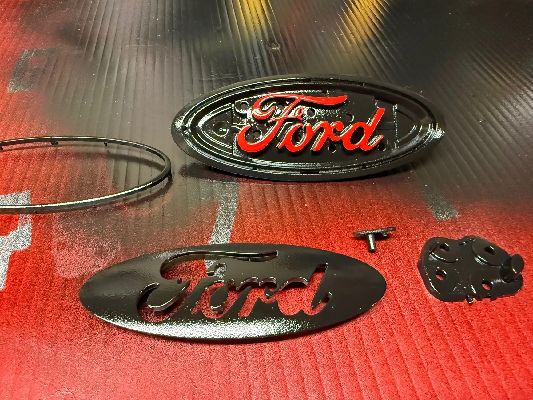

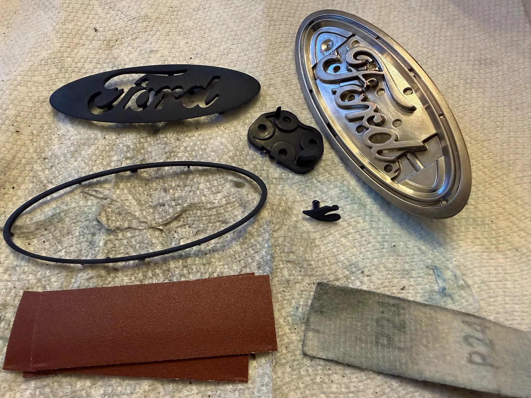

Remove the pieces (shown in video link above) and sand down with P240. Chrome will take a long time, scuff it good, the rest will be quick. You will break things. I broke the oval ring and the inside part of the F of the FORD outline. Breaking these did not impact anything. CLEAN dust off and wipe with isopropyl.
Ford F-150 Lightning Painting Tailgate Badge - Lariat Trim IMG_2231
Ford F-150 Lightning Painting Tailgate Badge - Lariat Trim IMG_2277
THREE COATS BLACK: WAIT ONE DAY

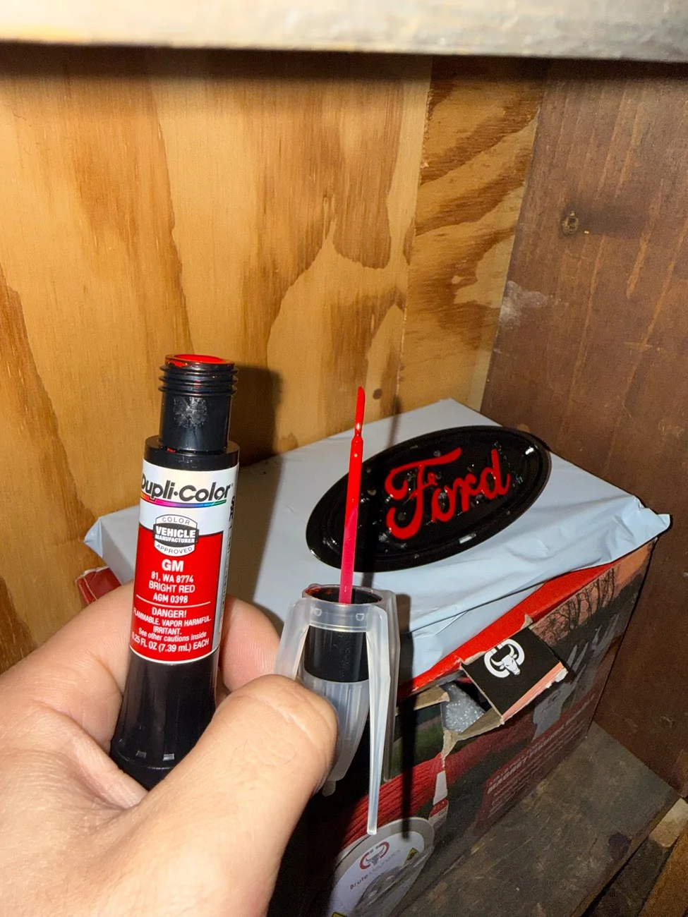

NEXT DAY: THREE COATS DUPLICOLOR RED TOUCH UP PEN, wait another day (solvents evaporate)

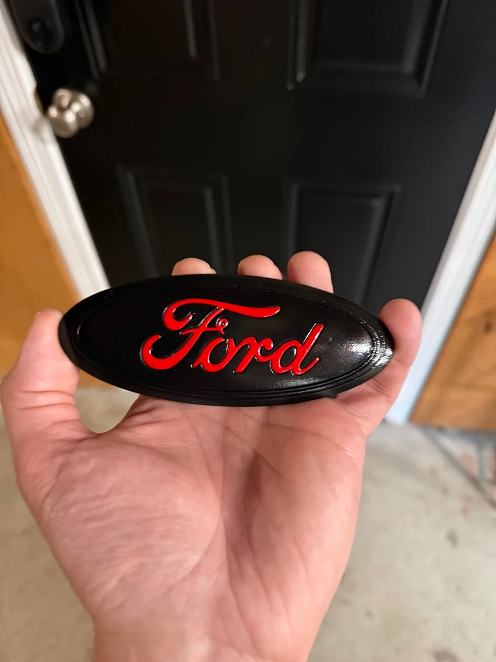

Ford F-150 Lightning Painting Tailgate Badge - Lariat Trim IMG_2311

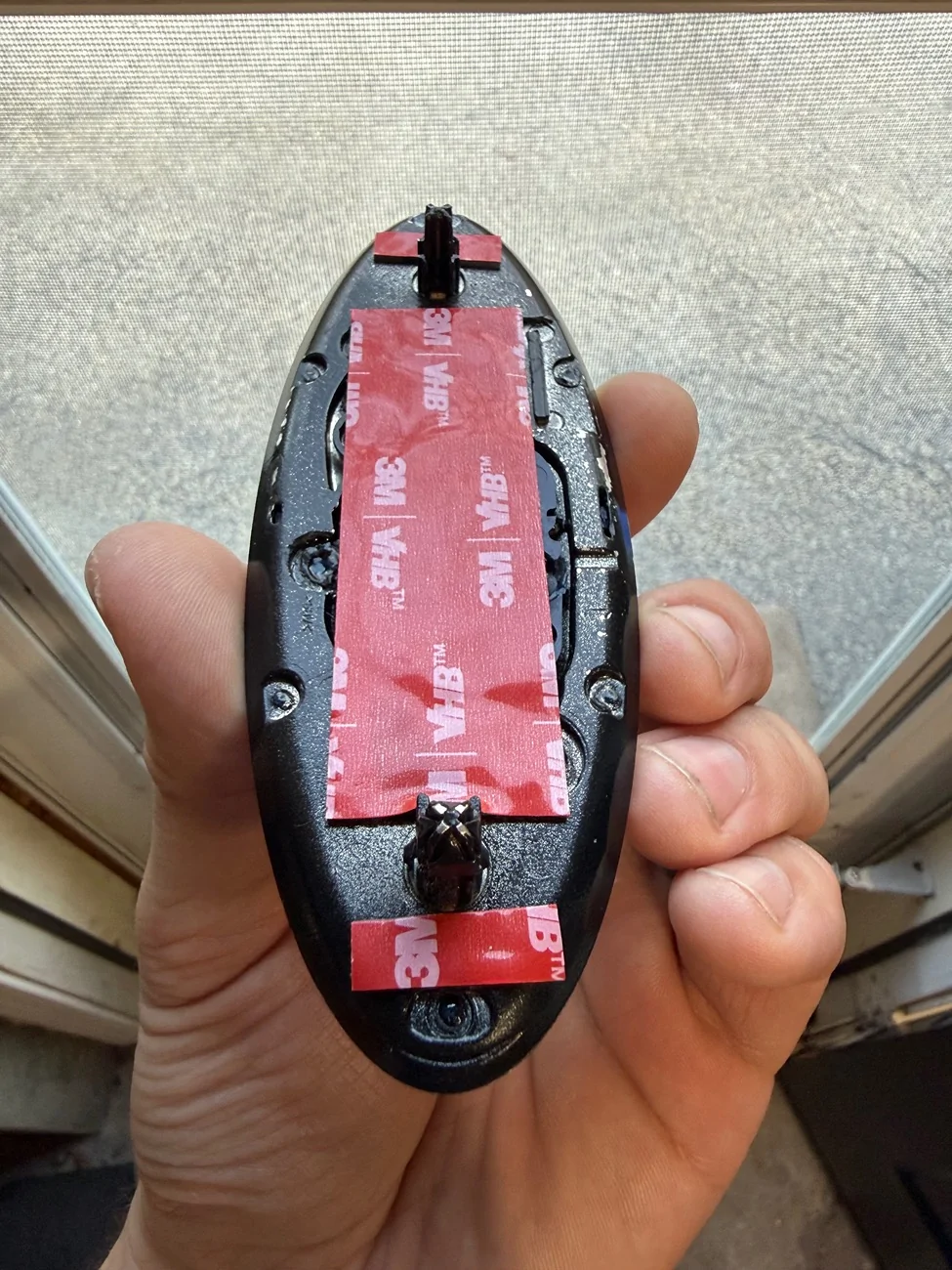

LAST STEPS:
ASSEMBLE AFTER APPLYING GLUE (watch video above)
LIGHTLY SAND BACK (where the 3M adhesive is going, clean back with isopropyl)
INSTALL
Ford F-150 Lightning Painting Tailgate Badge - Lariat Trim IMG_2313
Ford F-150 Lightning Painting Tailgate Badge - Lariat Trim IMG_2322
Ford F-150 Lightning Painting Tailgate Badge - Lariat Trim IMG_2318
