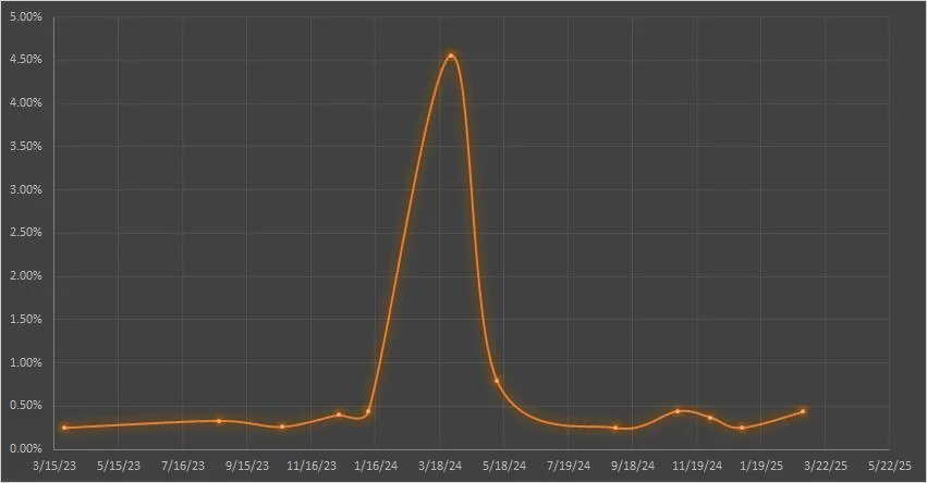

I was one of the unlucky ones that had a module go bad that required a replacement. So I monitor the HVB parameters. In particular the HVB Module Deviation %.
Here is my HVB Module Deviation showing the module going bad and then the repair.
Ford F-150 Lightning Parameters 1742915873620-57
