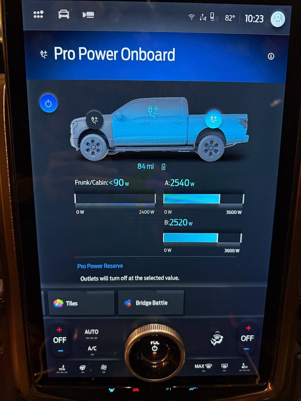

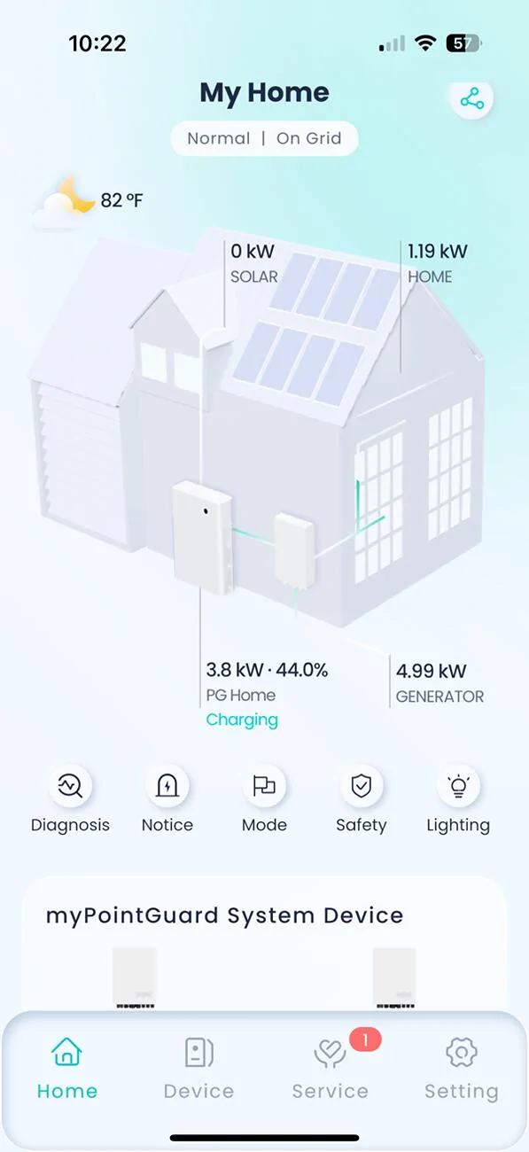

Ford F-150 Lightning PointGuard Home system with generator input (Pro Power Onboard). IMG_2518
