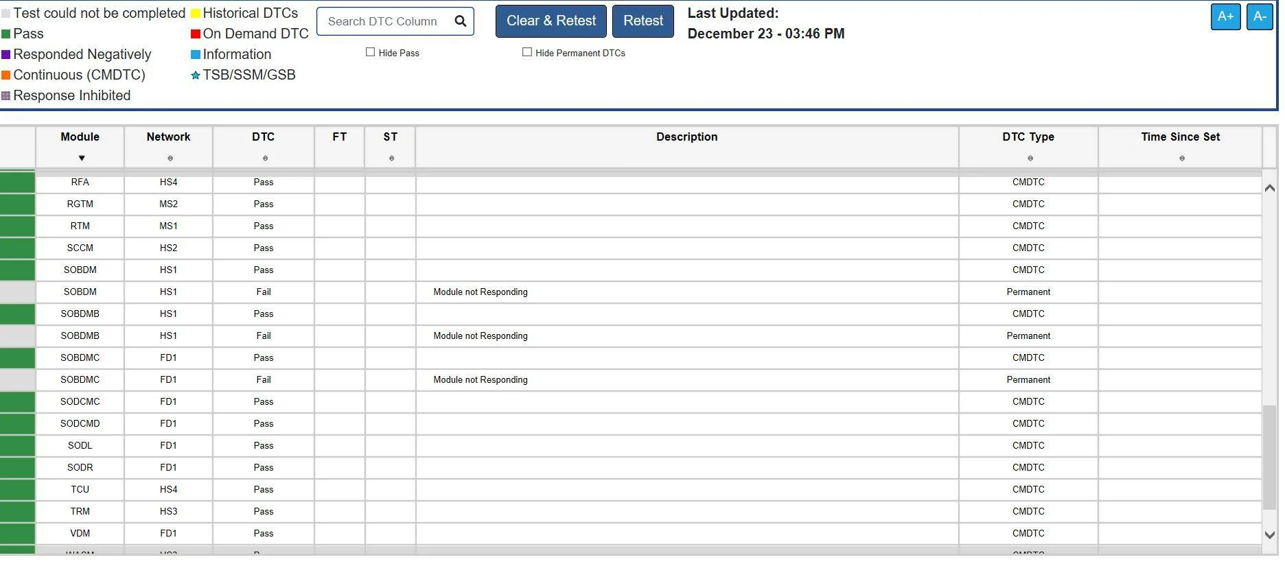

My dealer replaced the blower motor last week. Since there were updates for the mach-e and no rain today I updated the mach-e. I decided to just check the lightning. I have not seen the three errors shown in the pic.
Any advice? Note I did not run any updates today, and just ran the tests (and reran after clearing).
thanks!

It's been a while, but I think I had these error codes or maybe something similar on my first ever FDRS attempt...
IIRC, make sure you're in "key on, engine off" and run the "clear and retest" a couple of times. I remember being super panicked when I got these codes (or some similar codes) and the "fix" was a super easy misstep on my part, and repeating the "clear and retest".
Hope that helps.

I don't see any codes in your history that indicate there is an issue with the SOBDM modules. Truck seems happy and healthy from what I can see. HVAC code that was there before is gone after the dealer did their thing.

I reran the tests this morning after charging last night and all the codes are gone.
Thanks for checking for me :). Happy Holidays!
