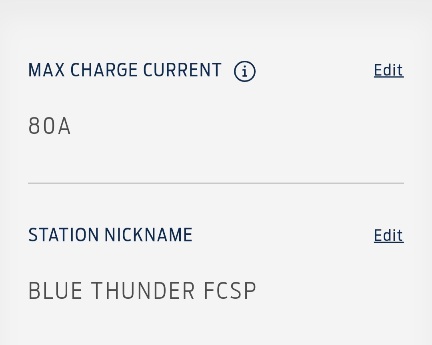

Just installed the Ford pro charger at work on a 200 amp service per directions. 100 amp breaker with 2 hots on 3awg wire and one 6awg ground. I have everything hooked up charging fine, wifi all working and added charger to app however my app is only showing 14kw charging. My battery is at 50% right now and the station shows 80amp setting in the amp. Anyone know why I would not be getting the full capability of the charger? I have the dial set to 7 for the 100 amp breaker as well so that's all good.

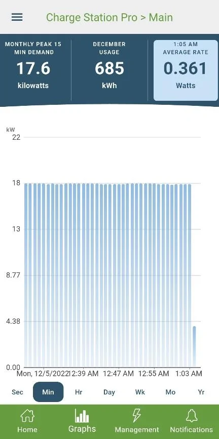

It's not just the FordPass app. I've yet to see anybody with the FCSP charge anywhere close to the full 19.2kW. Best I've ever seen is around 17.6kW.

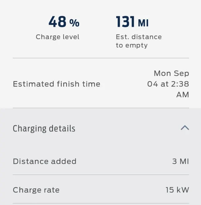

Here is the numbers I got. Best I saw this session was 17.2kW. FordPass reports it at 15kW.
Losses about what I expected. Of course, FP showing 15 could be 15.9! Thanks for the info.

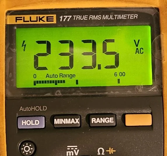

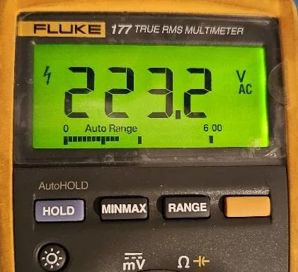

And I think I found why I'm not even getting 17.6kW anymore. When I installed my FCSP, I was reading around 238.5V on my service. I'm now reading 233.5V. And it drops to 223V when the FCSP is actively charging set to 80A. I think the transformer at the road is getting worn out.
