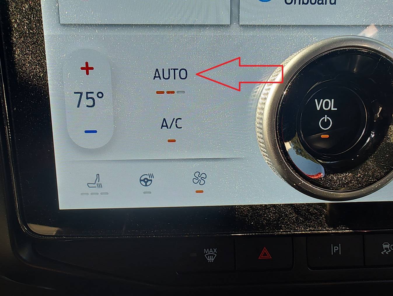

This seems off track. I am asking if there is a way to start the truck and NOT have ANY pro power or AC come on. It seems turning the fan off does the trick as far as the AC is concerned. Haven't figured out the pro power yet. Thanks for all the inputs.
108
6,756
9,214
If you open the window for Climate, you'll see OFF.
As to Pro Power, there is no Pro Power on except the in-cab outlets, and they're using no power. If the limit warning bothers you, LOWER it.
