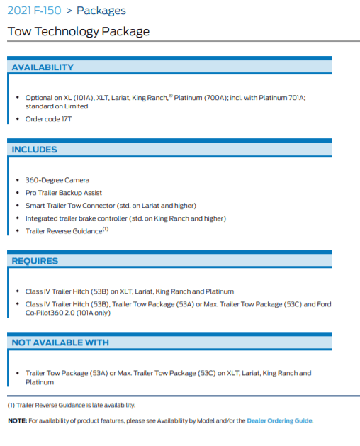

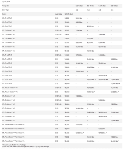

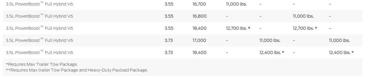

I did find the information on Ford website where it states that "Included items that must be installed. Your New Vehicle Limited Warranty may be voided with out them. For trailers over 5k pounds - Trailer Tow Package or Max Trailer Tow Package". I text a pic to my sales rep and she came back with "The 701A High" package comes with the Tow Technology Package, that brings up the tow capacity to 11k.
I also found this under the specifications. My build comes with the 3.73 Electronic Rear Axel. According to this, my tow is 11k or with Max Tow 12.4k.
Ford F-150 Lightning Question about the Towing Capacity of my Build 2021 Ford® F-150 Platinum Truck - Model Details - Specs 3-9-2021 12-49-47 PM
Ford F-150 Lightning Question about the Towing Capacity of my Build 2021 Ford® F-150 Platinum Truck - Model Details - Specs 3-9-2021 12-47-41 PM
Am I reading that correctly?
