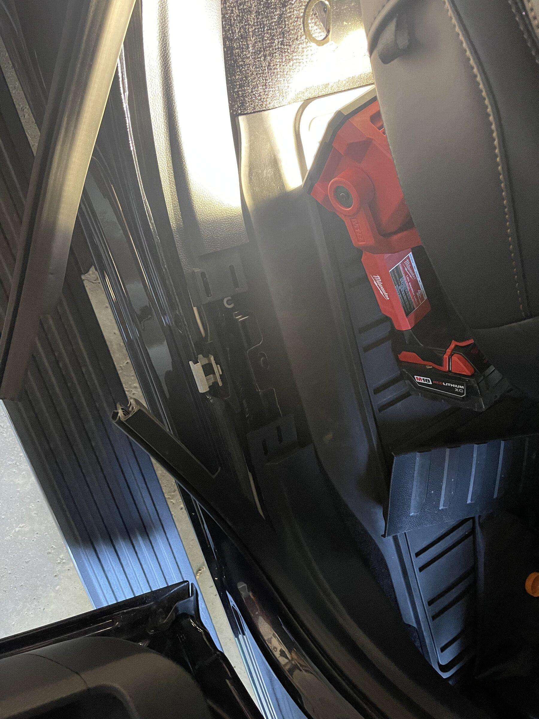

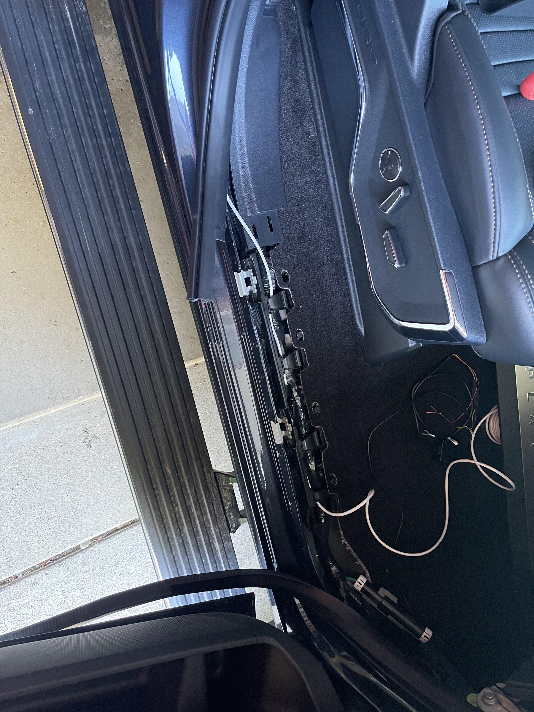

I ran mine down the passenger side of the truck below the door sill trims. I removed the two sill plates and the passenger footwell cover. That gives you enough access to run the wire all the way down to behind the rear passenger seat.

Reactions: sbi
