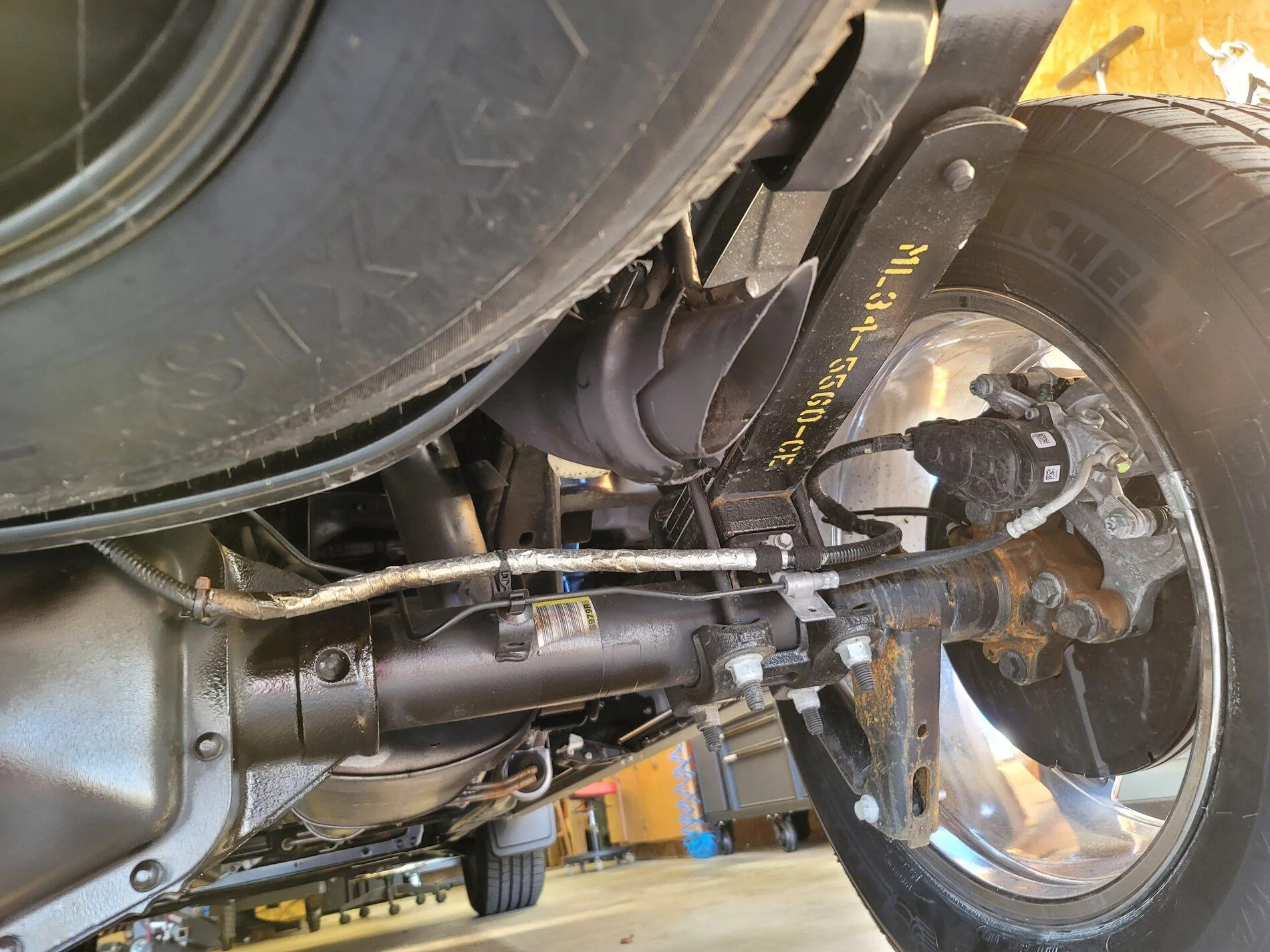

Not exactly sure how much it will lower it but I'm guessing it looks like over an inch lower. May not match front perfectly but be much less of an off balance look. Looks like all you need are some shorter u bolts.
I need to measure it. When you did you F250, I assume it is loading up the rear shocks slightly, Did it make it feel like you were riding with a rear load of weight?

I just measured and the front is 2 and 1/2 inches taller. I measure the spacer and it is 1 and 1/4 inches. So it would cut the difference in half anyway. I may put some weight in the bed and lower it that much and take a step back to look at it.

I don’t think it would change the spring arc at rest, but some blocks have a taper to them to adjust pinion angle. If there’s no taper it work fine, could require a shorter shock so they don’t bottom out?
Mine looked completely flat.
