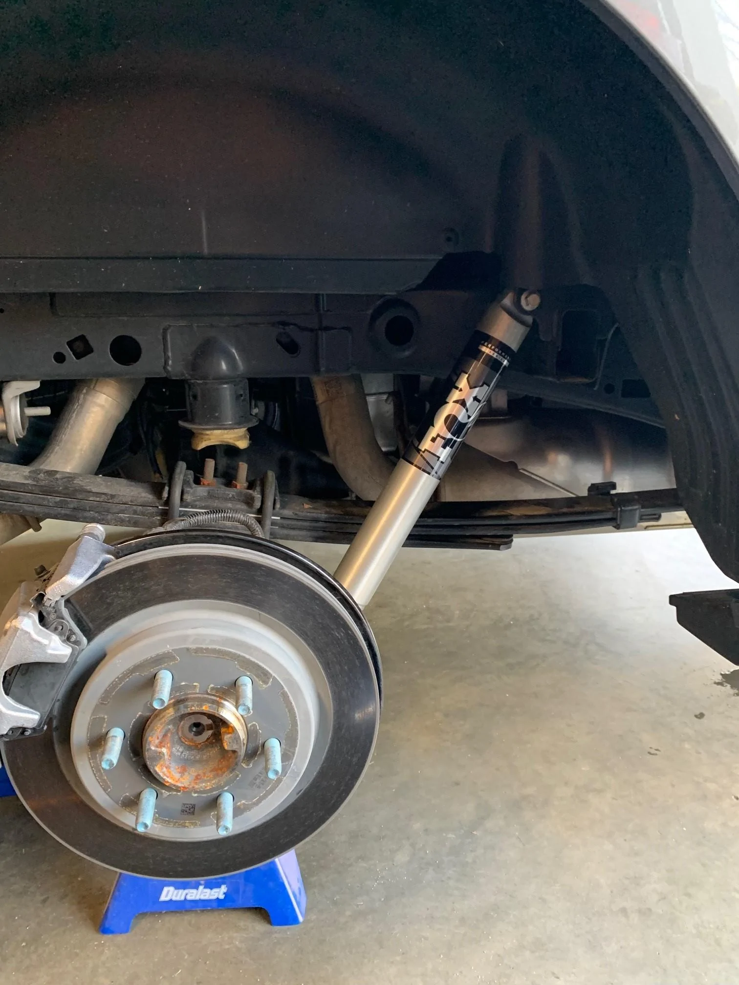

Just finished the install. Will test them later today. Here are my tips:
1. jack up on the rear axle and install jack stand. I did one side at at time.
2. remove rear wheel one side at a time (gives you way more room to work. it can certainly be done without removing the wheels but it's just harder)
3. unbolt stockers using an impact gun (15mm bolt head and 18mm nut)
4. when installing the new shocks put the bolt through the bottom eyelet first because it's easier to manipulate the top of the shock to line the bolt up. pushing from the bottom up is much harder as it's how I did the first one.
5. cut the retainer band so that the shock extends to the upper mount
6. not likely you can run the bolt through as the shock extends so plan to use both hands to pull it back down (not easy) and get the bolt ready to run it through as it extends back up while you slow it down with your other hand
7. torque to 66 ft lb
8. stand back and admire your work
