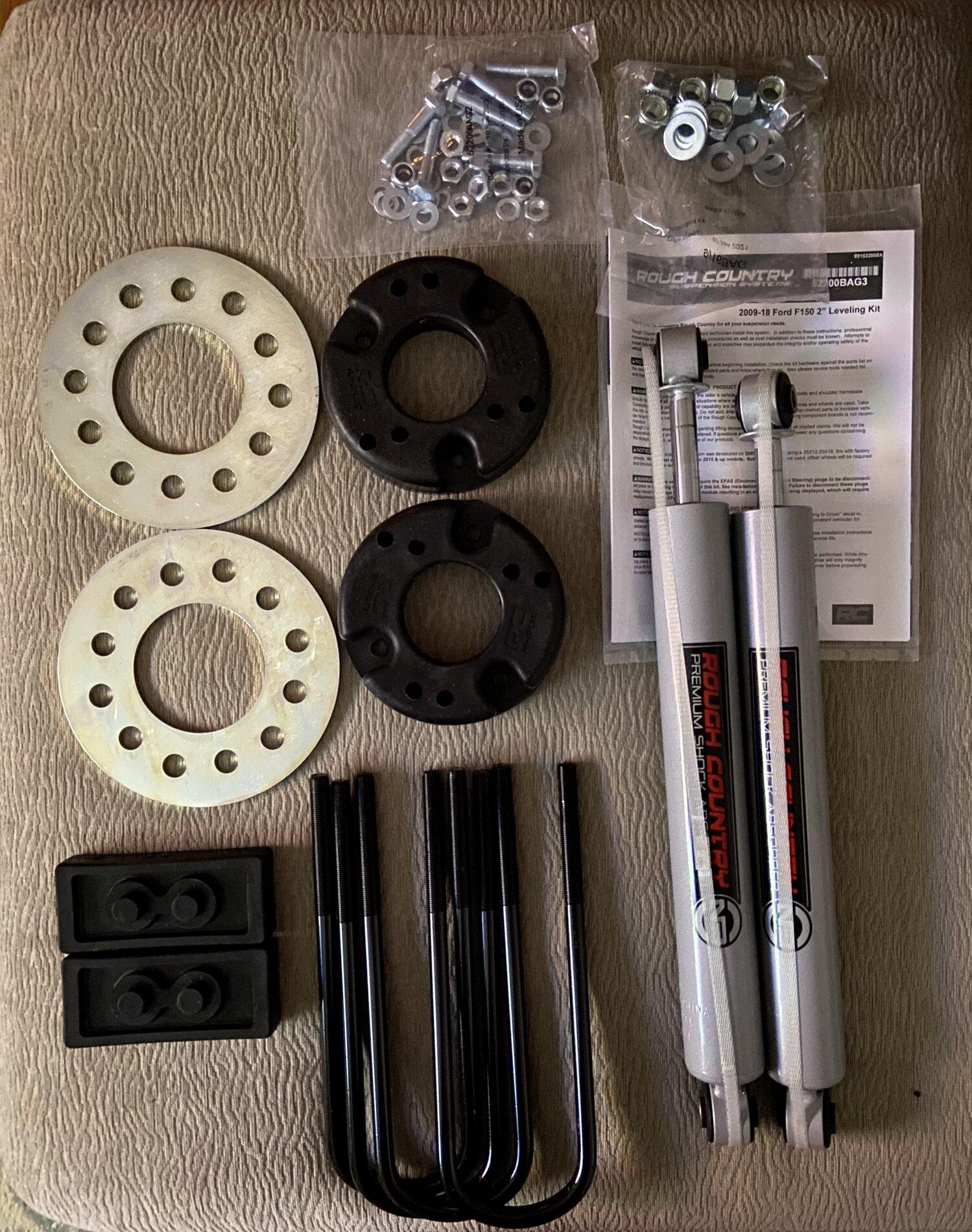

I have seen a lot of talk about the Ready Lift Level kit, but I decided to go with the Rough Country Kit because you get the front strut spacer and rear shocks for less than what the Ready Lift kit goes for.
Just wondering if anyone with a 2021 has decided to purchase this kit? If you have please post pics when you get a chance! My truck is on order so it will be some time before I get this kit installed.

Well, got my kit. Only took three days to get. Rough Country ships quick! Anyway, just wanted to post a pic of the kit itself. Still waiting on the truck before I can install it. It is the RC 2" Level with the N3 Rear Shocks and Block kit. I got the .25" wheel spacers. I don't want them sticking out past the fender well....just want them pushed out a hair.
