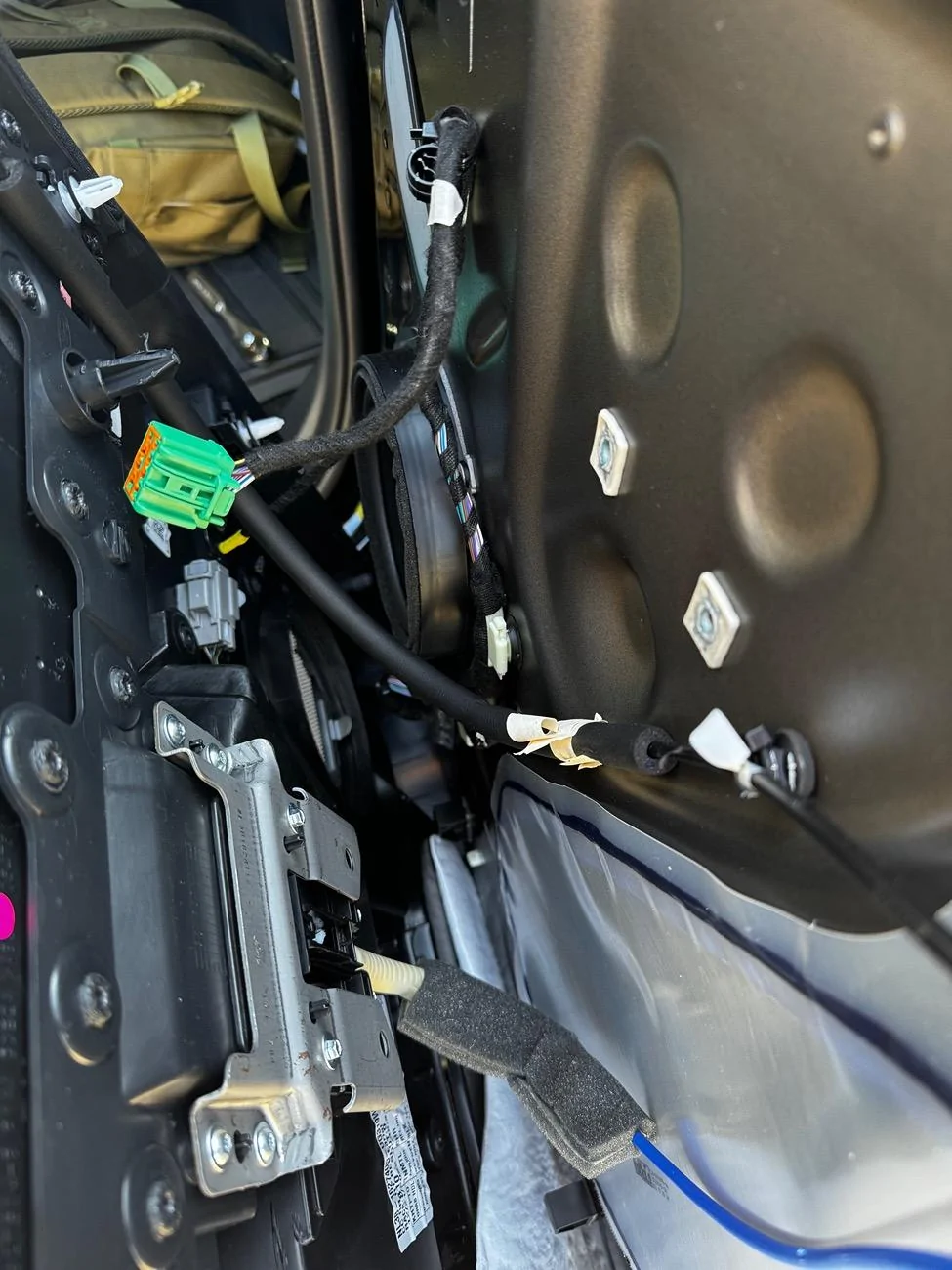

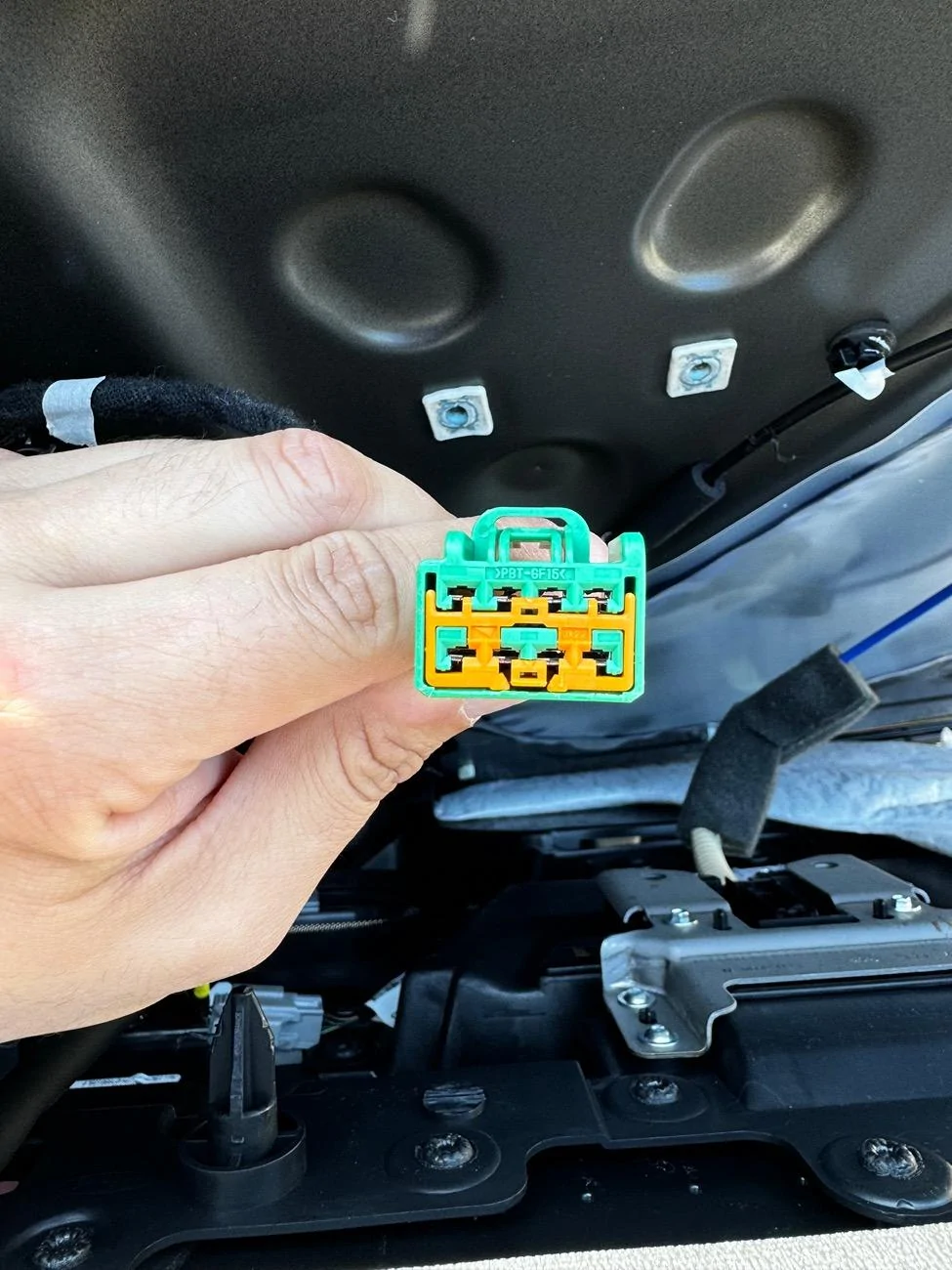

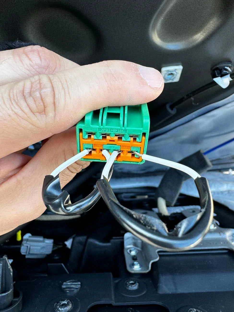

Thank you for this guide! It worked! I just need it up for now until I can get it to the dealership. Only part I didn’t do because I wasn’t sure how to was disconnect the motor. I wish there were clearer instructions on that part but for now this works.
Also, for the wire I had an old router I was going to throw away so I grabbed the power plug cable and cut it. I then stripped it down to 2 wires so I could do the trick.

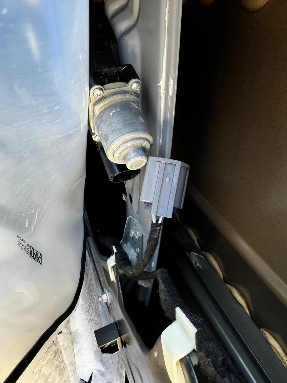

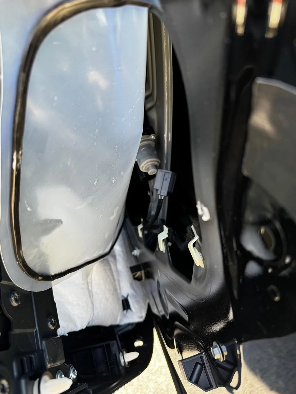

Update - I remote started the truck because it’s hot outside and all was good until I started the truck and the window rolled down again on its own. I’ll have to redo everything except this time I’ll post some pics and it’s a must to disconnect the motor. I’m just not sure where that is and what to look for.

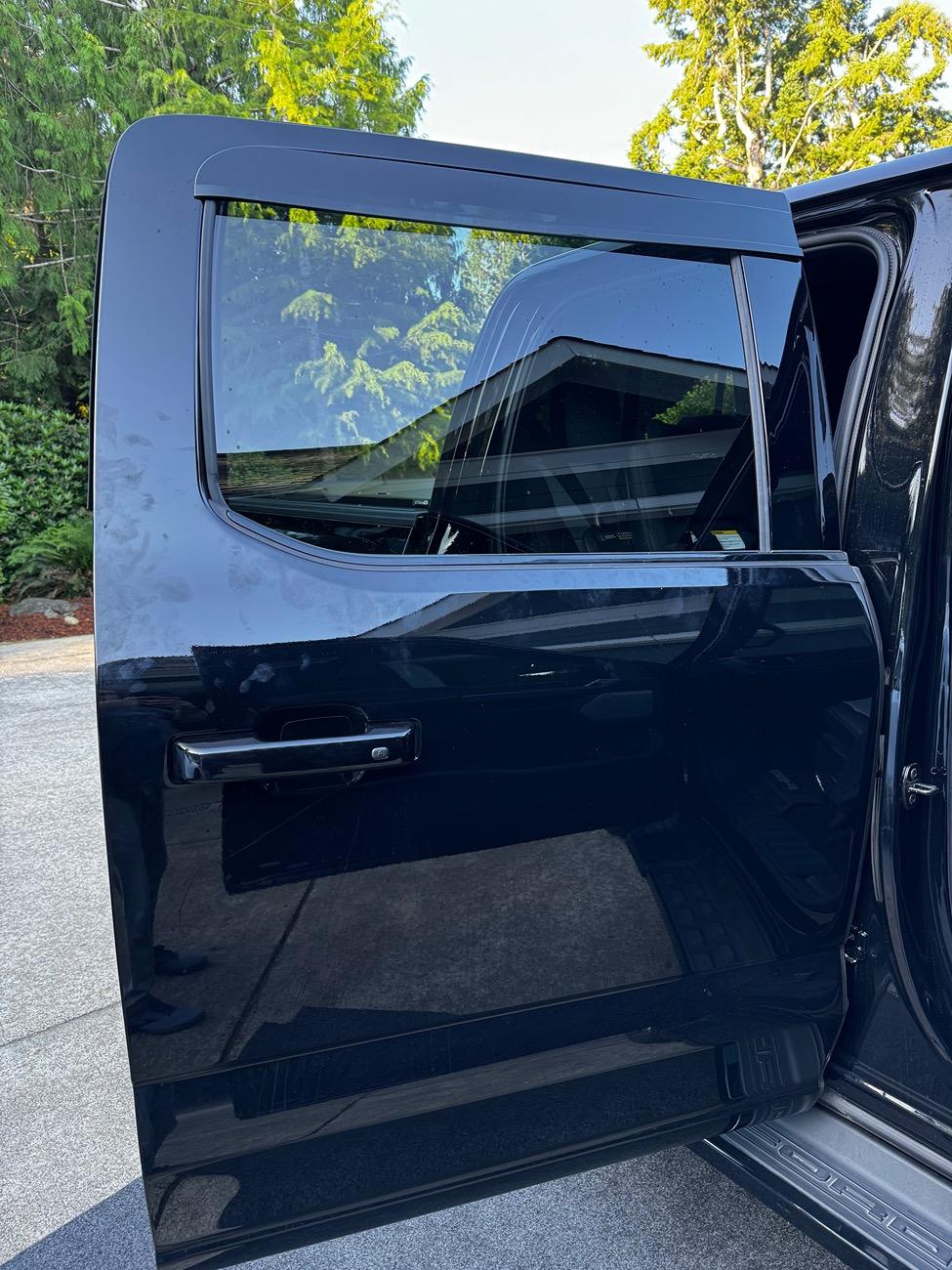

So I had to redo all the steps to make the window go back up since it rolled itself down as soon as I stated the truck. However, this time I disconnected the motor so it won’t do that again. Here’s some pics.

I have the same issue and followed the instructions and window is up. Thank you!
On one hand I’m glad you were able to get it rolled back up but on the other this is not good. I may have to carry my rig of the cables and wrench in my truck in case it happens again. I take my truck in next week to get serviced we’ll see what they officially diagnose.
