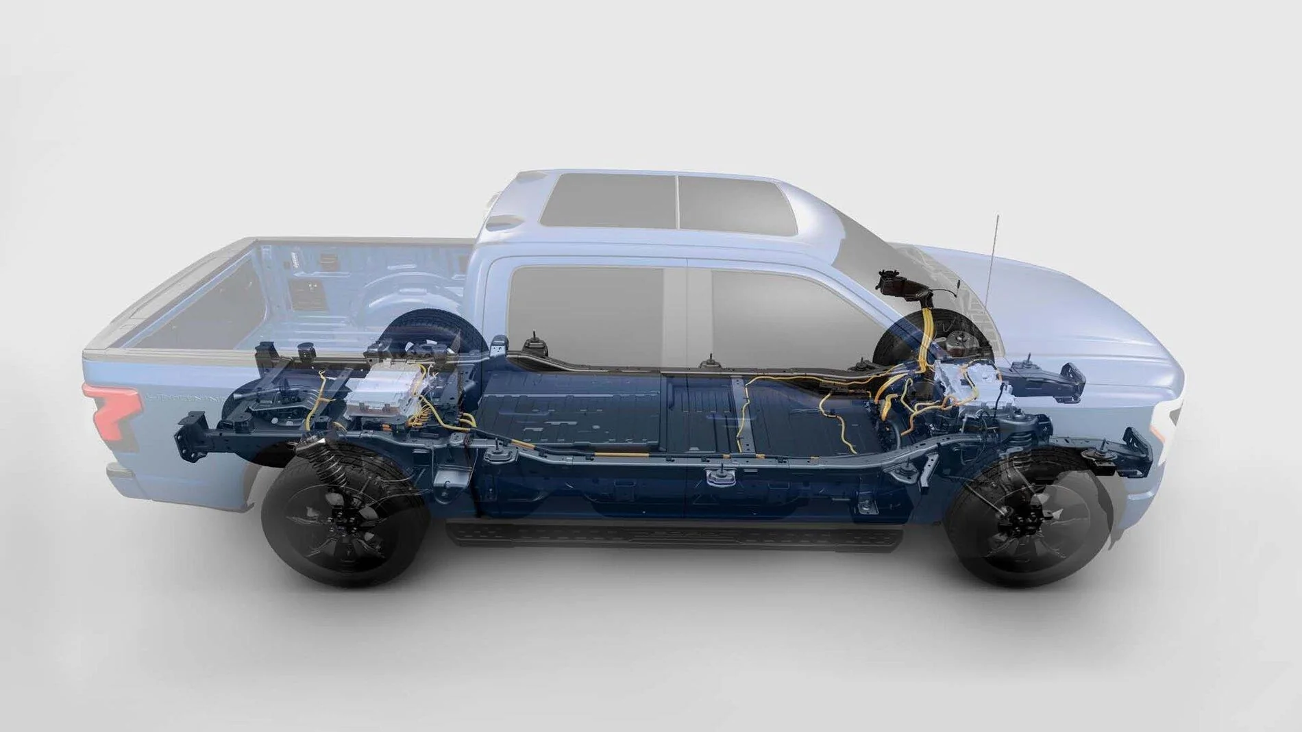

I think the most adventurous part for me is going to be getting the fifth wheel hitch installed, just because the frame design is different from the ICE/Hybrid F-150.
The electric part of it I’m honestly not too concerned about. Plan on range being cut by 50% and I shouldn’t be disappointed. I’m sure trying to DC fast charge with a trailer attached might get interesting, but I’ve had quite a few interesting experiences over the years getting into gas stations with the trailer attached too.
The fifth wheel question is one that you really need to investigate. The hitch plate needs to be mounted over the rear axle, which is right over the rear electric motor mount cage. Look closely at the published cut-away pictures. Will there be any third-party manufacturers willing to market what you need and how would this affect warranties? Given the tight space under how easy would installation be?
I've reached out to B&W Hitches and they aren't sure if they can do it or not, only because they haven't seen the actual truck. Meaning hands on. I am confident they can do it, mostly because I really need a goose neck hitch.
Probably the only good thing to come from my late reservation is someone else will likely try this before I get my truck. :cool:
Pin weight on any 5th wheel is going to exceed the payload of a lightning. I wouldn't try to pull a 5th wheel with any 1/2 ton in the first place.
I think the bigger problem will be that the 5th wheel will almost guarantee you will be over payload. Ford is shooting for 2k and if they can hit it that will be on a base model. Add options and you will eat that up fast. I would bet most will have a payload of 1500-1600. Take a small 5th wheel with a GVW of 7500 - 23% you are at a pin weight of over 1700 and now you have to add people and stuff in the truck.
