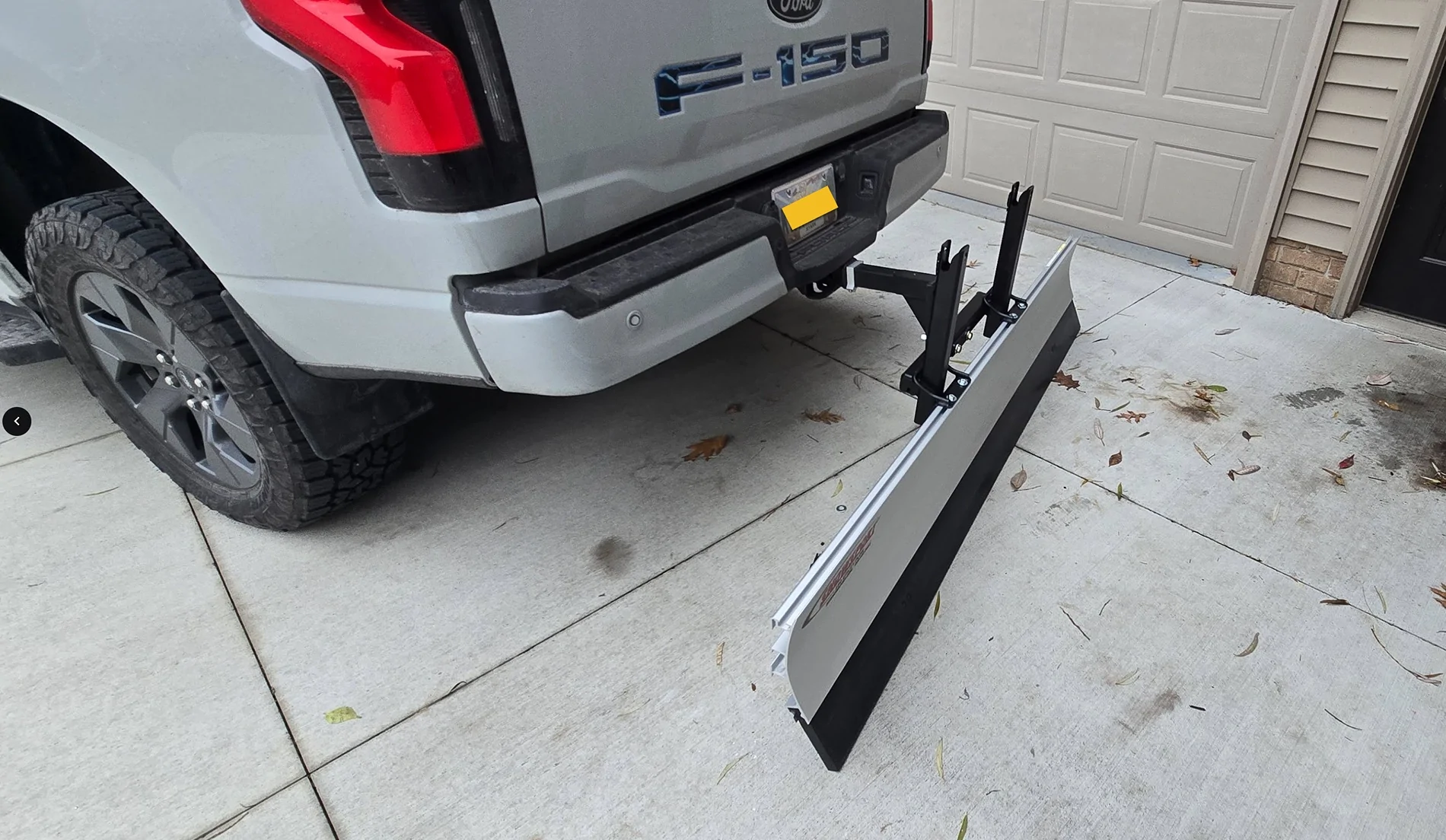

Worked great! Most I did was about 8 inches. Any Morten than that it would have probably dumped over the top of the plow.

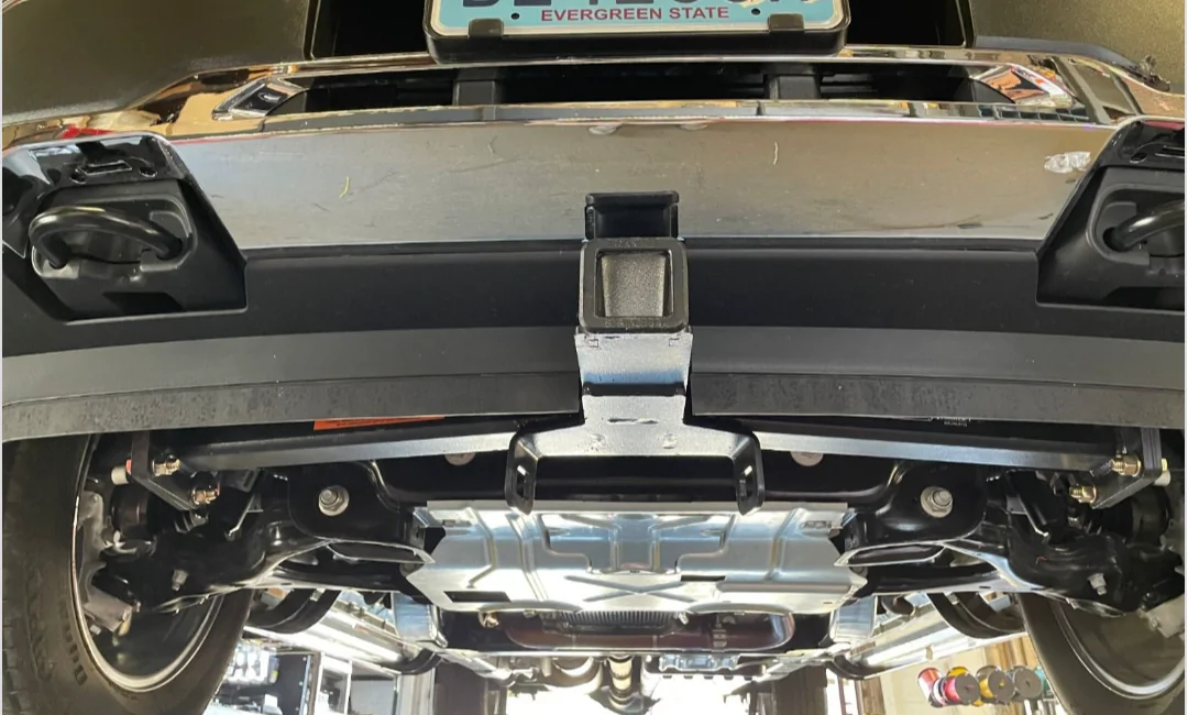

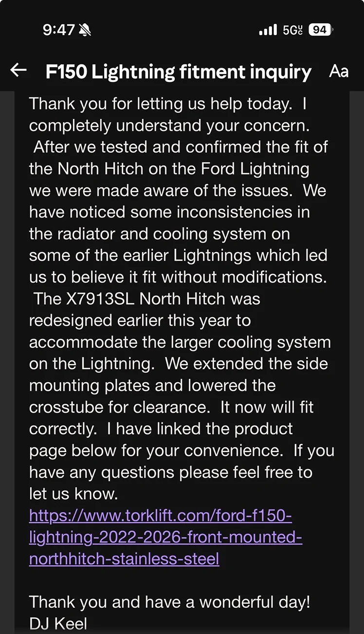

Just double checking everything: No modifications needed ,besides the air dam, to fit the TorkLift on the truck?
A user here claims the TorkLift doesnt fit the truck:
Ford Lightning Meyer Wingman Snow Plow Review (Yes, a real commercial-grade front plow) | Ford Lightning Forum For F-150 Lightning EV Pickup: News, Owners, Discussions, Community
" I mounted a Draw-Tite Front Mount Trailer Hitch 2 Inch Receiver – Part Number 65067. There are other front hitches that say they are compatible with a F-150 Lightning (such as Torklift) but the Draw-Tite 65067 is the only one I have found that actually fits. (I had to send the Torklift front hitch back.) "
I dont want to make an expensive mistake here.

Forgot to post this here also. That answers that.
Ford F-150 Lightning Snowsport 180 utility plow? IMG_1387

Also I was reading that there are two air dams on this truck. I see people have notched the front one, what about the motorized one? Did that need removal for the snowsport to fit?
