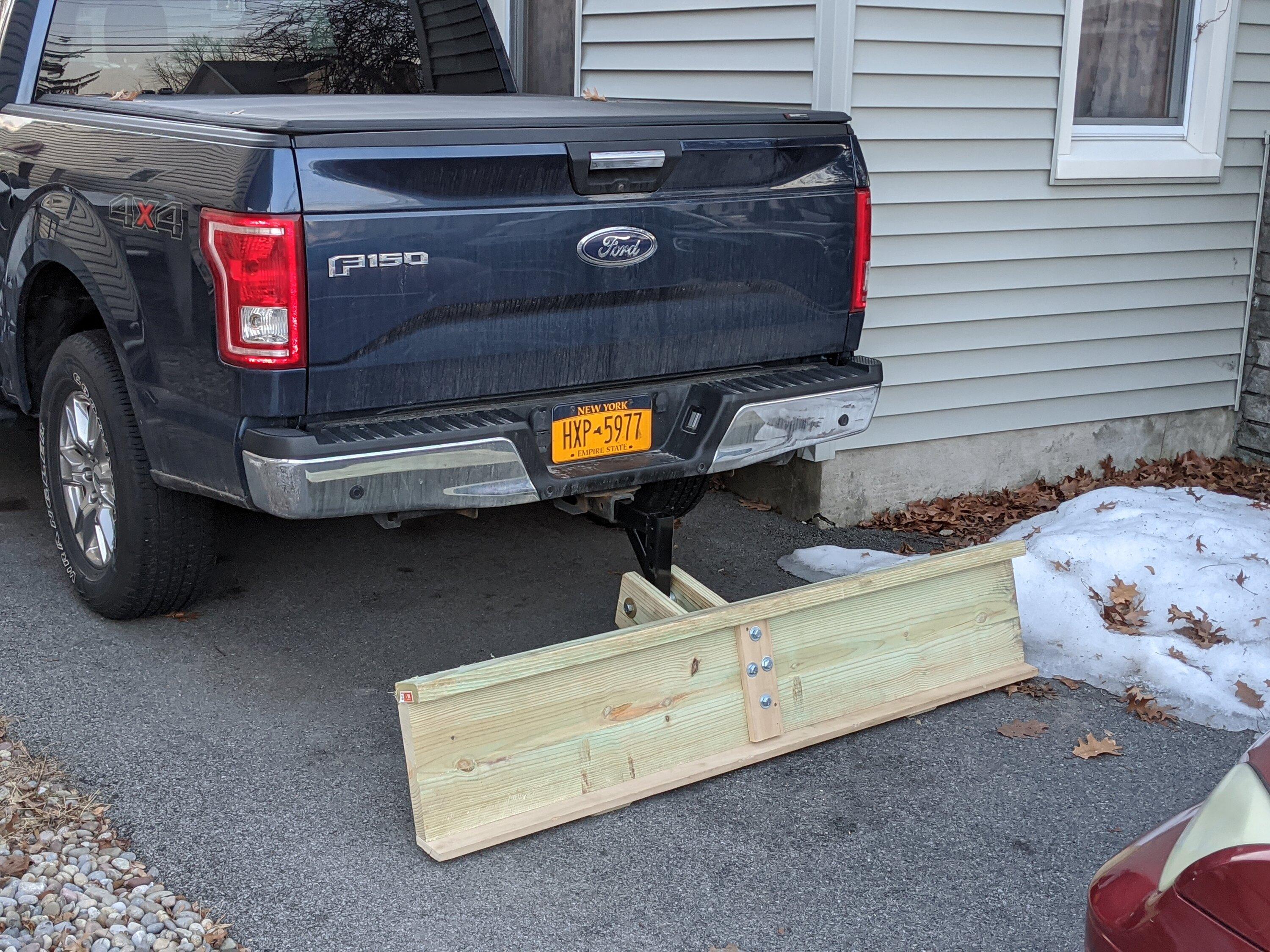

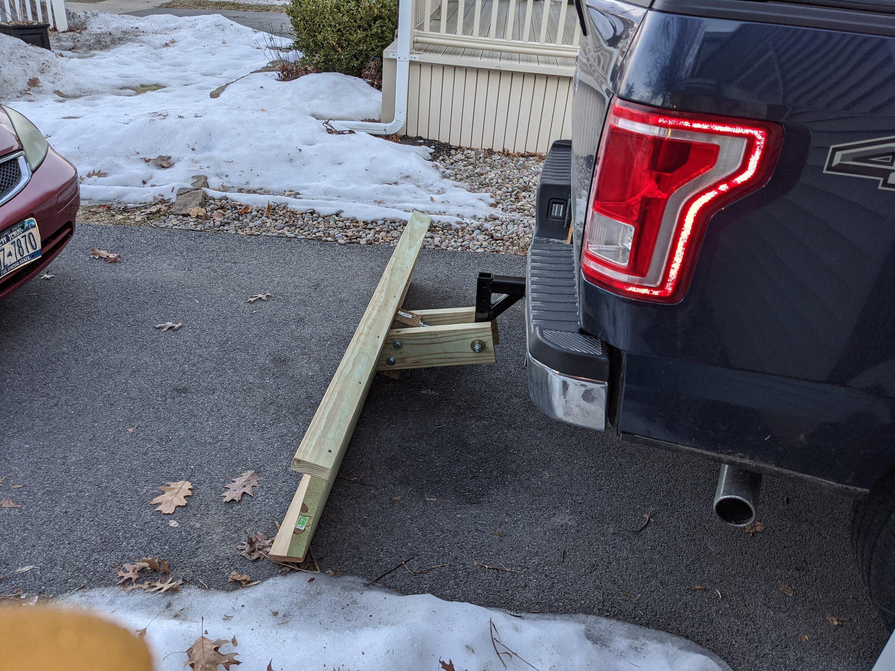

From what I can see, it would need to remove some shrouding below as well. I ended up going with a backblade pull plow.
I have a DIY built wooden back blade (push) that covers what I need for my driveway.
For us southerners, I would love to see a picture of a wooden DIY back blade, whatever that means :)
Here you go, this is my old truck though.

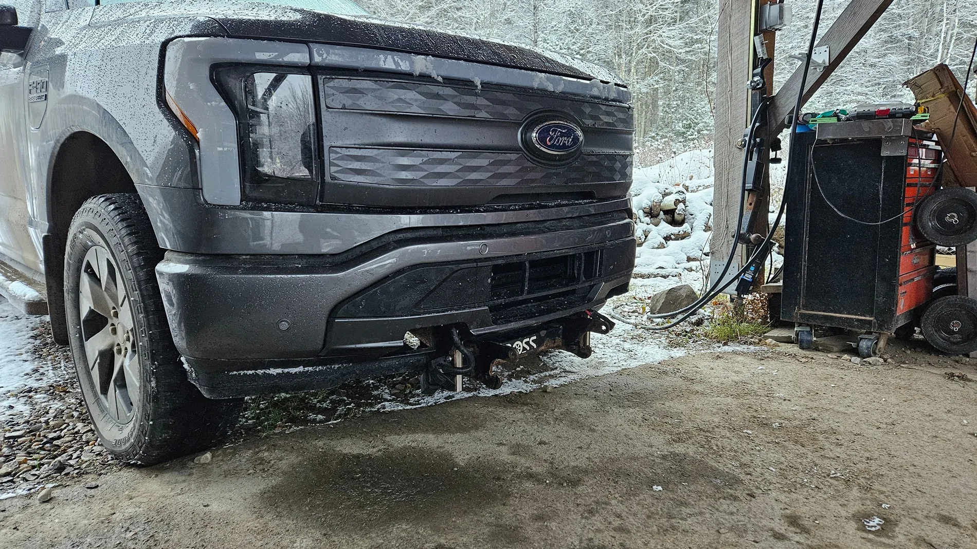

7'6" BOSS HTX on a '22. Works well with full hydraulics despite no mods to electrical capacity. I added a SuperDuty six switch overhead console to enable plow relays and directly control the plow high and low beams. I did not mess with the factory lights, just augment the headlights and do not use plow turn signals.
This week my wife and I plowed out 8-12" across two storms from a half mile driveway/access, seven offshoot driveways and two small parking lots. Also cleared part of the local roads: 4-6" at 40 mph.
Truck does truck things, but we must charge up all the way every night since this is a standard battery.
