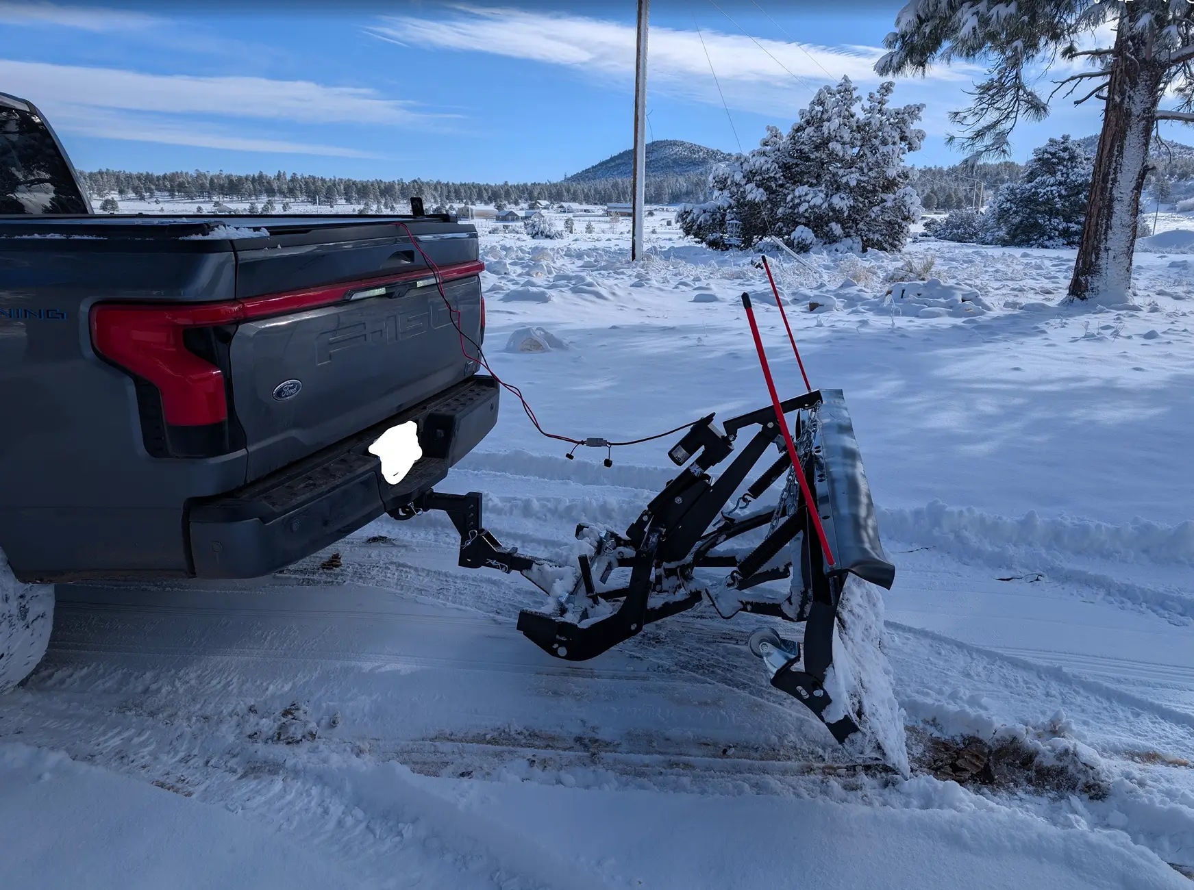

My plow is a bit heavier than the others in this thread. But it works fine. I still need to dial in my sight lines so I have a better feel for the blade’s height.

What plow is this?

DK2 82” x 19” with the linear actuator lift instead of the winch.
It’s a heavy plow.
But we can get 3-6 feet in a storm and I needed something that I could use over a 2-mile gravel road if necessary.
I would have preferred to install on the front, but I’m not going to modify the front until the Lightning is out of warranty.

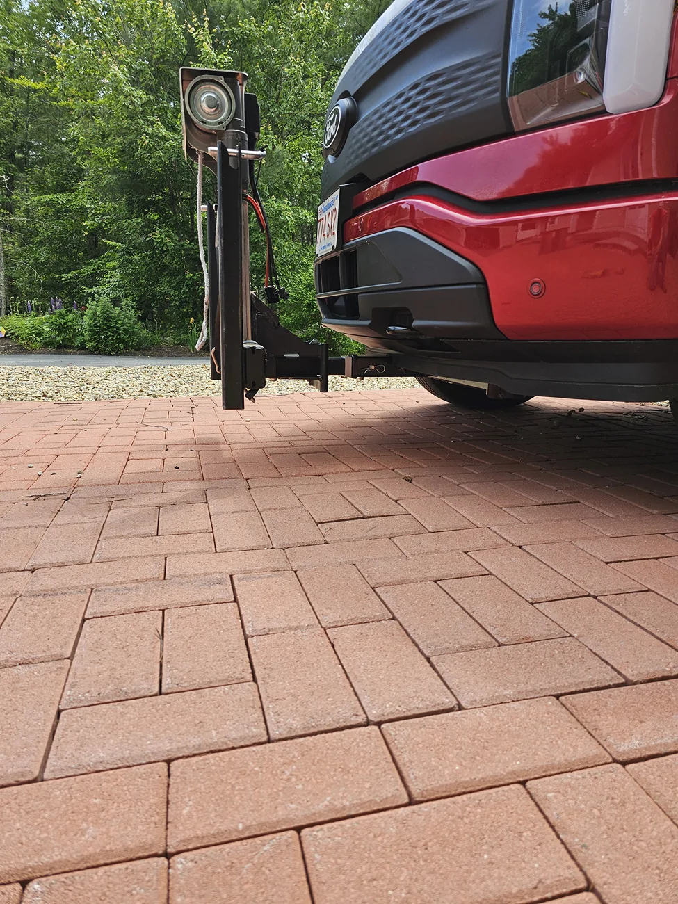

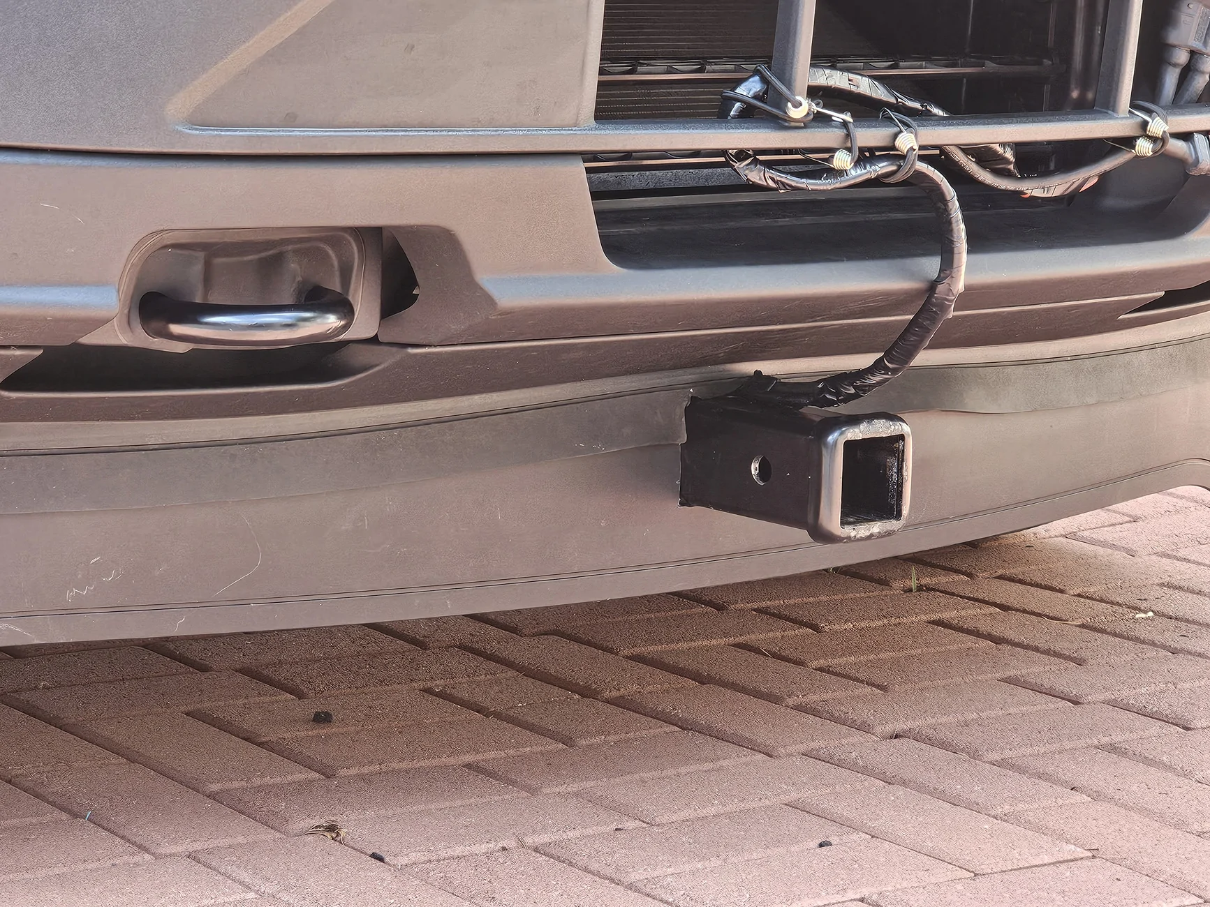

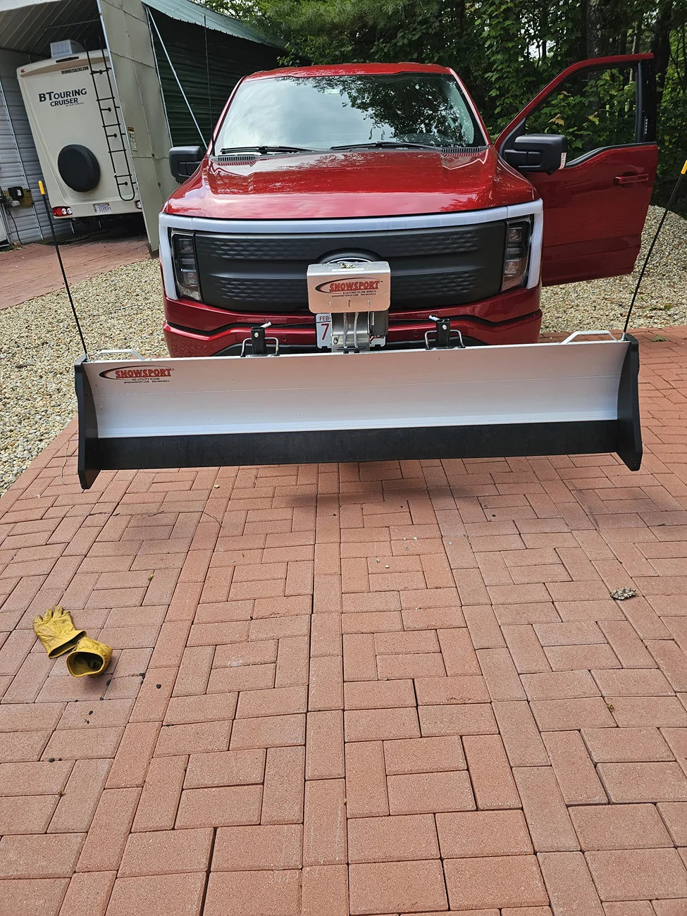

I found a standard front hitch bolts on fine to my 24 lightning. I cut a hole in the front deployable air dam and created brackets so it is permanantly in the down position. Yes less clearance but not any less clearance than fischer plow mounts I have seen on other F150s. I just unbolted the movable section of the plastic air dam and when the truck tries to extend the air dam, the moving brackes clear the fix dam now in place.

Do you have a link? Or did I miss that in the thread?
I would prefer to have the hitch on the front of the truck.

This looks fantastic, great work. Just a follow up; how did this work in the winter during our 12 inch storm? Im nearby in NH, need something reliable that gets the job done. Been looking at this plow as an option.
Worked great! Most I did was about 8 inches. Any Morten than that it would have probably dumped over the top of the plow.
