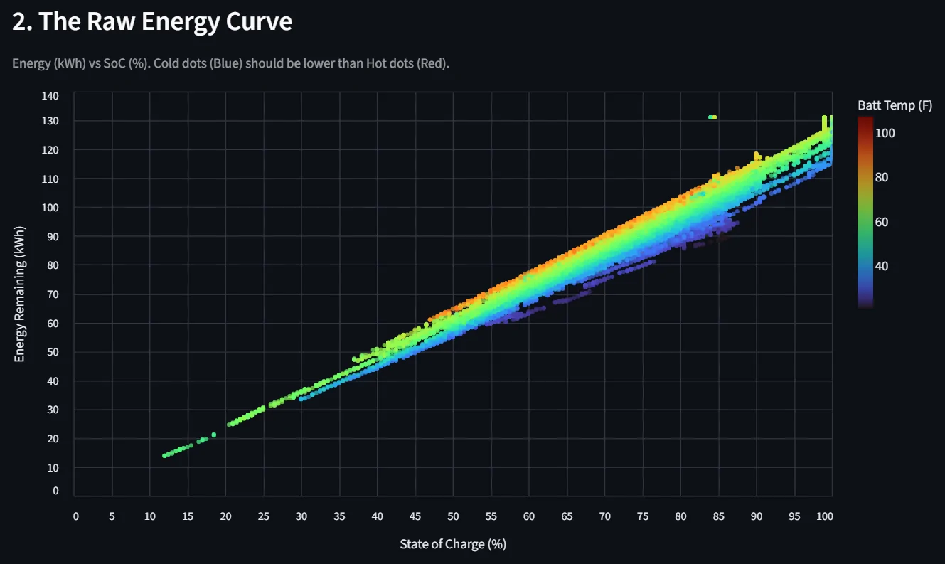

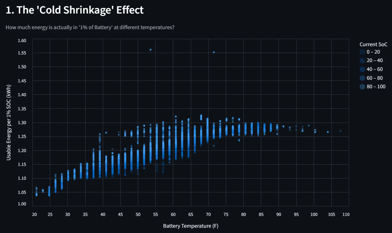

With the Lightning, this ratio is not linear. At the low end of SOC, the GOM would climb less than 1 km for each percentage of SOC climb. As the battery charged, each percentage increase would add a bit more to the GOM than it did earlier. I recall the Lightning showing something like 23 km when the SOC was 25%, but by 40%, the GOM showed about 52 km. As I write this, the Lightning is at 99% SOC and the GOM shows 175 km.
I suspect that this has something to do with displayed vs real SOC and also displayed SOC vs GOM.
Many systems for measuring SOC are effectively coulombmeters: they are measuring amp seconds in vs amp seconds out. One reason that a simple voltage measurement (as an indicator of SOC) does not work well for any of the lithium batteries is that the voltage/charge level is not linear (although it is pretty close much of the time). Amp seconds in vs amp seconds out works pretty well, by comparison.
Even though the voltage/charge level curve is not linear, it is nevertheless fairly flat, with the voltage for a 90% charged lifepo cell being, say 3.35 per cell and 20% being 3.20. So it is easy to ignore that difference, and just use amp seconds in versus out. Doing so gets you close enough in most cases. I have an electric outboard motor which is equipped with a coulombmeter, and it works very well for its intended purpose.
However, power is measured in watts (amps * volts) and the truck's ability to do work requires watt seconds. I wonder if the Ford SOC indication is really correct. Clearly there is some math missing, because 10% soc difference at low charge and higher charge should get you exactly the same amount of work accomplished.
Of course, the conservatism of the GOM when charge is low, could just be programmed in to make it less likely that people get stranded.
