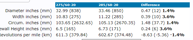

We see discussion on this forum about folks using FORScan or having their dealership recalibrate their truck's speedometer after changing to larger wheels/tires. Vehicles used to have a mechanical connection cable between the transmission and the speedo, so any change in diameter would alter the speedo and odometer accuracy, but most modern cars use electronic sensors, correct?
I put Michelin Agilis LT 285/60R-20's on my KR Power Boost, replacing the OEM Pirelli Scorpions 275/60R20's. The original tires were 33" and the replacements are 33.5". The new tires are much heavier (57 lbs) as actual truck tires, needed for heavy towing, compared to 38 lbs for the tires I took off. Weight isn't part of this issue, but just noted as I was looking at this question - and a key reason my empty MPG has dropped from 23.9 to 20.9.
The change in tire diameter resulted in a new circumference 105.24" or a 1.51% increase over the 103.67" circumference for the OEM tires.
Given the discussions here about folks working to dial in their speedometers, I expected my speedo to be off after changing tires. However, using GPS (either google maps or Waze), my speedometer was dead on accurate before putting on the larger tires, and remains accurate to the exact GPS-indicated miles per hour afterwards. So what's up with this issue? Is it just a problem for models without NAV systems?

Our trucks transmissions have an output shaft speed sensor. With the “known” data that is programmed into our trucks through witchcraft (axle ratio and tire circumference) the vehicle speed is calculated. Not through satellite or gps.
I just don’t think jumping only a half inch in diameter on your rig is going to show a drastic change like some of the guys running bigger setups.

Okay - but I would have thought it would be off by 1 mph if originally accurate, and I increase the distance per wheel revolution 1.5% (making my speedo read too slow and odo run low). Doesn't seem the case, but I accept your explanation.
