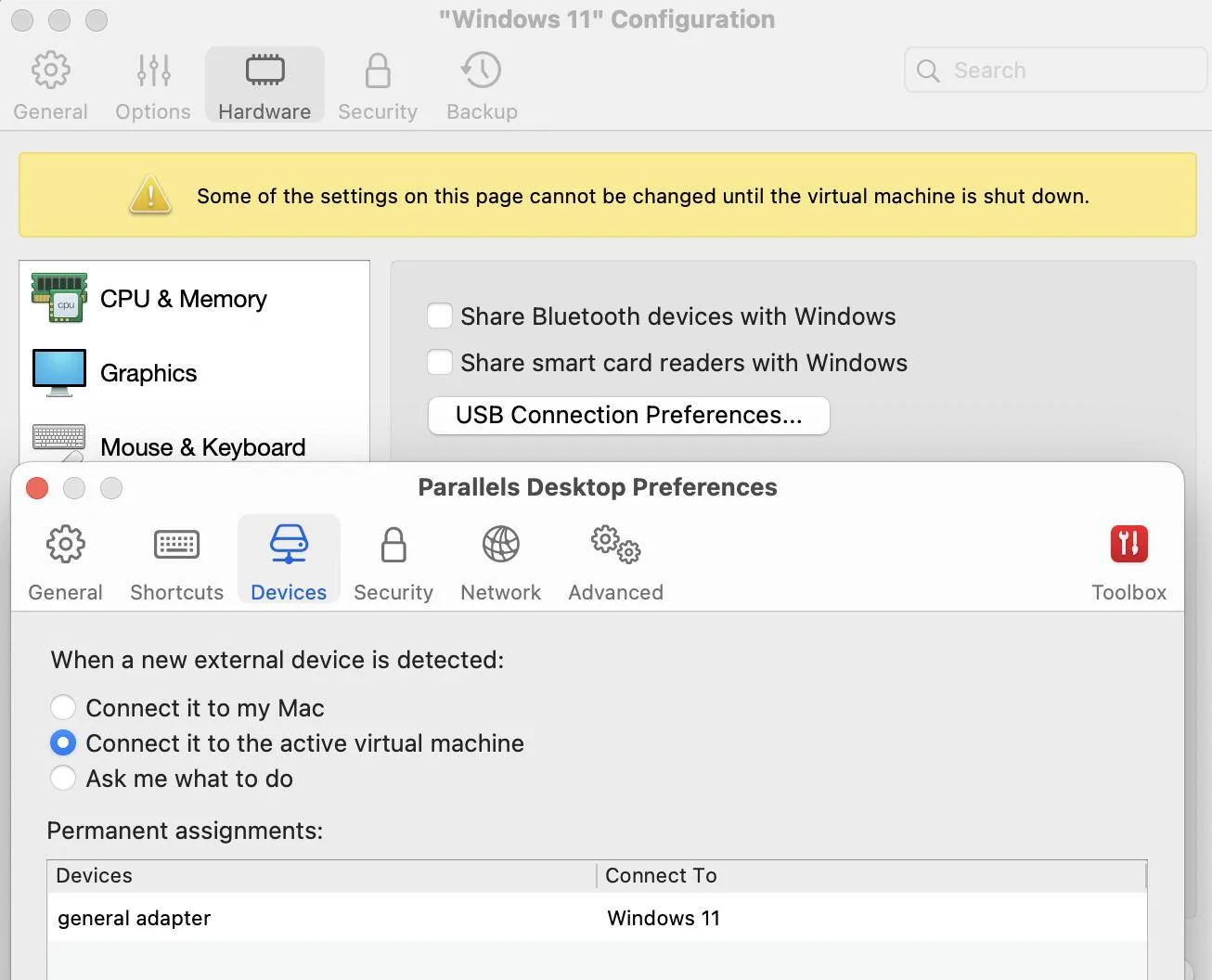

      1. Setup to mount in VM
    2. Disable Bluetooth sharing from Mac to VM (Parallels only - may not be required)

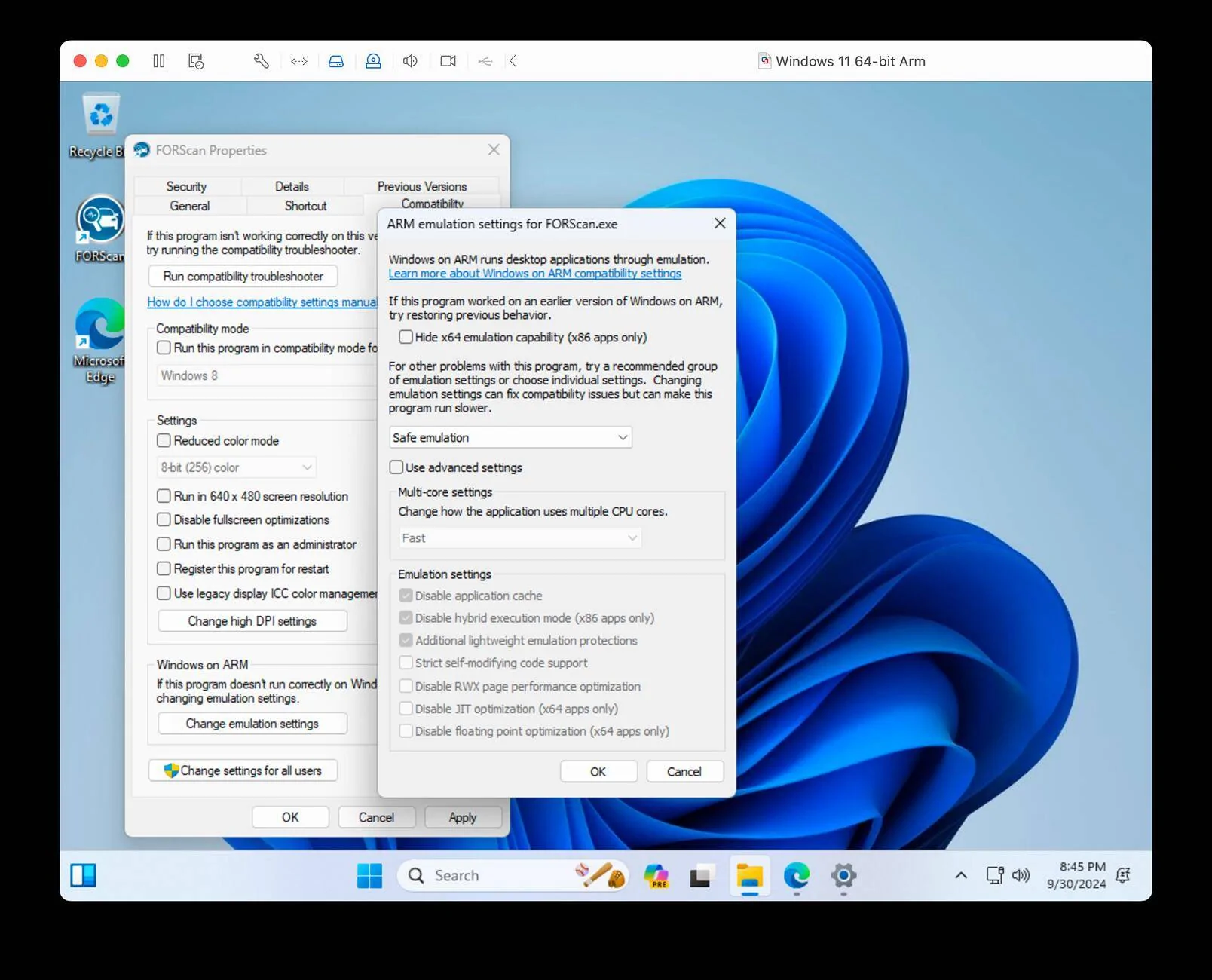

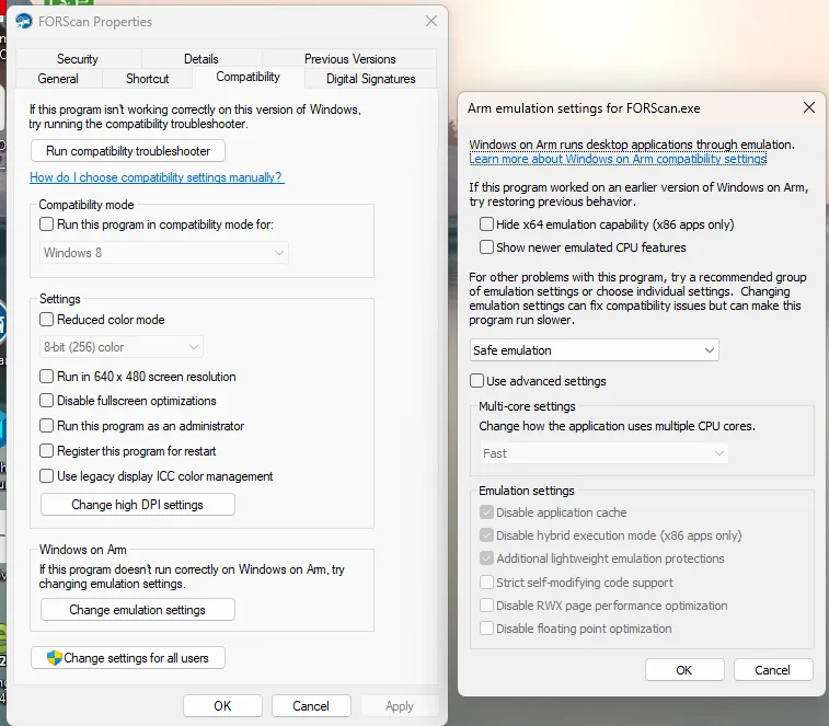

    2. Setup in"Safe Emulation" mode

FORScan does not support ARM Windows so you need to run FORScan in ARM "safe emulation" mode.

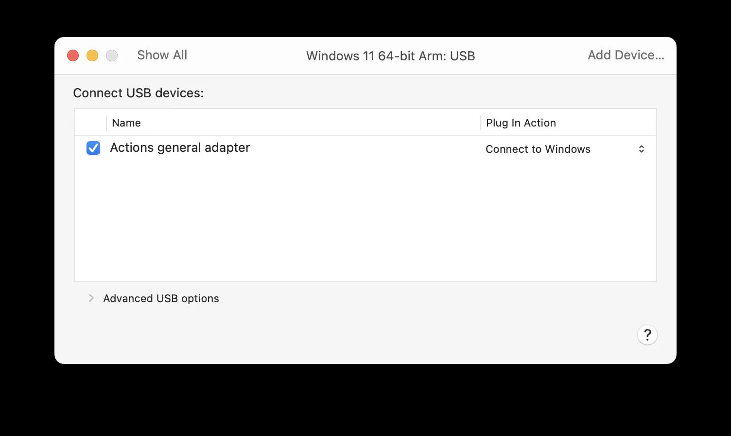

If using VMWare, you can Install VMWare Tools for more options like better resolution support and copy/paste between host/guest.
Auto-connect USB Dongle to VM - Parallels
Ford F-150 Lightning FORScan with Apple Silicon Mac, VMWare/Parallels, OBDLink MX+ & USB Bluetooth Dongle 1727922479065-mi
Auto-connect USB Dongle to VM - VMWare

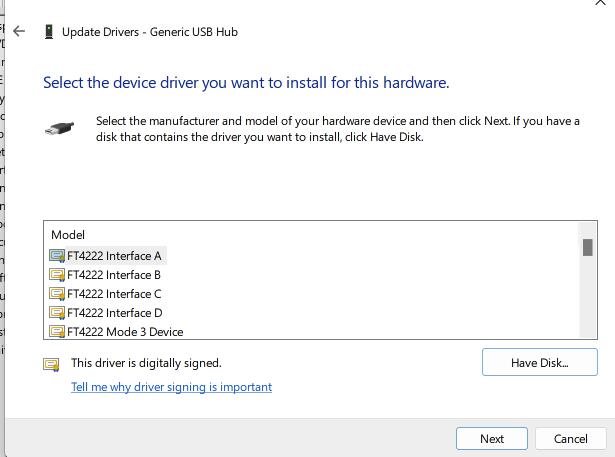

I've done that. When I go to select the FTDIBus.inf, instead of automatically installing the correct driver, it asks what I want to install and then says it can't start correctly. I have to be missing something because when I plug in the usb, it doesn't show under COM pots in device manager either, just Generic USB Hub under USB Controllers. None of the options in the attached picture work for me. I promise I've followed the FTDI's instructions as best possible. This ELM327 adapter I've had for a while and works perfectly fine with native Windows machines.
