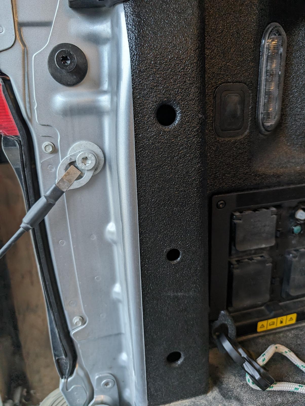

What are the holes on the stake pocket for? What fastener might work best to attach something using the hole? Do some aftermarket devices attach there, bed extender?

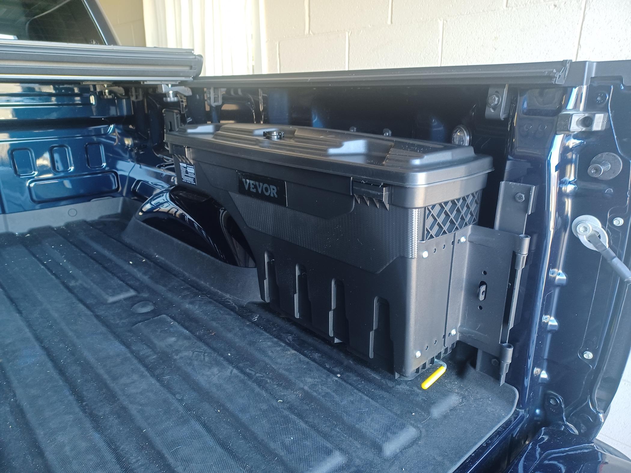

What kind of fasteners were used to attach the hinge pin plate for the toolbox?

Bolts, with nuts and washers, you have to remove the taillight to access the backside. These holes are just simple holes for bolting in accessories.

This is what I order the box is very nice, holds tools, hitches, straps, rope, bungee cords, and extra towels and gloves.
As the reviews note, the bracket ok the bed is not perfect aligned. It is easy to bend a bit and open up the holes for some adjustment with minimal effort. Took me less then 20 min to install this.
VEVOR Truck Bed Storage Box, Complete Bolt Accessory Kit, Lockable Swing Case with Password Padlock, 6.6 Gal/25 L ABS Wheel Well Tool Box, Compatible with Ford F-150 2015-2021, Drivers Side https://a.co/d/8vds2DK
