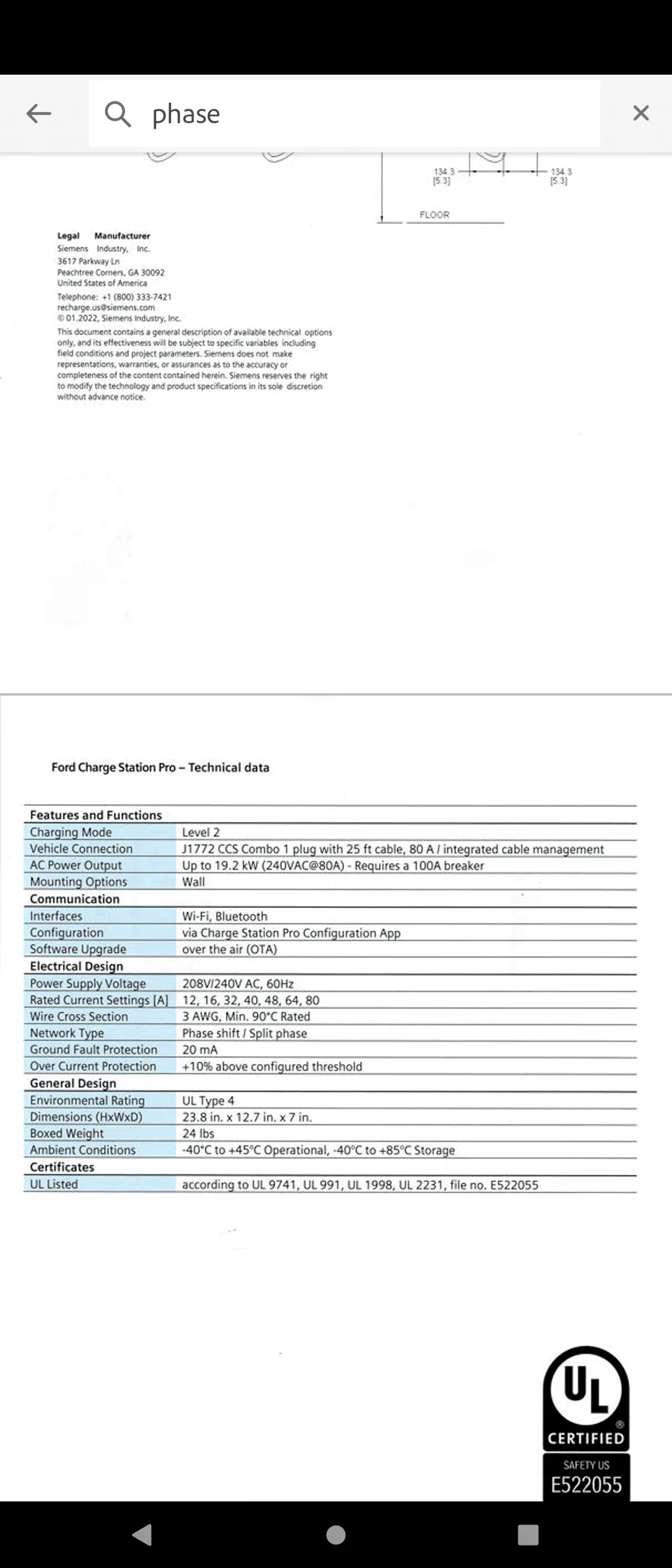

Fcsp will work with 208. From the back of the manual.
VTbuckeye Well-known member First Name Joseph Joined Jan 15, 2022 Threads 5 Messages 963 Reaction score 926 Location Vermont Vehicles 22 Lightning Lariat ER max tow built Aug 22, 16 XC90T8, 22 XC40 P8 Recharge Jul 15, 2022 #16 Fcsp will work with 208. From the back of the manual. Sponsored

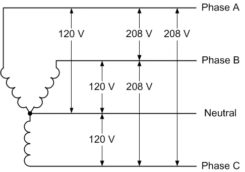

FlasherZ Well-known member Joined Mar 10, 2022 Threads 9 Messages 915 Reaction score 1,025 Location St. Louis Metro Vehicles F-150 Lightning, Tesla Model X, F250 SD diesel 6.0 Jul 15, 2022 #17 VTbuckeye said: Fcsp will work with 208. From the back of the manual. Click to expand... Perfect, I was going off the spec sheet. Thank you for that. (I had dropped an e-mail to SunRun and was waiting to hear back.) So the final answer is - yes, you'll be fine using the 208V of a 208Y120 3-phase system.
jefro Well-known member Joined Oct 28, 2021 Threads 3 Messages 699 Reaction score 231 Location Texas Vehicles F150, Corvette, Bolt EV, Jul 15, 2022 #18 All this stuff is built for world use. Doubt you need to care what phase angle is ahead of the other. You balance loads across the building or area. Sponsored
