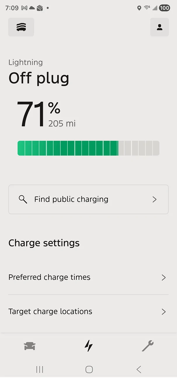

Update : Murphy's Law is still undefeated.:sadface:
I tried charging on Ford charger yesterday morning, and sure enough it charged.
The weird / frustrating thing is the the app still shows " off plug ".
I uninstalled / reinstalled app, thinking / hoping that'd clear the message, it didn't .
I do know the R & R of the app did reset some things because I did have to re-pair my phone to the truck to use as key.
Ford F-150 Lightning " off plug " message ?? Screenshot_20260123-070908
240
17,035
19,401
Have you tried pulling down from the top of the phones screen to cause a Ford App status update, the app does need to be manually triggered on occasion to show the changed conditions, this is common after the truck and app have been dormant for a few minutes to hours.
Yes & it's weird , the app " homepage " refreshes when doing that , but the " charging page " does not. And if I'm recalling correctly , it never did. It's definitely not now , I just tried it again.
Another weird thing is it is updating other parts of the page. The " charging history " , for instance , shows my charge from yesterday.
The off-plug message comes from the truck but only when it does not sense the connection.
But if it didn't sense the connection it should not charge the truck.
Seems like a glitch in the App software.
Don't absolutely need the app to charge with the FCSP, I did it for 6 plus months when the FCSP setup app would not complete, then after an update to the app or the FCSP, it finally did complete.
So I guess if it charges the truck, ignore the app "off plug" message, and move on?
